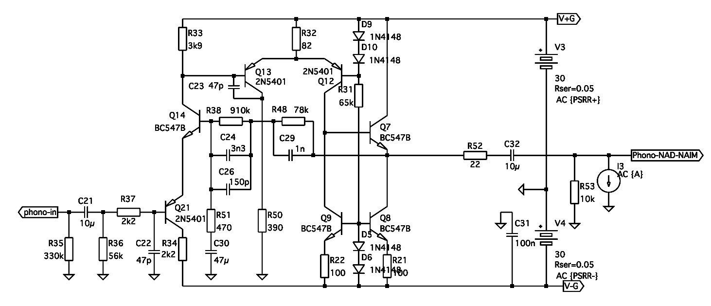

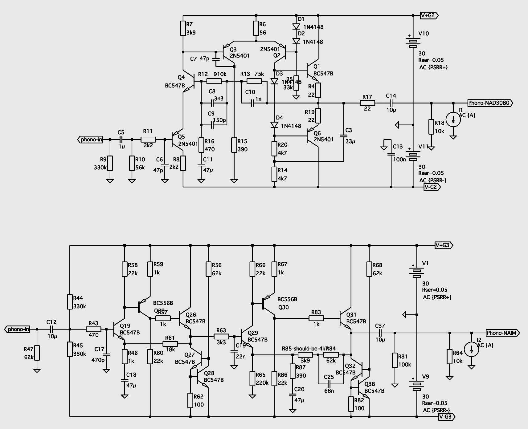

A tale of two phono amps...
I simulated the NAIM '322' phono - looks just fine (perhaps some tweaks to the RIAA values) and the Zout is good as-is for this project. Along with the gain stage I have using this phono would make it an all-NAIM design :)
I also went back and revisited the NAD3020. I 'upgraded' it by transplanting the output stage from the NAD3080 posted earlier. I retained the high-impedance feedback network for now (potentially, the NAD3080 lower impedance feedback network has lower noise). It also looks just fine, in fact it looks very nice, also with low Zout. It's an all-active design unlike the NAIM but is also a fair bit simpler.
eeny meeny miny moe.....

Putting a bit of the NAIM phono output stage onto the NAD3020. A kind of mix, which keeps it single ended and no bootstrap hanging off the output like the NAD3080. Of course, Zout is just fine but it's all active, no passive 75us for Nigel. Nevertheless, I think I like this one :deer:

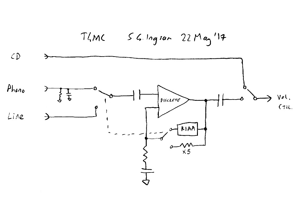

What if I was lazy (it'a already been suggested) :cool: and instead of making two separate amplifiers I just make one with switchable gain covering High Gain (with RIAA correction) and Low Gain (for a source that needs a 5x boost). A 'modern' CD/DAC source would need no gain. It's quite appealing I have to say.
Thoughts ?

If you look into some history you will find that Clive Sinclair did exactly that in the mid sixties, and I remember them working well.

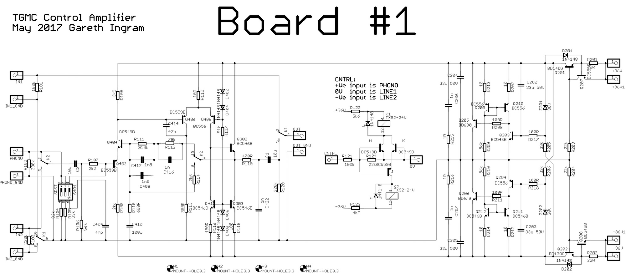

Clive was a clever chap, but he was probably trying to save money with this combo approach. I translated the rough sketch into Eagle to see how it looks. Right now, it looks super simple although right one of the input grounds has to be permanently connected to the circuit signal ground until I add another relay to allow full isolation of all input grounds and avoid there always being two signal grounds connected together.
Why do preamps have a phono-amp AND a line-amp? Why not just one w/ switched (gain & FB network)?
Because keeping them separate provides the greatest flexibility, Clive's approach is limited as we can see. Some folk like to have the line-amp after the volume control which isn't feasible with this consolidated approach. And it keeps switches out of the 'signal' in your delicate phono amp where impedances are high (there are options to reduce the feedback loop impedance considerably from what I've shown). Sometimes the phono amp and line-amp have other performance requirements that come into conflict depending on the design choices being made but in this case there are no obvious conflicts.
