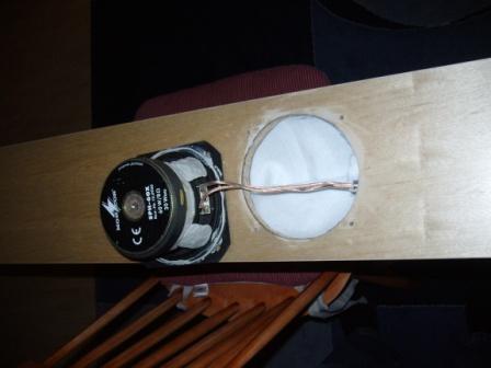

Terry Cain's BIB -why does it work and does anyone have those Fostex Craft Handbooks?
...filter fitted in box
So if I understand you right, the driver position can be set at 1/3 of the lenght as a starter. I'm thinking of opening up a larger space on my existing BIB's in order to change position of driver. I will make a couple of longer additional baffles to see if I get any changes sound wise.
After a longer listening session yesterday I concluded that the damping I made was too excessive. For sure reflection thru the cone disappeared BUT, it took away some of the low mids too. Result was cleaner sounding but colder and dryer (read it as more of a monitor sound in lack of verbal knowledge) Voices came across as strained and made my ears bleed after a while.
Funny thing is that my wife immediatly asked what I've done. It sounded worse according to her!!!
Therefore I losened the filter beneath the driver so that it can breathe a little more. I couldn't listen to them at higher levels as it was quite late, so further impressions will come.
Don't know but I have a feeling that the mids, coming out of the mouth, maybe it's not so bad with small drivers. Shure it makes the sound stage to big, but it adds a varm tone that I maybe can live with. We'll see....
Cheers
Nominally the ideal is at approximately 1/3rd acoustic (not the same as the physical) length of the system. Naturally, that would put the driver on the floor somewhere, so we choose the best compromise we can for driver positioning.
By memory, you have the point above the driver stuffed, a nice, thick layer of damping material over the entire internal base, a layer of damping up the rear of the internal baffle, and some material right behind the driver, right? I should have thought that was plenty, but your boxes are a little over-sized too, correct? So it'll need some more, though that would usually apply more to the LF than the mids. Get some grill-cloth across the vent & build thickness up until it kills the mids escaping. Prevents dust ingress too.
Correct! This is what I had before. Now the one inch BAF behind driver is replaced with the filters from earlier posts + a more dense damping in the closed end. This I have to listen more to, before judging.
