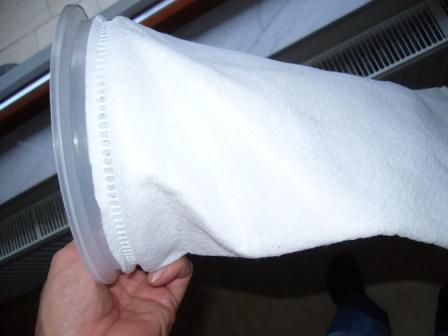

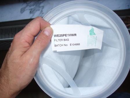

Finally I have made an effort to fix the highs coming out of the mouths on my Monacor BIB's. I think it was GM that posted that a grill cloth could be put behind the driver. One day, at work when I was filtering a new lacquer, it struck me that these filters would perhaps be ideal for this. They're made of rough polyester in the inside and outside is a more reflecting material. So to say a one way path through filter. It is not possible to filter back way in these.
They are available from 25 to 250 micron. Maybe there's higher grades but don't think it's no use to go higher than 50 or 75 micron.
First test I put different filters in front of the speakers and concluded that I would try the 25 micron. This filter grade provided the highest attenuation of mids and highs.

...as you can see(I hope) the filter is tube shaped. I just cut them at the bottom and attached it with a staple gun on the back of the front baffle. I had a one inch thick BAF wadding behind driver and this went out when trying this wrap-around-driver damping.
I've not been able to listen at higher volumes yet but I think it's better for sure. Voices are not so "fat/thick" anymore.
The first time I listened to them was in a simular room and when I moved them to an office with acoustic tiles, this phenomen disappeared. I got the same difference with the wrap-around damping in my living room. Seems to be a winner for now, however I will spare my final judgement for later. It's too easy to be excited of some changes in sound that may not be so bearable in the long run.

Good news Peter! I know that's been a thorn in your side for a while, so I'm very glad you've got it sorted out now
Hi Scott!
It has not been much of an issue since it occurs when playing loud. It's not so often I can do that with kids, wife and neighbors around
It seems that treble is down a decibel or something. Could it be that reflections thru the cones are gone?
Cheers
Hi Scott!
Cheers
Very likely that's a major part of it. Reflections back through the cone are a pain, as the also cause problems in the time domain. Plus, the HF is more easily absorbed with damping higher up the line, near the driver, so it should prevent some leakage along the horn. If you've got a layer of damping on the base of the cabinet, that should do the trick nicely, filtering off most of the unwanted higher frequencies, but preserving the LF we want.
