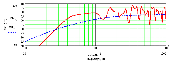

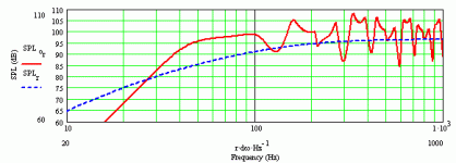

Well, I did say they'd be a little large... The line length is not exactly length /2, but that gets you close enough, though there's an excellent spreadsheet available on the thread & elsewhere that makes a good partner to Greg's that helps you calc the exact cabinet height for a given line length.
Chris -funny you should mention an Ariel BIB. I did a cabinet for these a while back, but I can't find it anymore, so I re-ran the sim:
Line length 112in
Zdriver 24.5in
Sm=64.0625in^2
Line length 112in
Zdriver 24.5in
Sm=64.0625in^2
