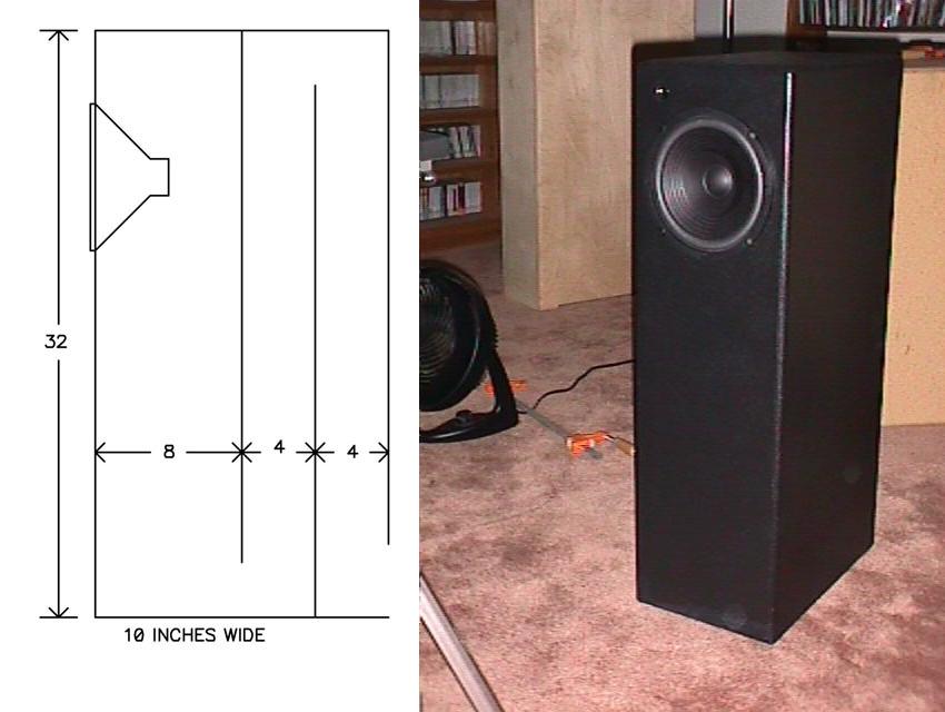

Thanks for looking at them! Too bad, though. I wonder if something like (MJK or Nelson Pass)'s Pioneer box would work for them? I've searched the web over for mention of them, but, can't find them, here's the pictures associated with them, maybe they'll jog someone's memory:

renfrow said:Thanks for looking at them! Too bad, though. I wonder if something like (MJK or Nelson Pass)'s Pioneer box would work for them?
Greets!
You're welcome!

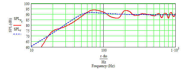

Didn't know MJK designed one, but NP's pipe is way too small acoustically since the 1286 wants to 'feel' a ~48.15 ft^3/19.4 Hz load! At the very least it appears to 'want' ~12.72 ft^3/37.5 Hz, so I simmed it in his pipe to see how bad it would be, and while the sim doesn't look as bad as I assumed, it can't show how 'choked' it's likely to sound, but a tweeter can offset it somewhat. Only one way to know for sure though:
GM
GM said:Greets!
You're welcome!
GM
<wince> 3ft x 4ft x 4ft cabinets would be a little unwieldy </wince>
I'd forgotten who had designed that speaker, and couldn't remember closer than that I think I'll get the wood for a pair and build it as is, and plug each of the 8in speakers into them to see how they sound. If nothing less I can still buy a pair of the pioneer's and plug them into it! I've got two sheets of 4ft x 4ft wafer board that I've been plugging them into, in the basement, and they're not really ready for public listening
Thanks!
Tom.

Greets!
It has a stiff suspension and nominally rated at 4 ohms, so don't expect much out of it down low beyond what the sim shows if the amp isn't rated for at least 200 W/4 ohms.
