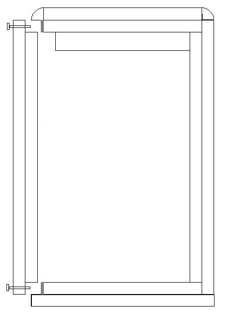

I'm drawing on paper my BIB and as I can't find around here some Birch plywood bigger than 60"x60" and the speakers will be +/- 65" tall, I'll be using a sandwich of two different woods : okumé plywood and pear or exotic blockboard wood.
I'd like to have one "D" side not glued (instead of the bottom base) for easy tweaking or damping material filling... Anyone has experienced this? Any contraindications?

McFaBs said:A brief question:
Greets!
The major drawback is that it's hard to get a good temporary seal, so the finished product may not perform the same as your tediously found optimum.
GM
GM said:
Greets!
GM
Hi GM
I see.... What if I place some sealing foam tape or similar and some dowel screws (like in the front or rear baffle of commercial speakers) until I reach the final tuning? Do you think would be enough?
Thanks. Fab.
Greets!
I never had much luck with the typical foam insulating/sealing tapes found at hardware stores, etc., so used what's referred to here as Nema 4 (hazardous location) industrial neoprene door gasketing sold here at industrial electrical supply distributors for mounting large drivers, baffle boards, rear access panels, etc.. I'm sure you'll have an equivalent locally. Not cheap here and I doubt it in Italy either, but it seals really well and is rated for thousands of door closings in very toxic fumes/dusty environments, so no worries about 'crushing', rotting, etc., over the decades in a typical HIFI app. Indeed, the baffle gasketing on my old subs that I built in '69 is still relatively soft/pliable and seals well after removing/installing them twice/yr to rotate the drivers. The main thing is to not squeeze it too flat.
That said, there's been considerable materials advancements since I tried the various 'consumer' foams, so maybe you can get by using cheaper closed cell foam gasketing now, so as always YMMV.
GM
