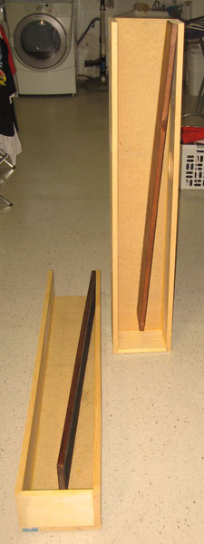

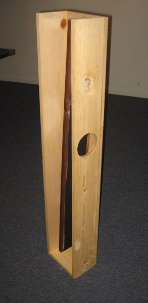

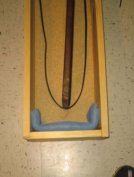

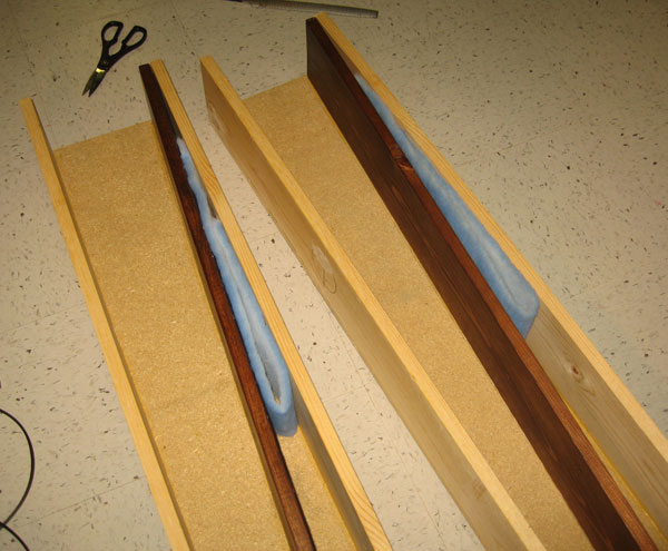

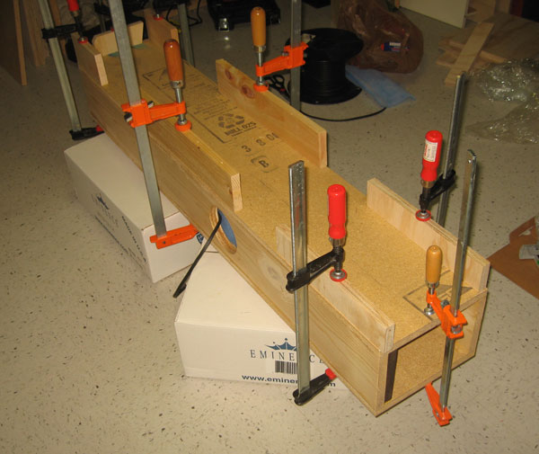

Excited... started another BIB this weekend. I will be using the Fostex 127e that's been pretty much unused in this project.
http://www.zillaaudio.com/fostex-127e-slotted-box.htm
The above project convinced me this driver does not require a tweeter. I have also been considering a stand of some kind to try floorloading. I'm curious how different this BIB will sound upside down.
My new BIBs are coming along nicely... sanded one last night and it's looking good. They really have a very small footprint! Maybe this weekend i'll get some stain on them.

The BIB i built really suits the 126e but i wanted to try a smaller BIB and don't expect a world of difference. I'm curious how the much less expensive Dayton will perform.
Also, for some strange reason, i feel compelled to place a super tweeter on the rear. I will drill out another set of holes this weekend before staining.
The outside dims are approx 50" x 7" x 12"... it's a rounded measurement that worked with standard sized lumber (5.5" wide pine) to make things easier to assemble. I will play with flipping it over for floor loading and design a stand of sorts... or use something like this flipped over:
http://www.mandygregory.com/Classpics/MVC-013S.JPG
I think this size BIB will work with other 4" to 5" drivers including the 4" TB bamboo (that i also have) and the 4.5" Fostex 126e.

In this particular case there is a problem. Remember, the BIB has an inner baffle. Already with my chosen dims the back of the driver magnet is obstructed by it. I will have to add an additional baffle in order to bring the driver forward... I've already cut the wood.
I must say, even my larger BIBs using 6.5" Fostex 165k drivers don't reach the lower bass like the H-frames using 15" drivers. So this idea of a BIB being too small is odd to me... The bass will either load the room better with the opening at the top or the bottom. Regardless, i believe a sub will be needed for deeper bass. In corners they may provide sufficient bass but nothing like the H-frames. Amazing as the BIB is for maximizing a small drivers (say 4" to 6.5") ability to achieve bass, I view them as excellent compromises for expanding a given full range drivers response (but not replacing dedicated sub woofers for ultimate bass performance), with a small footprint, larger imaging than more typical cabinets and a fuller, more dynamic sound.
