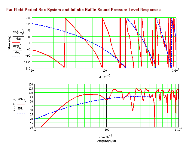

Well, Greg made some optimum suggestions quite a few pages back which were much better than my early ideas. However, here's a further thought -I actiually like the look of this one quite a bit. It doesn't quite match the response curve of TC's original, but it keeps the cabinet size relatively managable (that's why, if anyone's wondering, the response of the suggested dims I made for the Monacor SP-200X 8in driver on Jeff's pages look different to most of the others -you'd get better performance out of a larger cabinet, but I wanted to keep the size down. Also, I wondered if a monster enclosure would be worth the effort for a cheap driver, good though I'm sure it is.)
200in^2 terminus. 150.5in line length. Driver 30.1in from sealed end. Me, I'd do 10in wide x 20in deep (internal). Paint it satin black, have a bit of a polish / varnish, and hang a model of Discovery from 2001: A Space Odyssey between them. OK, so the proportions aren't quite 1x4x9...
Regards
Scott

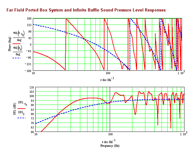

Couldn't resist it. Just for fun, the Hemp FR8 Monolith, inspired by Stanley Kubrick's & Arthur C. Clarke's 2001: A Space Odyssey.
Flip the enclosure sideways, so it's wider than it is deep.
1x4x9 external dimensions (excluding the plinth).
8in deep. 32in wide. 72in tall. Driver 28.75in from the internal sealed end. Terminate the internal baffle 14.875in from the internal base, and the internal left and right side walls. 1/2 space response is very similar to the one above, as you can see. Strauss is advised to run the drivers in.
Please note however, it must either be painted satin-black, then suitably polished, to tie in with the film, or made of transparent acrylic, to tie in with the book. Also -no rounding off of the edges! They must stay sharp. Or I'll send the boys round ;)
Yours in good humour
Scott
