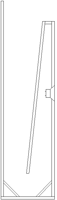

In my ignorance of TQWP's, a few ideas come to mind:
1) Everyone with an understanding of these designs seems to agree that having the closed end of the pipe come to a sharp point is a bad idea. How about truncating it? It complicates the very simple construction of the BIB slightly, but some people seem willing to put a whole lot of effort into the things, so this doesn't seem like too much extra work.
2) Corner boards in the fold. Some have commented that they doubt they'll make much difference. Other's that have experimented with other folded pipes testify that they do make a difference. Even without a deep understanding of these particular designs, it makes sense that those sharp corners and flat bottom can only cause unwanted anomalies.
I once had the opportunity to listen to two TQWP's that were very similar except that one was folded and one was not. The unfolded version was the winner without doubt; it presented much more clear sound while the folded one got a little muddy sometimes. I doubt I would have noticed it if I didn't A/B it with the unfolded version. The difference might have been due to a lot of things, but I have to think that part of it was because of the fold. Reducing the impact of the fold seems like a worthwhile way to spend some effort.
3) The mouth opening. It was suggested early in this thread that sloping the opening back (pointing towards the back wall) would increase the mouth area and possibly bring some benefit. I have to think that if the speaker is positioned tight against the room wall, then we would want to slope the opening towards the front. We're not looking to increase the reflections off the wall, but to use the wall to increase the effective mouth area.

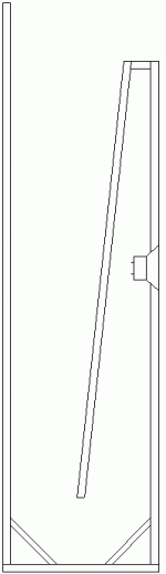

I've attached a diagram giving an idea of how I think these changes might be included.

Some interesting points well raised. I'd classify them as being closer to horns though than TQWTs -see the intro. Jeff, the pages look fantastic BTW -a massive vote of thanks on behalf of us all for designing and hosting them.
Hmm. So=0 is often seen to be automatically bad. I was guilty of that assumption too until a few months ago when Greg opened my eyes somewhat. It's not. In fact, it can have some real advantages. Trouble is, it's a right pain to design an So=0 design properly to get the benefits without getting clobbered by the problems it can have unless you've very careful. The trunkated types are easier. A trunkated BIB could be interesting, though the expansion is a little different. I've never felt the need, as I've been happy with my So=0 types but it might be worth looking into. Greg, Martin, guys -any thoughts?
Re the corner boards, I'm not sure. I tried them in one project and didn't hear any benefit, or measure any difference, but that's not to say you wouldn't of course. Then again, bass frequencies aren't likely to be that fussy anyway, but there's certainly room for experiment -I was using some spectacualrly cheap Electrovision drivers at the time that were hardly hifi quality, which probably rendered the experiment moot.
Peter -glad they're going together soon. Enjoy! You're not going to loose out on anything with the very fractionally shorter line-length BTW. Everything else is effectively the same, so there's very little in it. That's just me having some fun trying to squeeze the last drop of low-end out of the thing whilst not causing it to bottom out.

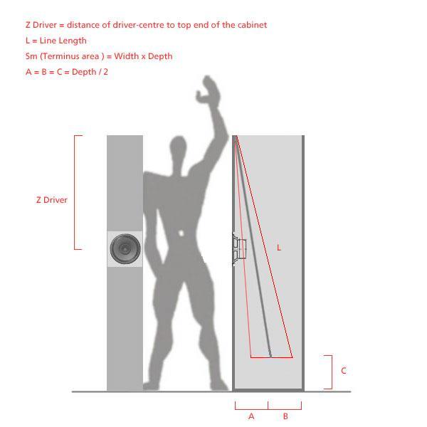

fred76 said:Here's another version of your to scale image that I 'edited'. This time making the "end" of Line more obvious for newbies. What do you think Godzilla?
Is this the right way to determine line length? I would have drawn a line smack through the middle of the air space. Where could I find more detailed information about this?
Randy
Greets!
To find the theoretical acoustic path of a folded pipe you find the center of the cross sectional area (CSA) at all points along the line, so down the middle for straight constant area sections and the SQRT of the inside radius times the outside radius for curved bends. For the BIB's corners, calcing the diagonal CSA's apparent 'curved' center from the corner to the end of the baffle board is close enough.
Note that the BW below a corner's passband is acoustically large enough that sharp corners have no audible impact on the pipe's performance, which in round numbers is a frequency = < ~13560" (34442.4 cm)/WL/pi (the WL's diameter), which is often (mis) quoted as < 1/3 WL in folded design discussions on the various forums, so the smoother and larger the fold's radius, the greater its passband, ergo for long pathlengths in back loaded designs, they are to be avoided like the plague since the terminus's output will be increasingly out of phase (time) with increasing frequency. IOW, sharp, abrupt folds act as acoustic low pass filters, attenuating unwanted HF output from exiting the terminus.
GM
GM

Greets!
1) Everyone?! I know lots of pro and well regarded DIY horn designers that feel the corollary is true, but WTFDTK?
2), 3) I addressed these in previous posts.
A properly designed/built folded back loaded pipe sounds no different than its straight version. You can't just fold something up willy-nilly and expect optimum performance unless it has a very narrow BW.
Anyway, so far I haven't bothered to think in terms of improving the BIB's design beyond adapting it to dissimilar drivers, which for the most part has been limited to ~mimicking TC's half space simmed FR and impedance plots. The other ones I've done really shouldn't be a part of this thread and why I suggested a separate one along with a separate webpage.
With a depressingly short 'short term' memory, I don't recall what I posted that led you to this conclusion, but I certainly didn't mean to imply that it's any harder to design them than a truncated version. The only good acoustically related reason that comes to mind at the moment to use a truncated one is that it allows the driver to be optimally placed closer to the horn's throat for the smoothest response, ergo a high compression ratio (CR) TQWT is required to optimally place the driver at the closed end.
Remember, the top of a closed pipe is its acoustic throat, ergo its area defines its HF corner frequency, or 'Flh' in horn design-speak, so a pointed terminus has a theoretically infinite BW/highest potential gain and a maxed out end loaded TQWT has a BW centered at DC/no potential gain. The theoretically infinite number of variations in-between these two AFAIK unattainable extremes are for tailoring it to best meet the intended app's performance requirements.
Bottom line, without ~accurate measurements using the same driver BIB/electronics in a variety of different shaped/size rooms and locations within said rooms, trying to design audibly more accurate versions (as opposed to 'different', or in someone's opinion) is pretty much an exercise in futility IMO so 'color' me done' on this subject until a lot more hard data is available.
As always though, YMMV.
GM

fred76 said:Hi,
I hope you won't mind Lovechild... Here's another version of your to scale image that I 'edited'. This time making the "end" of Line more obvious for newbies. What do you think Godzilla?
Hi
no problem fred, I'm seeing this as an "open source" project, so anything that helps is apreciated - only, I'm not sure if that LINE is correct as you did it?!!?
best, LC
Hi
GM, would this be the correct line?
GM, I'm glad to read in your last postings, that there's no need to smoothen the corners, nor the pointed terminus. Too me, the facination and the beauty of the BIB design lies in it's simplicity!!! Six rectagular pieces of wood and one driver - no schnick schnack - plus a clever use of the environment (corner and celling). You hardly find something as beautifull these days, be it in design or in engineering.
best, LC
best, LC

It was indeed wrong .... I shouldn't have messed with it. It only showed the length of the diagonal fold from inside the throat to the outside 'pointy' end, but not the "flow" of the Line... Where the Line starts as air pressure from the Throat -> down to the Internal Baffle Center... -> upwards to end of Line where the Mouth is.
So for the Supra 215RTF example... Essentially a Hummer BiB.
L = 113"
So = 24.56" from the pointy top
Sm = 544"^2
20" (W) x 27.2" (D), then BiB height would be 70.1"
L = 113"
Sm = 544"^2
That BiB height and Depth has a line length of 133.4 if I have read the diagram correctly. You have ignored the half circle at the bottom. It is 21.4 inches.
I get a calculated height of 58.9 inches.
Sean
I just made a spreadsheet to check myself. For small depths and long line lengths dividing the line length by 2 generates a number slightly shorter than it should be. For shorter line lengths or larger depths error can accrue quickly with rough estimates.
The spreadsheet is simple. Input line length, So, Sm and Depth. It outputs Width and Height and driver Height. Please check for errors as it is late.
Note that with the FE-166 that range of all useable values only alters height by less than an inch. With the Supra 215 the Height varies about 2 inches over all reasonable values.
Sean
Sean
I just copied what GM gave me on Post #325:
http://www.diyaudio.com/forums/showthread.php?postid=892705#post892705
And the Sm on Post #323
I got 13.6" for the internal baffle center.
