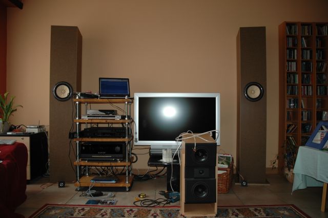

FE208ESigma BIB
Not being able to decide whether to build a FF165K or FE168ESigma BIB, I dismantled my Nagaoke D3II.1 BLH and decided to build a "test"-BIB for my FE208ESigmae from particle board. If I like them a lot, I might rebuild them in a better material.
First impression : incredible bass from these things, WAY better than the smallish BLH (smallish in comparison, that is).
As expected, I couldn't get by without a supertweeter though. Put them on the floor for the moment. This also puts them somewhat offaxis, which I prefer.
The midband seems comparable to the one from the D3II.1 Maybe it would be worth to try to put the 208s on a suprabaffle.
Concerning acceptability : my better half thinks almost everything is acceptable in our living room, except for the 1 m^2 OBs I used for breaking in the 208s a year ago. (see FE208ESigma break-in)
