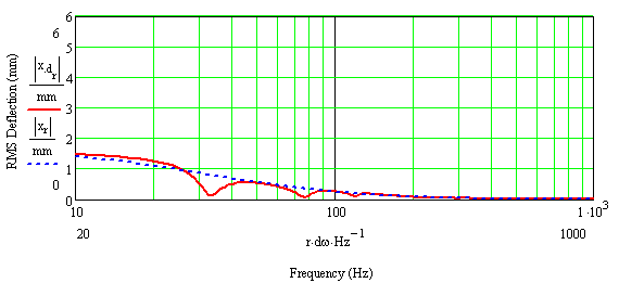

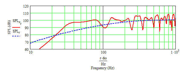

Concerning BIB's , I've read that the response could be smoother if the drivers location is @ about 40% of line length , but that a different percentage is typically used to raise the driver to a more appropriate ear level.
Is this true, and if so , which driver location is the graph based on ?
How much does the "proper" location smooth the response ?
Thanks again.........................Blake

Hmm, it's probably optimum for some alignments in some rooms, but as a general statement it doesn't work for me since experience has taught me that it typically needs to be somewhat lower with a simple pipe horn. The trade-off though is that you raise F3 considerably if you don't increase its length and I assume some/all of the 'OB' like presentation some experience will disappear as a consequence (I never built a BIB per se), so no 'free lunch' here.
Anyway, it's based on the BIB's (L*0.217), which happens to put it near/at face level.
GM
GM said:From:
» FullRangeDriver Forum
» Can someone give me some BIB modeling help?
L = 138"
Sm = ~330"^2 (~15.25" w x 21.625" d)
zdriver = 30"
a/b/c = ~10.812"
GM

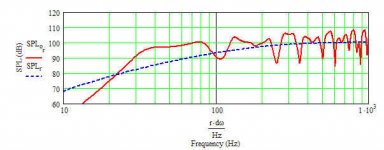

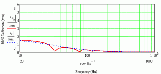

hi GM
if it is not too much trouble, could you model for coral beta 8?
below are averaged measurements of 8 drivers that i found somewhere online in an excel sheet for the beta 8.
109.97 Zmax
7.89 Re
56.57 Fs
0.28 Qts
3.88 Qms
0.30 Qes
93.41 Vas
7.09 Mms
1.15 Cms
8.10 BL
99.19 Spl
5.32 no
28.43 r10K
9.86 r1k
thanks!

GM said:Greets!
Well, as fate would have it, the same one as the Eminence Delta Pro 12A looks good:
L = 138"
zdriver = 30"
a/b/c = ~10.812"
GM
