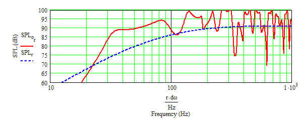

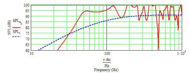

OK, let's use our ~simple design routine to see how it fares:
Fs = 70 Hz
Vas = 0.29 ft^3
Qts = 0.445
L = 13464.54/2/70 = 96.175"
folded height = 96.175"/2 = 48.09"
Vb = 20*0.29*0.445^1.25 = 2.10804 ft^3
Sm = 2.10804*1728/96.175 = 75.751"^2
depth = SQRT((75.751*SQRT(2)) = 10.35"
width = 75.751/10.35 = 7.319"
zdriver = 96.175*0.217 = 20.87"
a-b-c = 10.35/2 = 5.175"
All dims i.d. and approximate.
A little under-damped, but this doesn't take into account that the net Vb will be somewhat lower, so works for me. Not too shabby IMO for what is basically a big tweeter and should do OK down to 40 Hz if up against a wall. Biggest drawback I see is the low driver position, so adding a mass loaded cavity to space it up seems a good plan.

Thanks, missed this in my search. Anyway, I did the design primarily to get the routine documented in the thread and it's a good one for reasonable power handling, but if what you see in this sim is loud enough plus any room/boundary gain and a second speaker, then I agree, build the original BIB:
GM
