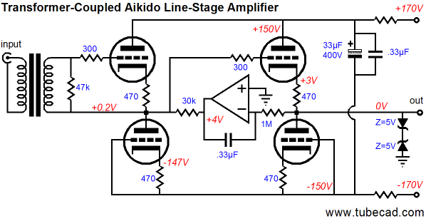

yes. i wish to build a tube driven hybrid amp. i am considering aikido topology for front end. aikido, perhaps, topology is a quantum leap in tube design. why not try something new. However, I have simulated a dc coupled tube hybrdid op-amp for this purpose. I had krill in my mind while I did the concept. It's nothing new, but gives some sense of creation.

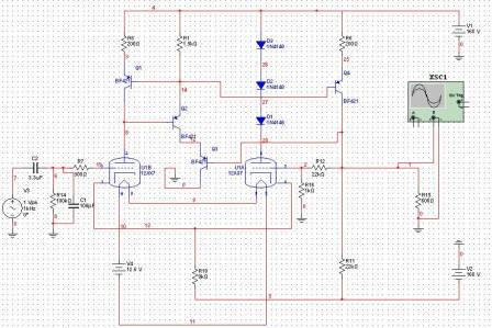

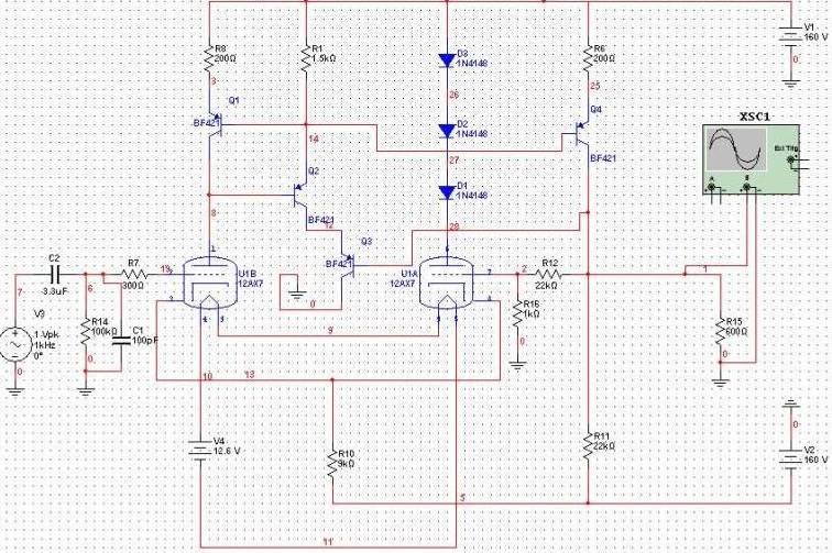

here is my initial idea for hybrid op amp. bottom resistors will be replaced by CCS made of IXCY HV regs. I am learning spice simulation since begining of this month. so there might be some error. I mean it is not tested on work bench.
