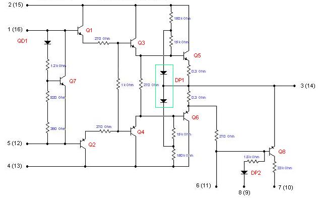

here is my initial idea for hybrid op amp. bottom resistors will be replaced by CCS made of IXCY HV regs. I am learning spice simulation since begining of this month. so there might be some error. I mean it is not tested on work bench.
