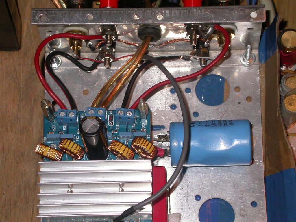

I finally got around to doing some of the mods x did in the beginning of this thread. I spent a few hours listening to the amp stock yesterday, then popped in the Panasonic OSCON 330uF 25V SEPF caps and a Panasonic 560uF 35V FM cap. Hooked it back up and listened for a bit longer.
Gear:
Onkyo C-7030 cd player
First Watt B1 clone
tda7492 amp
Fostex FE126En's in BK12 cabinets
In stock form I thought the tda7492 was not that great, the hf was harsh, and a bit distorted sounding. The lf seemed a little thin, and slow'ish maybe.
Post mods, the hf is improved some, though still not quite there for me. The low end is much improved, much more full and authoritative.
I haven't done the snubber mod, as I don't think I have what's needed on hand.
Looking for suggestions as to what to try next, if it's the snubber mod, I'll get the parts and give it a whirl.
I'm also going to put it into a real case at some point, with some decent rca's and binding posts.
Thanks!

Pcgab, thanks for trying my mods! I looked at the photo and remarked it looks just like my amp
I have moved on to the 7498 which has much better bass stock form. I don't change anything on the TDA7498 (blue board with black heat sink and pot). That board had mislabeled outputs but get past that and it's good.
The bootstrap snubber is needed on this amp to get the harshness down. 330pF and 10ohm resistor.

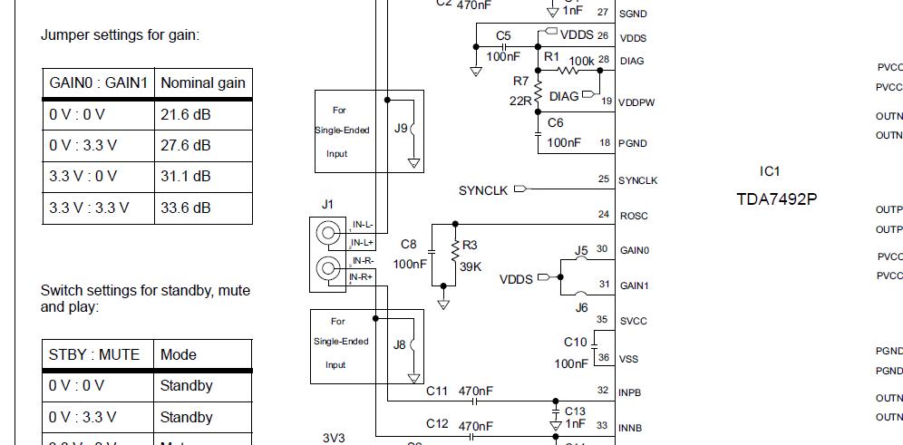

Hi to all
I want to do the snubber mod on TDA 7492 on blue bord. Can I use a styroflex cap instead of a ceramic cap (330 pf ) . ( I have some styroflex but no ceramic caps )
I already changed the inductors (33uH for 8 ohm speakers ) and changed the input cap to wima mkp 10 bypassed with 0,33 MKT (to soften the highs ) and changed the
elco for 2200 fm Panasonic .
Sure, the polystyrene caps can work as snubber caps as long as voltage rating is sufficient.
Look at Figure 28: break the traces for pins 30 & 31 (open) to get lowest gain setting of 21.6dB, leave 31 connected to Vdd (3.3v) and break pin 30 to get 27.6dB, leave pin 30 connected to Vdd and break pin 31 t0 get 31.1dB gain. Both connected is 33.6dB.
http://www2.st.com/content/ccc/reso...df/jcr:content/translations/en.CD00205863.pdf
Thanks for your reply,
A took the pin description as point of reference and counted 6 en 7 places down to gain 1 (31 ) and gain 0 (30) and then followed the traces to cut as far as possible from the chip .(I already spoiled another one)
On the Feixiang td 7492 blue board I could cut traces near R8 ((gain 1) and R28 (gain 0 ) but only with the help of a stereo microscope
Best setting so far 31db gain . (restored connection pin 30 and left 31 open )
