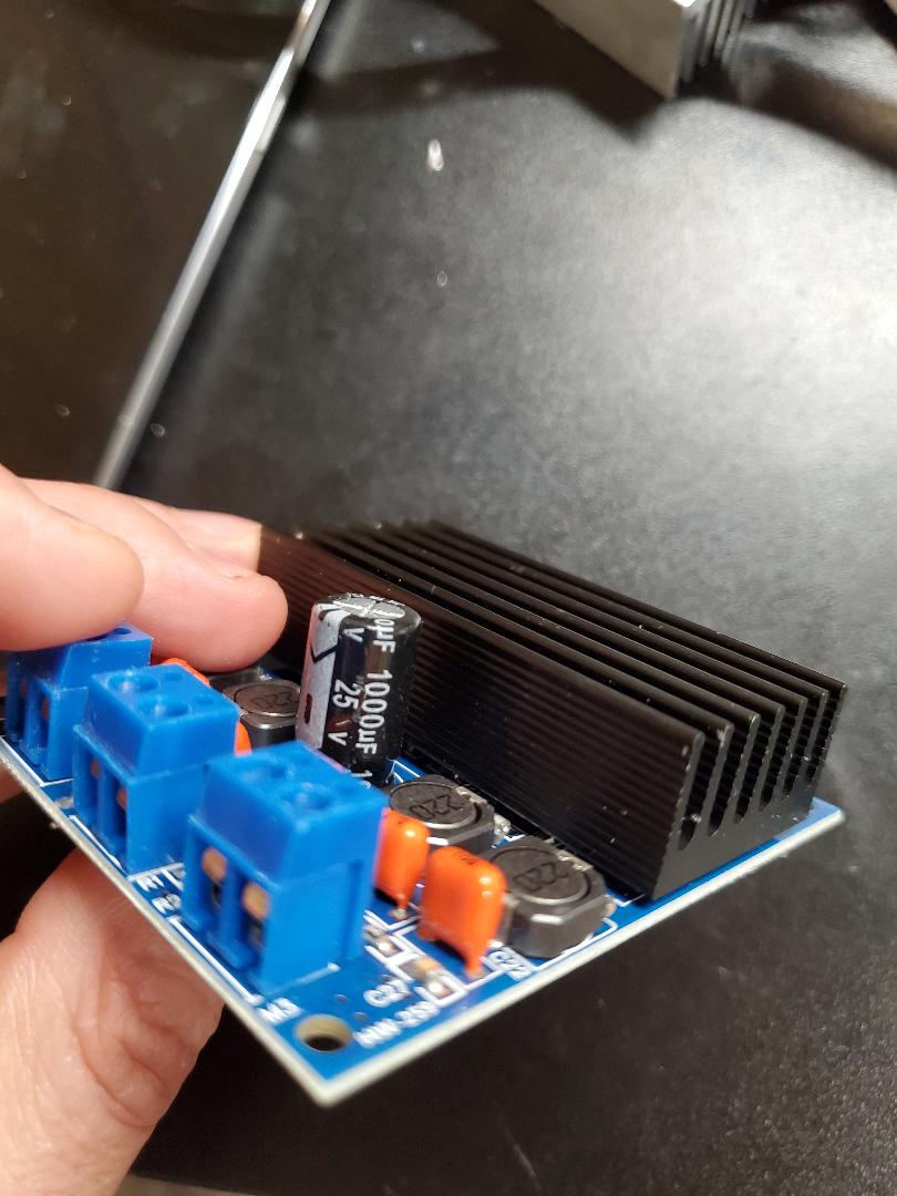

I opened a freshly arrived package with a cheap 7492 board and found that it did not match the sellers description and came with a 25V 1000uF cap when it was supposed to be a 35v. I can change it but I thought it would be good to point out so that others don't set theirs to the 26v without looking and blow it up.
The 7492 has very small output inductors compared to the others. Those probably have a current rating of less than 1.5 amps. I see specs on some CDR74 (7mmx4mm) inductors at 1.25 to 1.84amps I will have to see if I can heat them up on the bench.

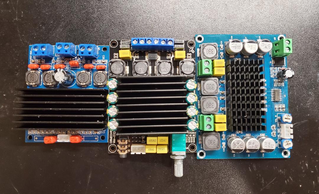

Here is a comparison of the 7492, 7498, and xh-m543(single chip stereo tpa3116).
Note the CHR127 (12x7) inductors on the 7498 and 3116 boards. Those should handle over 3 amps (3 amps for the 33uH, 3.6amps for the 22uH and over 5 for a 10uH due to larger wire on the lower inductor parts) I am looking at upgrading these to CHR129's in the future which can handle about 40% more current than the 12x7s.
I also ordered a silver heatsink version of the 7492 board that has different caps (polypropylene instead of polyester). I haven't ordered the single cap 7498 board shown above yet. I may still do that, the quality of this board with the many capacitors isn't that great. It is a pretty messy solder job, etc.

I suggest against buying the above 7492 board. I replaced the capacitor and put it on the bench. I really only got about 19-20w of clean power before clipping into 8 ohms on each of the two boards that I have with the black heatsink and orange (polyester?) caps .. They also had very loud screaming inductors as the power increased. IIRC it was evident at over 10-15W.
I also purchased another version of essentially the same board with a silver heatsink and square (polypropylene?) caps. I got it on aliexpress and it looks like it is the same one that partsexpress has.
I was able to get 25W at 24V from the second board with less inductor screaming. So the components do seem to make a big difference. Note that this board did have its capacitor tops dented during shipping and I have not replaced them yet. I will have to see if I can get the full 30w that JohnAudioTech got un his youtube review once I do that.
I also noted that these generated quite a bit more heat than the tpa3116 boards. The distortion is also nastier on the tda7492 and tda7498 where it breaks before clipping and doesn't clip cleanly like the tpa3116 chip does.
