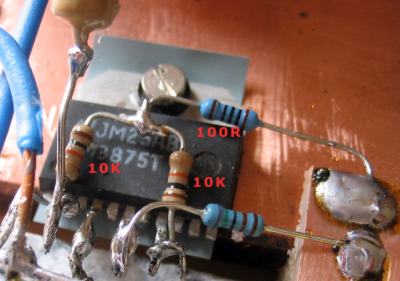

A few tips for a P2P layout.
1. You can remove unwanted pins by bending them a few times. The pins break cleanly where they exit the case.
2. Use smaller resistors for the feedback. For your T-net layout you could even use MRS16 resistors, 3.6 mm 400 mW.
3. Create a small Audio GND point by connecting the input returns and feedback return together.
4. Create a Power GND point close to the output pin. Connect the output return, bypass caps and PSU 0V to this point. Connect a short wire between the Audio GND and the Power GND.
5. Connect the bypass cap supply leads directly to the chip pins.
6. It is very handy to loop the component leads around the chip pins so that they are fixed before soldering.
7. Use flexible wire to prevent stressing the chip pins.
NB: points 3, 4, and 5 in the preceding post have been covered in the build text for some time. although stated slightly differently, if the build text is followed 3, 4, and 5 will be among the results.
the other points can be followed without causing any issues with the rest of the build instructions and are fine suggestions.
