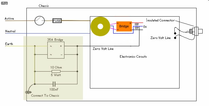

and lest we forget safety:
from: http://www.decdun.me.uk/gc/groundlift3.jpg
