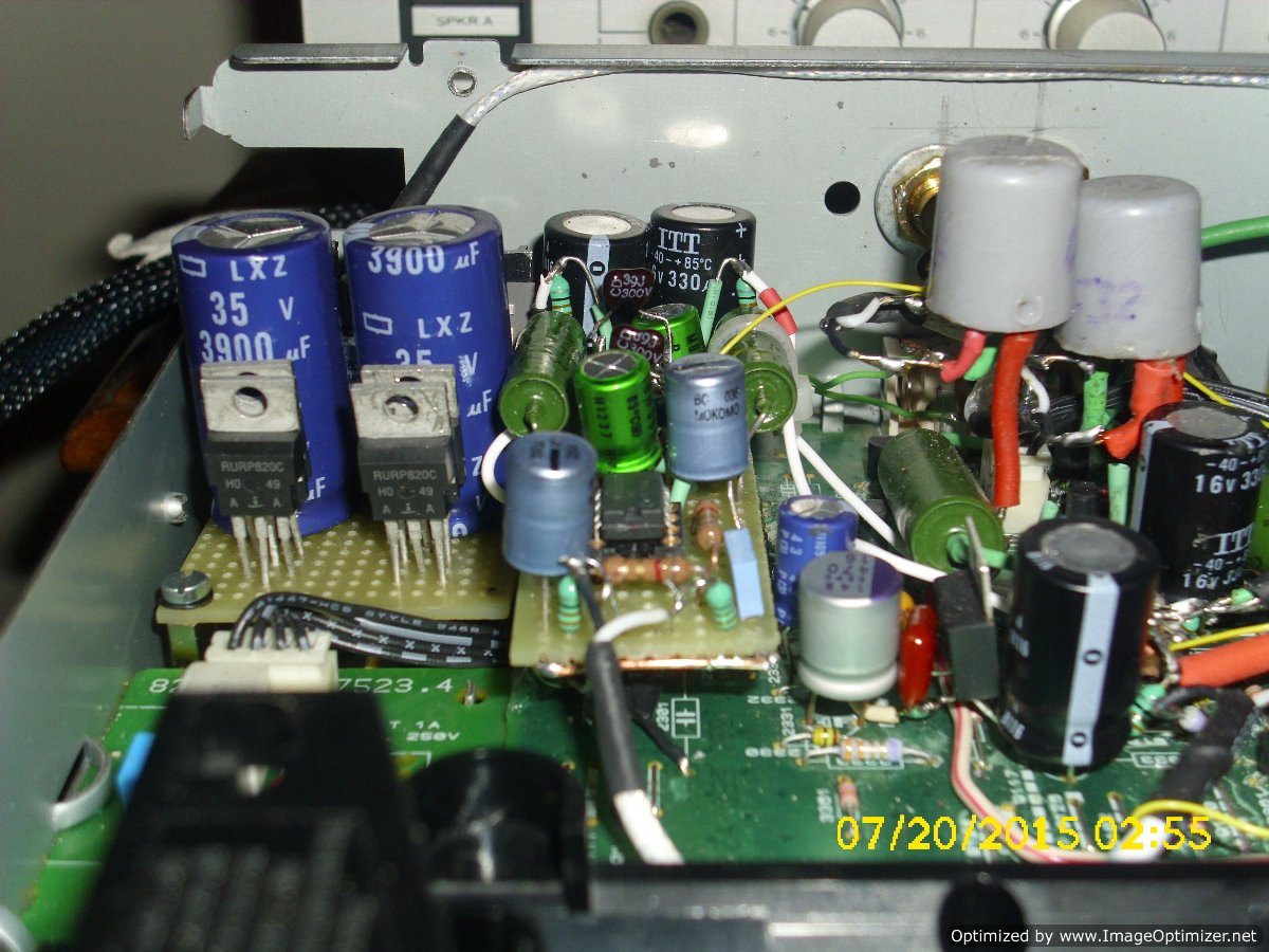

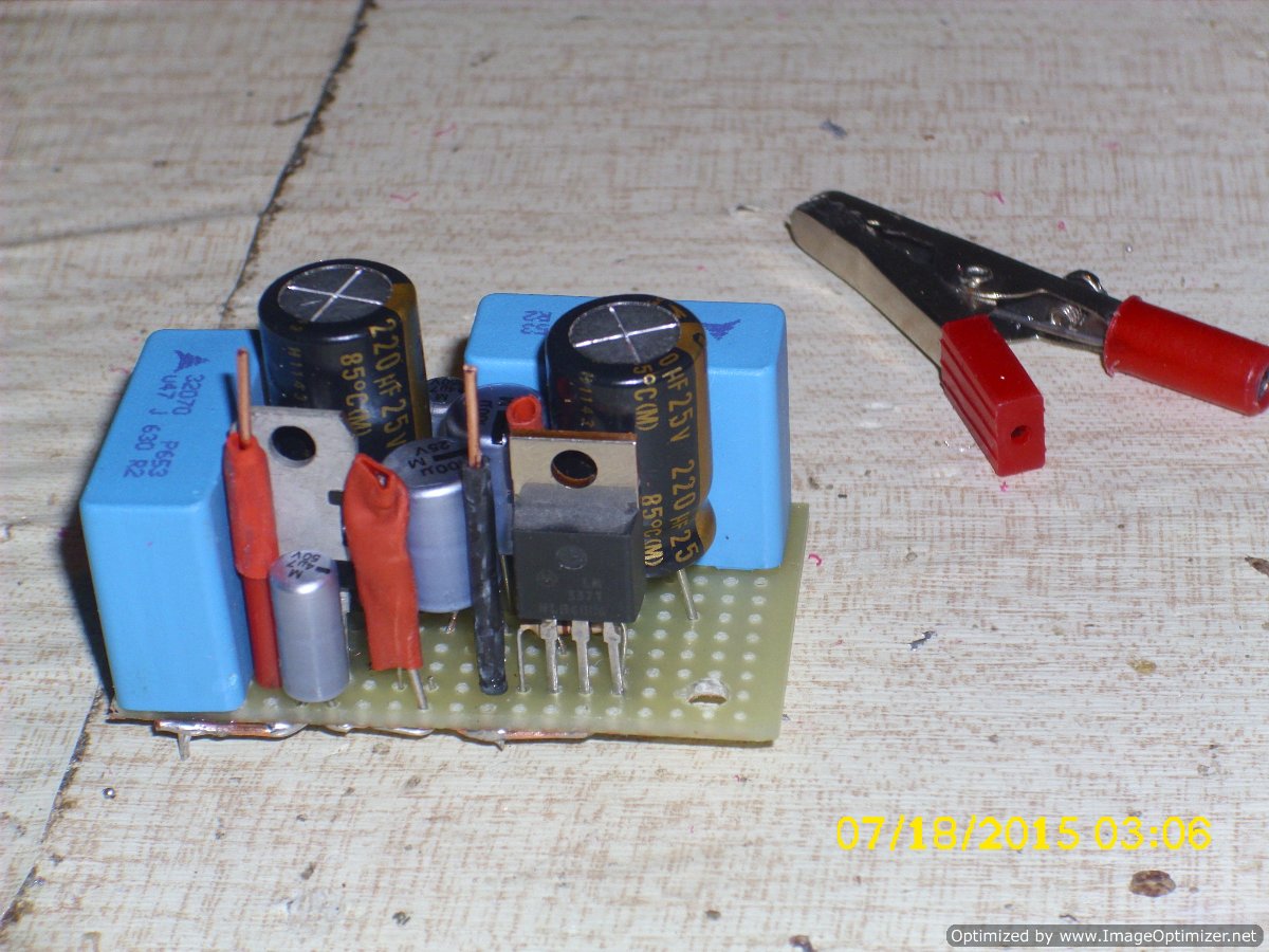

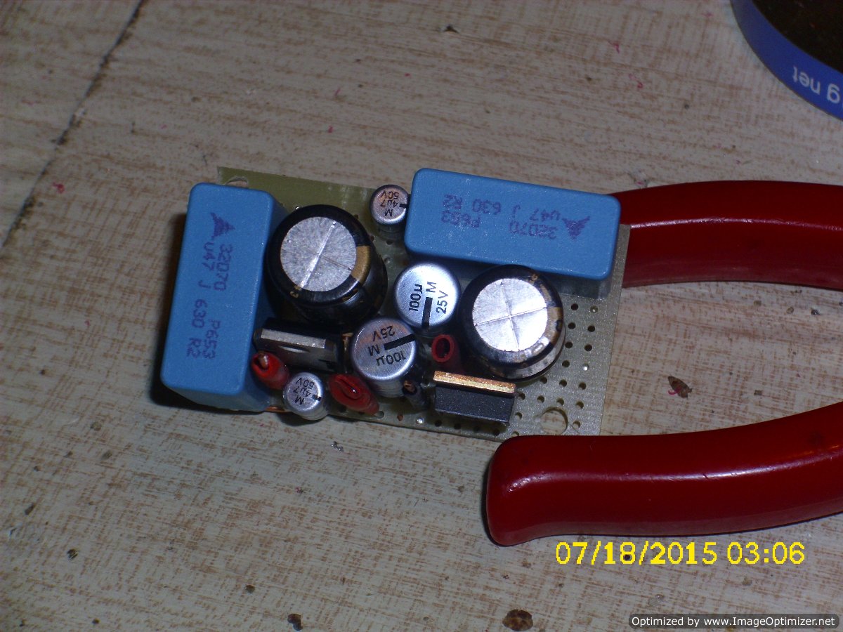

One from the underside....you can see the twisted pair going to the regulator, the orange tant and blue bypass cap.
The red tants are across the original philips axials only.
I did not take out the fusible 3R3 resistors this time - but I will eventually.
I was too keen to do the regs today.
Nice job again Andrew!!

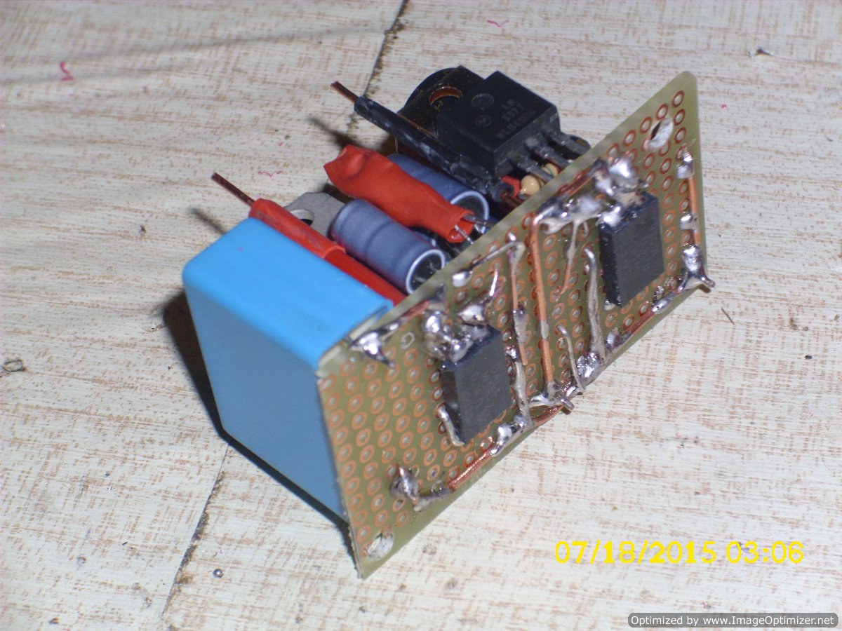

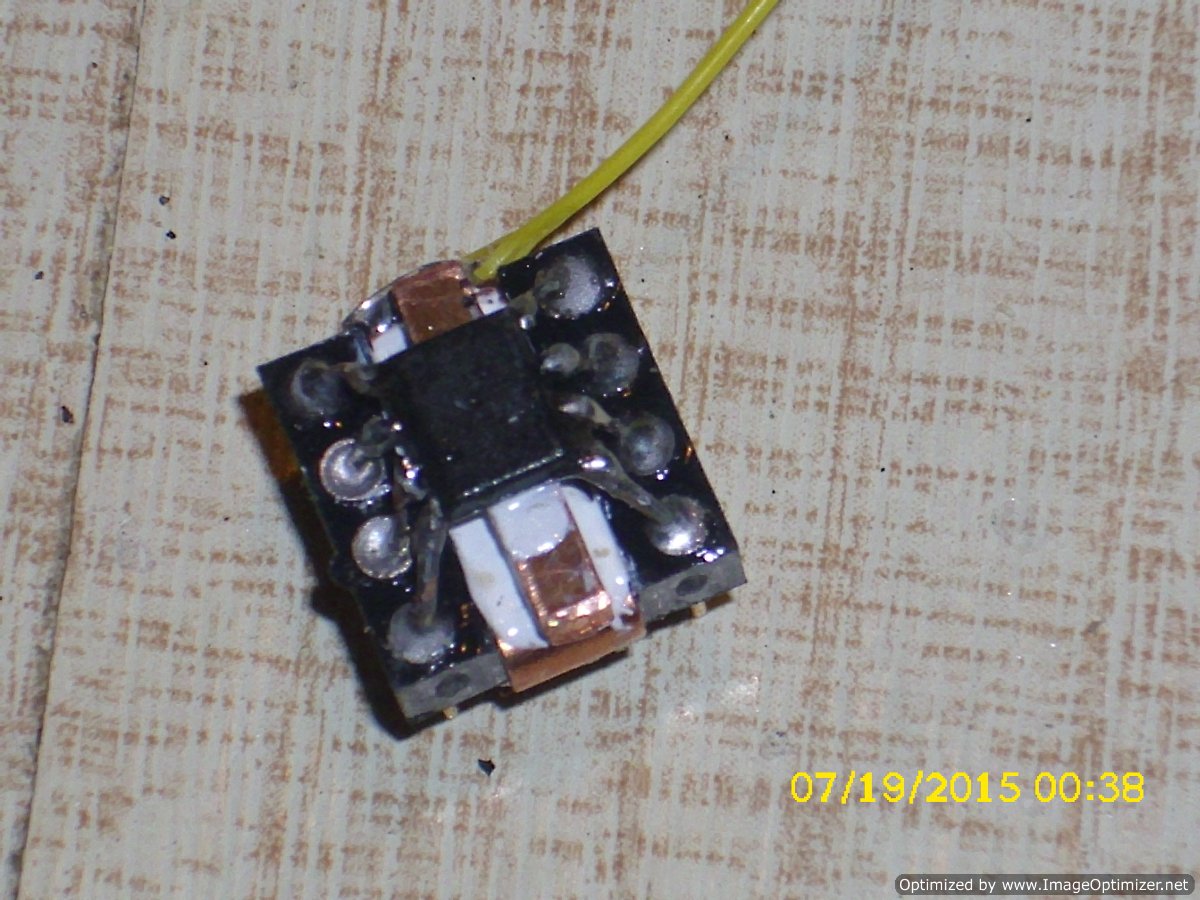

and yes the external I/V is on board since yesterday! It worked at once like a charm. No issues of distortion, noises , clipping etc. The buffer opamp feeds the outputs of the internal opamp with a voltage of 2,49V which almost offsets any current between the inverting input and it's output. So as, the DAC current signal is now transfered to an external fet inputs opamp and from there to the output buffer. After a re-distribution of loads to the various power supplies now is working very nice!! It gave more body to the reproduction, a lot lot of separation in the sound stage and the more important it removed any metalic element left from the previous version...Fisrt I tried a bipolar I/V opamp (NE5532) which was a complete failure:sad: then I put on my beloved AD8066 and get full of pleasure :) This opamp always wins by far. Then I tried the LME 49720 at the voltage offset buffer circuit and matched a better bass response and accurate transients. Then I created a dual regulator stage to drive the 2 signal opamps(external I/V and output buffer) from the tube supply at +-10V , while the offset buffer opamp is powered from the main PCB volages. It's still ongoing ..I will soon report any brake in news.
As a first influence I can say that original internal I/V converters of 1549 are good ones!! The difference is not like day and night. But the mode gets the player to another level (probably to an endless route..)

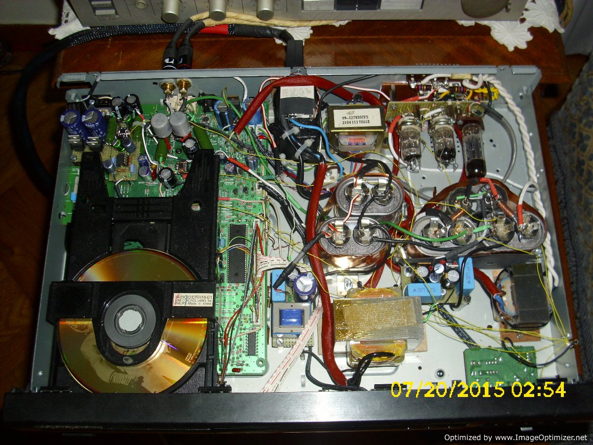

I was expecting a tremendous improvement due to the following 3 reasons: 1) independent package power supply , which confirmed with more space and instruments separation for the external IV in comparison with the kinda rounding and flat sound stage of the internal one. The dynamics In conjunction with the music body also improved a lot. I credit both improvements to the indepedent PS and probably the more voltage +-10 DC Vs 5V single voltage .
2) Bad habit of Philips to incorporate chippy I/V opamps into their DAC chips (eg TDA1547) , NOT confirmed. The 1549 has a relible, decent IV converter that gives it's tonal signature to the chip, translated to musicality and entertainment but a bit ringing in high frequencies. It does have the above limitations in sound stage.
3) Releasing loads from DAC chip (thermal & other) should affect to more linear performance to it's primary work load, means the switching..
Summing up the diference is straight away audible and by making a review of targets set , for sure it's completely succesfull. Not to mention the flexibility for several opamps trials and best match.
It's just the risk of the project that generated expectations for "revolutionary subversion" :D
Never the mind: cost+ labours< benefits. I hope giving you an impartial review

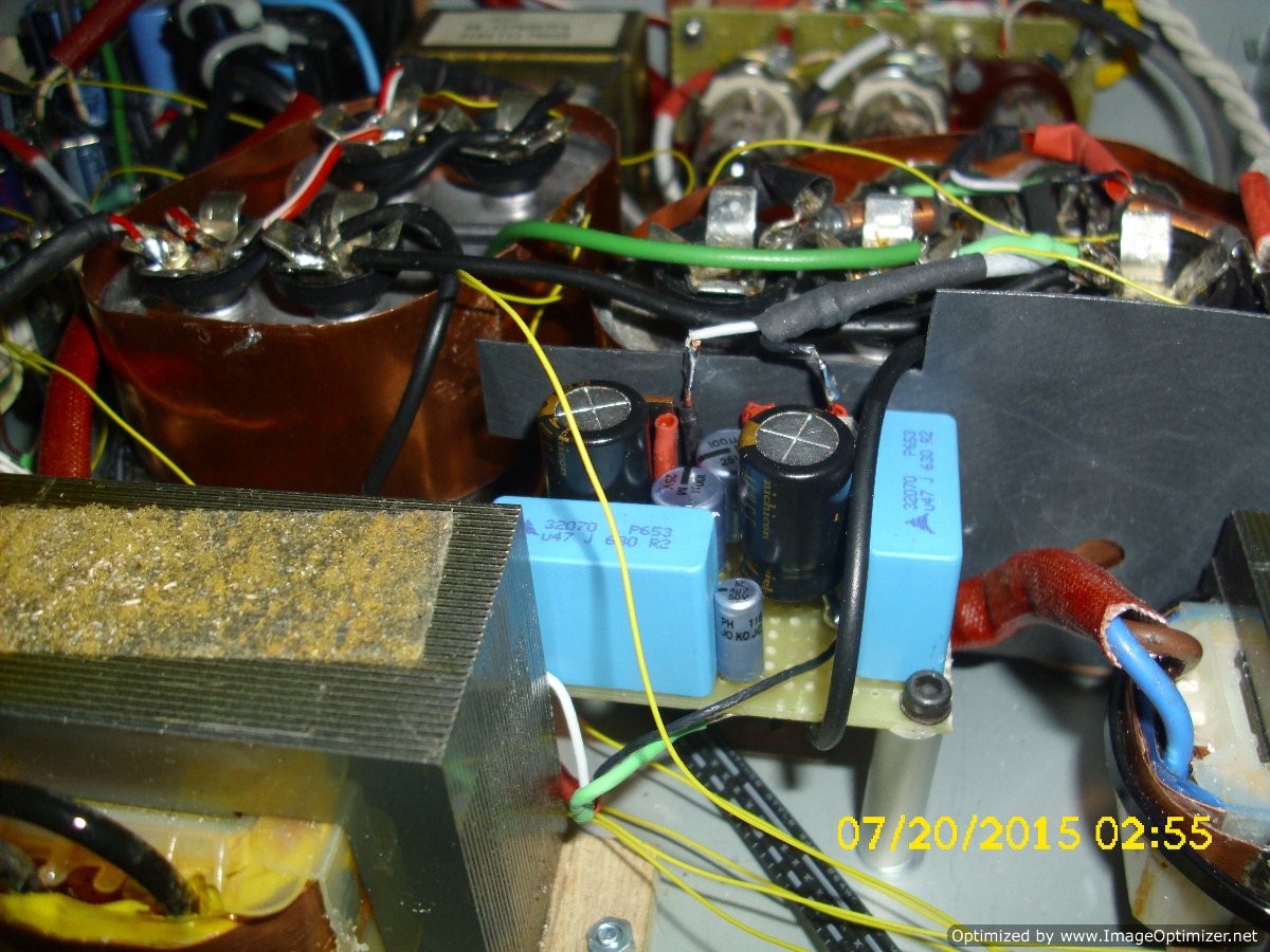

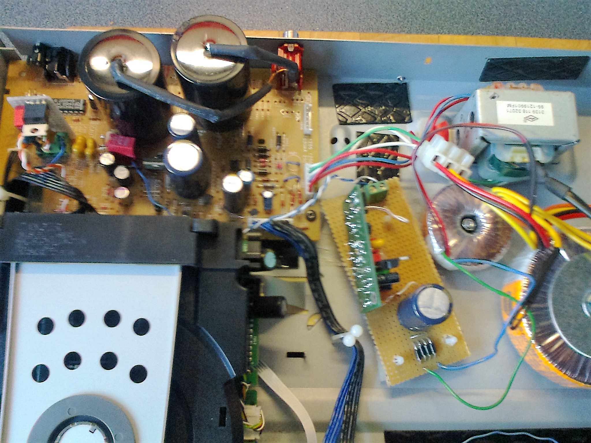

I've just added a 6v x2 toiroidal in my CD48 to power the DAC with it's own regulator, I did have a cathode follower valve circuit in place but I don't think it really added much... I also have 5 brand new TDA1549 DAC chips, just bought them as they are so damn good I might need to replace one

Also added a new 4v reg for the servo circuit.
It's brought back a lot if the bass that I felt was missing a bit before. Very happy with it now.
I don't think I'll do any more to this now, just adding the new feed to the servo circuit ended up with me having to add 2 jumper connections due to the fragility of the tracks. Don't want to risk any more damage.
