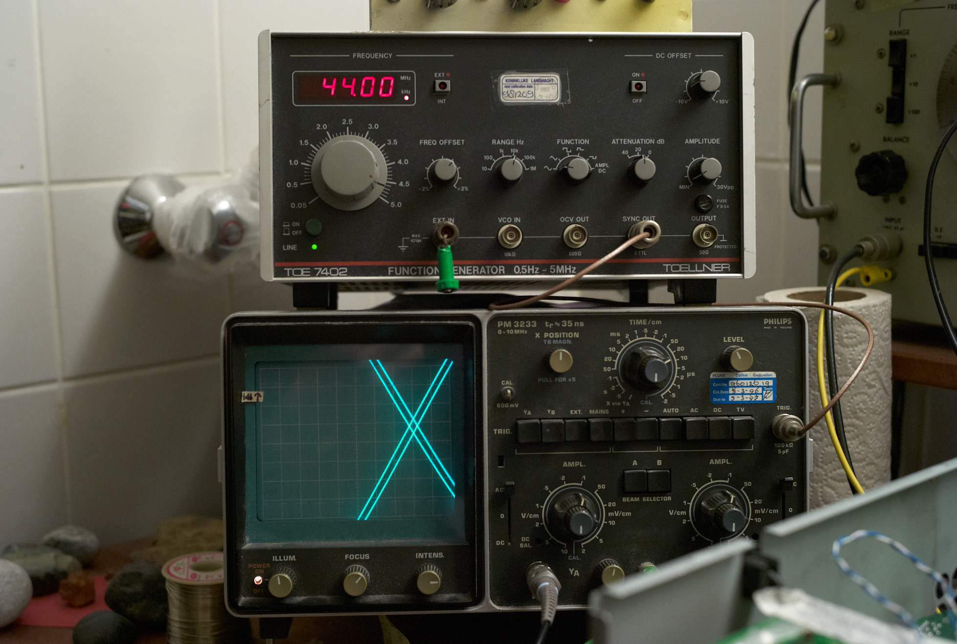

I tried the filter (sans the 470 ohms) directly on the output, but this has influence on the highs (not a bad one though).
The filter tested with 510 ohms (35 ohms generator + 470 input) gives - 1dB at 20 kHz; this is only achieved with the 2,7 nF at the output. With 2n7 there, the bridging cap is sensitive and determines the dip (notch); I tested experimentally and found 940-960 was giving me the nulling at exactly 176 kHz.
Here's a first stab - its assuming the 1mHs have no frequency dependent losses - a major assumption. The working impedance is 100R, set by the desired corner freq and your inductors.
