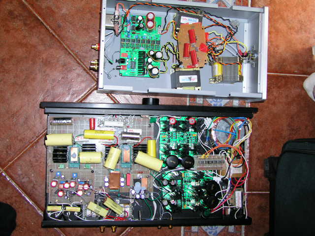

That's why I have my Audio Alchemy DDE v3.0 connected to my DVD, and my own TDA1541A dac to my CDP, for music.
For those who don't know it, the AA 3.0 has: AD1862, PMD100 (HDCD), discrete I/V, class-A analog stage (with OPA627, put in by me, instead of the original OP176).
Long ago I made a big regulated PSU for this dac, with a big toroid, custom-made to my needs, with 4 independent secondaries.
All this artillery, and the sound, although very good, is inferior to my TDA1541 NOS dac, even with HDCD discs!

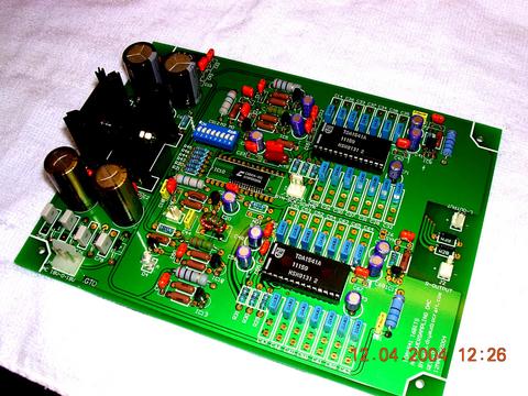

Tda1541a non-o/s DAC PCB..
Dear pedja,
the blue trim is used to adjust the CCS level inject into TDA1541A
output in order to compensate the -2mA DC output
current from TDA1541.
hope this can help.
carlosfm

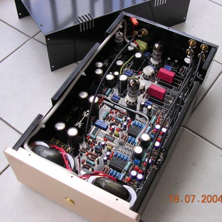

TDA1541a non-o/s DAC PCB Finish..
Dear all,
I switch on my DAC over 24hours.
In room temp, 33 degree.
Close the top chassis already. Normal air circulation to cool the DAC.
The inner TEMP is Approx 55 degree.
Hong kong is summer, so may be quite hot.
If in air-conditional room. 20 degree.
temp will low to below 40 degree.
pls see the full look of the kits include the car oil paint chassis, 1cm thick aluminium facelet. & two power trans.
It cost 3 days to funish.
thnaks
thomas

Thomas,the blue trim is used to adjust the CCS level inject into TDA1541A
Why do you compensate the output current? I could easier understand if you compensate it for 4mA and not for 2mA because you use two TDA1541A. Do you plan to publish the circuit? Did you use some other references while you were designing, other than (excellent) Torben's and Lesha's site and Thorsten’s work whose you have mentioned?
Pedja
Dear Pedja,
I understand what U means.
U really right, its total 4 ma per channel. I test already 4ma on each channel. So I added one trim to Balance the adjust.
Sorry I cause U misunderstanding. I means is 2ma one chip.
So will 4ma for two chips.
Pedja, I think my digital knownledge will not better than more Europe engineer. So I use my limited knownledge to lay out the PCB> test them> compare the Information from Torben's and Lesha's site and Thorsten. Then I get this result.
The parts ( caps, Elna, Pureism, ERO,,,, resisters ( signal use dale) output I/V use better one & large watt use CGW & IRM, matsushit too) & then fine tune of sound. I & my friends compare to many DAC already.
Marantz DA95 also one of the compare one because DA95 Use TDA1541a.
DO U know that nowadays the market Use two TDA1541a DAC had only one in Japan but sell USD 10000.
The total circuit I will put to my website several days later, I was so busy & counting the total parts arrived my hand.
Pedja, This DAC will not make U disappointted, My friend use wadia 6 to compare the performance & after test he call me sell one set to him.
Hope U will understand what I mean because of me worse english.
pls see the test print. Version 1.0.
Black DAC PCB is version 1.1
thanks
thomas
Pedja,
I will not agrue more about the circuit or others to U.
We all are diyers, we had difference culture, we had different taste. In diy world, we had different point of views too......
Actually, I need time to prepare the construction menu for the kits.
I sell over 15 sets to diyers already. I need to amend the detail of the construction menu for easy funish.
For the first & second questions.
The kits will contain check list & all of the circuit for the diyers to funish the kits.
The PCB will only had R1.. R2..R3.. & C1..C2..C3..already.
this is most easy for me to amend the change of parts detail.
The Detail of the circuit I will post to my company for all diyer to download. Its a PDF file. I need time to prepare. DIY is not my carrer. I only share good item to diyers.
Can U tell me If I really earn money. This quality kit will I sell only USD 200???? If U can get another kits which contain over 300 parts as the grade as mine. I will be the first to buy one set from him.
There is no secret in the world. Me too. But I need time to funish.
pls consent my condition.
I will very happy to see Pedja your Design.
thanks
thomas
