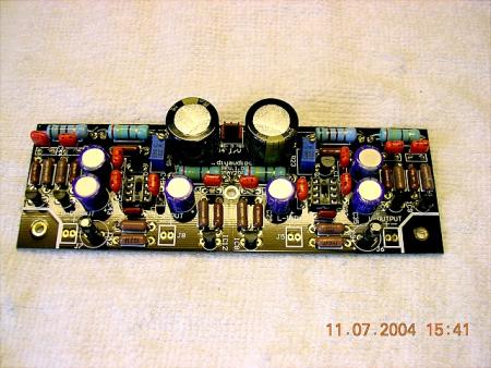

Tda1541a non-o/s DAC PCB.
Dear all,
I hope this Twin TDA1541A OFC FR4 PCB with all the parts will satify much more digital DIyer's desire.
Due to many people ask for the kits or PCB.

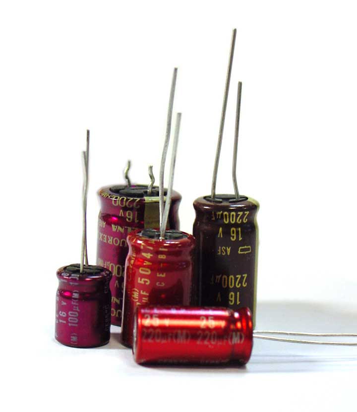

I gurantee that if my PCB ( 2mmOFC FR4 PCB ) & parts
Resisters : Dale, CGW, matsushita & non-inductive IRC resisters.
Optional is RMA.
Capacitors : all were OS-con & Elna RJJ low ESR , Matsushita silver brand & pureism.
Decouple cap is philips Blue box 63V 0.22uf. Output cap standard is ERO Cap.
If parts not as the list.
100% money Back GURANTEE.

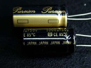

photos was lst I decide use the 50V 10uf in the power supply part use. Panasonic audio grade OFC lead out Audio cap.
PUREISM
thanks
thomas
dear Kuei Yang Wang,
I agree for your opinions. So I reserve 3 method of the tube output stages in the tube output PCB.
The user can use ad844 output stage with the 6dj8 low voltage buffer to output.
Otherwise if they did not like tube output stage. The output PCB was same as a pre-amp PCB. U can choose RC couple or choose 6c45, EC86,ec88 than use pre-amp output 10K or 20K : 600ohm for transformer output.
So, nothing about PCB will waste. Certainly DAC can combine the pre-amp output transformer with the DAC.
But this will decide by the user.
thanks for your opinions about the linear analog stage. I face this problem during design this PCB & solve already.
thnaks
thomas

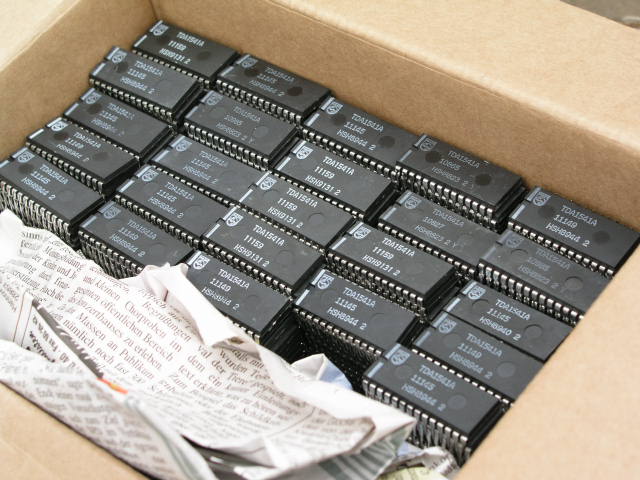

Two TDA1541a, two AD844 & one CS8414 or 8412 which up to the diyers choice.
100% moneyBack GURANTEE.
I had large stock of TDA1541a on hand from philips factory which was spare parts.
the two R-core power transformers was optional.
one is for digital board & one is for analog & HV use.
thanks

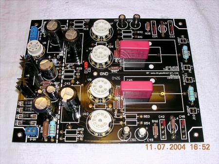

Dear all.
this two website was the reference material for me to reference.
http://hjem.get2net.dk/torbenk/
http://users.podolsk.ru/boga/DAC.html
But some parts no I was change after I funish the protype & test. Special is the I/V output stage. The tube output stage I was combine with 6C45/Ec86/EC8010,6DJ8 SRPP & 6Dj8 buffer. Which can use jumper to set up by the user.
VERY FLEXIBLE!!!
For example, If U use the AD844 directly ouput.
( A- board is the digital board + C-board AD844 output stage)
the remain B-board PCB can use as the pre-amp use.
6C45 or ec86 all had very low plate resistance. U can change it from cap couple to 10K/20K: 600ohm pre-amp output trans.
The U waill not wate the PCB, another pre-amp was on your hand.
U got a pre-amp with 6C45 or EC86.
thanks
thomas

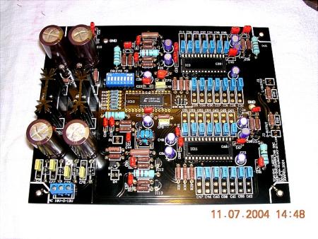

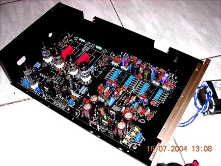

The outlook of A-Board ( digital Part Board) was finish.
I will finish the tube output PCB Board( B-Board) & AD844 OP-amp (C-Board) ASAP.
The enclose black material was contain Graphite Carbonate so its Black in colour with smooth surface. This is I ask for the computor PCB factory & answer to me.
All the parts U see in the photos will same as the supply kits.
Which as I say. 100% GURANTEE money Back if not same.
Very thanks----Happy Diy
thomas

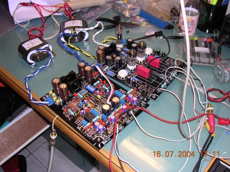

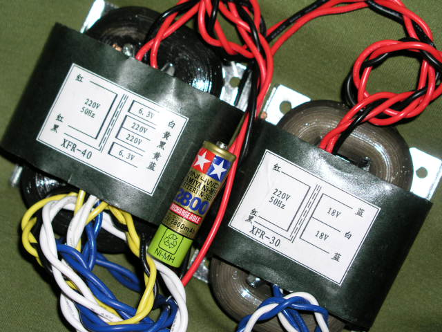

Dear all,
the power transformers for this kit was pass the 48 hours stable test already. Temp stable approx 40 degrees temperature.
pls take a look for this two power transformers.
PLS know that this two power trans is optional,will not follow with this kit.
But >>>>> I also a diyer, I hope my product can benefit more diyers too.
so I lower my magrinal profit...... really.
This pair power trans one is 30 watts, one is 40 watts.
All had copper foil ground to lower the leakage.
Left hand side XFR-40 one is for tube output stage use.
one winding 6.3V for 6X4 rectifier tube.
another 6.3V winding is for 6DJ8, 417A,404A & ec88,86,8010 use.
The 220~0~220 is for HV use. If u use 6DJ8 buffer, U can use the large watt resisters to drop the voltage.
Right hand XFR-30 is only for digital parts use.
This means this kit will seperate to two power transformer to lower the noise, more stable & higher S/N ratio.
I will sell USD 43 per pairs only with the kit but must added some postage. Kit only will free of charge for posatge.
At least is if the diyer willing to pay USD 10 more, I will change the Output caps to ERO KT1803 & the diode change to MBR 160 or Schottky series
P.S. ... the construction menu I was writing, will link to my web this several days with full support. Easy & continous amend the parts change with different performance.
