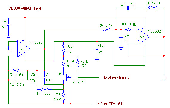

Just draw a schematic of the CD880 output stage from the pcb and I found a strange transistor 2N4859.
Any idea what it is for ?
There is 1,5kohm in the feedback loop of the I/V converter opamp.
Parallel is / should be 5,6nF.
Now they put the BE junction of the 2N4859 in series with that 5,6nF cap.
C of 2N4859 is connected via 4,7Mohm / 100kohm in series to V+.
From where 4,7Mohm / 100kohm are tied together, it goes another 4,7Mohm to the other channel.
jean-paul said:It's the standard deemphasis circuit switched with a FET.
Never seen any non os circuit with deemphasis.
Is it necessary ?
Can I throw out all parts, except X1 & R1 ?
