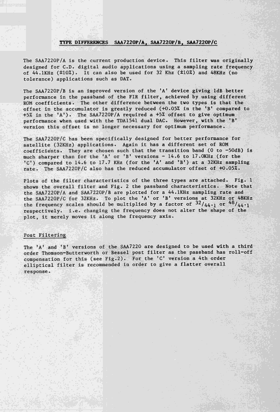

Do you have any idea why when I exchanged SAA7220P/A for P/B version in my Philips CD 304MKII the player doesn't work? DAC chip is changed from TDA1541 to "A" version.
Bartek, I did the replacement of this combo too long ago to remember what the exact changes were. Please refer to a schematic of a cdplayer with the TDA1541A/SAA7220P/B combo to see what's different from the original schematic of your cdplayer with the non A version. I don't have any cdplayer with the non A version and I don't collect those either ( that also counts for CDM 1 machines ).

Bernhard said:I listened to my CD304mkII again today,and it still was better compared to CD880. (Plain 1541 in both players.)
More relaxed and open sound , more air and bigger sound stage.
What else could it be if not the DAC chip ?
Pulled out the 7220A from the CD650 and plugged it into the CD880 and:
Sound is now the same like CD304 and CD650.
No doupt, the 7220B is crap. Old 7220A is better.
I would be happy if somebody could compare them too and confirm it here
