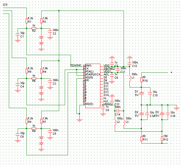

Has anyone build this voltage-level circuit for 1541's I2S yet????
http://www.diyaudio.com/forums/attachment.php?s=&postid=376208&stamp=1082491308
I am curious for the results.
This is a huge thread, so it would be a waste of typing-time from all contributers if no-one tried the schematic. I consider to build it, with dem-reclock.

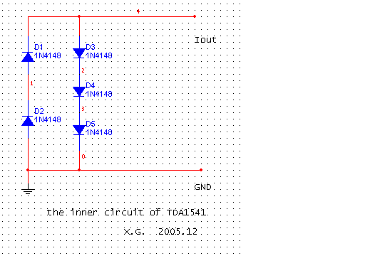

the output clipping diodes of TDA1541
I checked the the output clipping diodes of TDA1541,using my method showed here
http://www.diyaudio.com/forums/showthread.php?s=&postid=535159#post535159
I found it is .....
I found it is .....

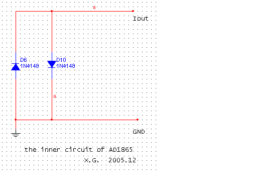

for comparing,I checked the output clipping diodes of AD1865 again,using the same method.the result is
Very nice X.G. , your measurement-possiblitities.
hi,tubee
I didn't try the voltage-level circuit for 1541's I2S,because it is too complicated to me.
but I and my friends tried to add 3 resistors in the I2S which between CS8412 and TDA1541 for reducing the groud-bound effect,and got the much better sound.the best value of 3 resistors is 1K-3K(!) showed below,not 22-100 ohms which is ordinary in the other DAC.
