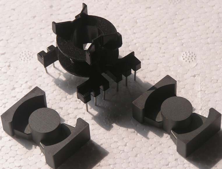

I've temporarily mislaid the last pair of DAC output trafos I wound, so here's a pic of some of the ingredients - the two PQ25 core halves and the bobbin behind. The '25' in the name is the width of them - 25mm.
If anyone wants to know the equation needed to get designing with these, just ask. Once the right number of turns have been wound on (I'm so lazy I can't be bothered to count, I check the ratio with a siggen and AC voltmeter) then I strap them together with yellow transformer tape.

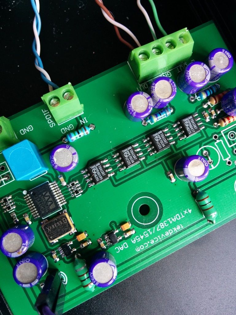

Hmmm, I'm not sure I like the 4X.
:magnify:
4 chips are sharing one sm bypass and OSCON?!?
This is how I'd redo it (w OSCONs over each sm bypass) but for the last 3 chips, the sm cap connects to a small gnd island that is attached to the back gnd plane by one tiny via.
Hmmmm, not sure that's right...
What thinks you ('braxy)?

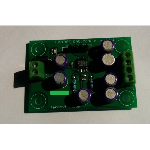

However, it looks like they still have the single 1387 at the tecdevice website:

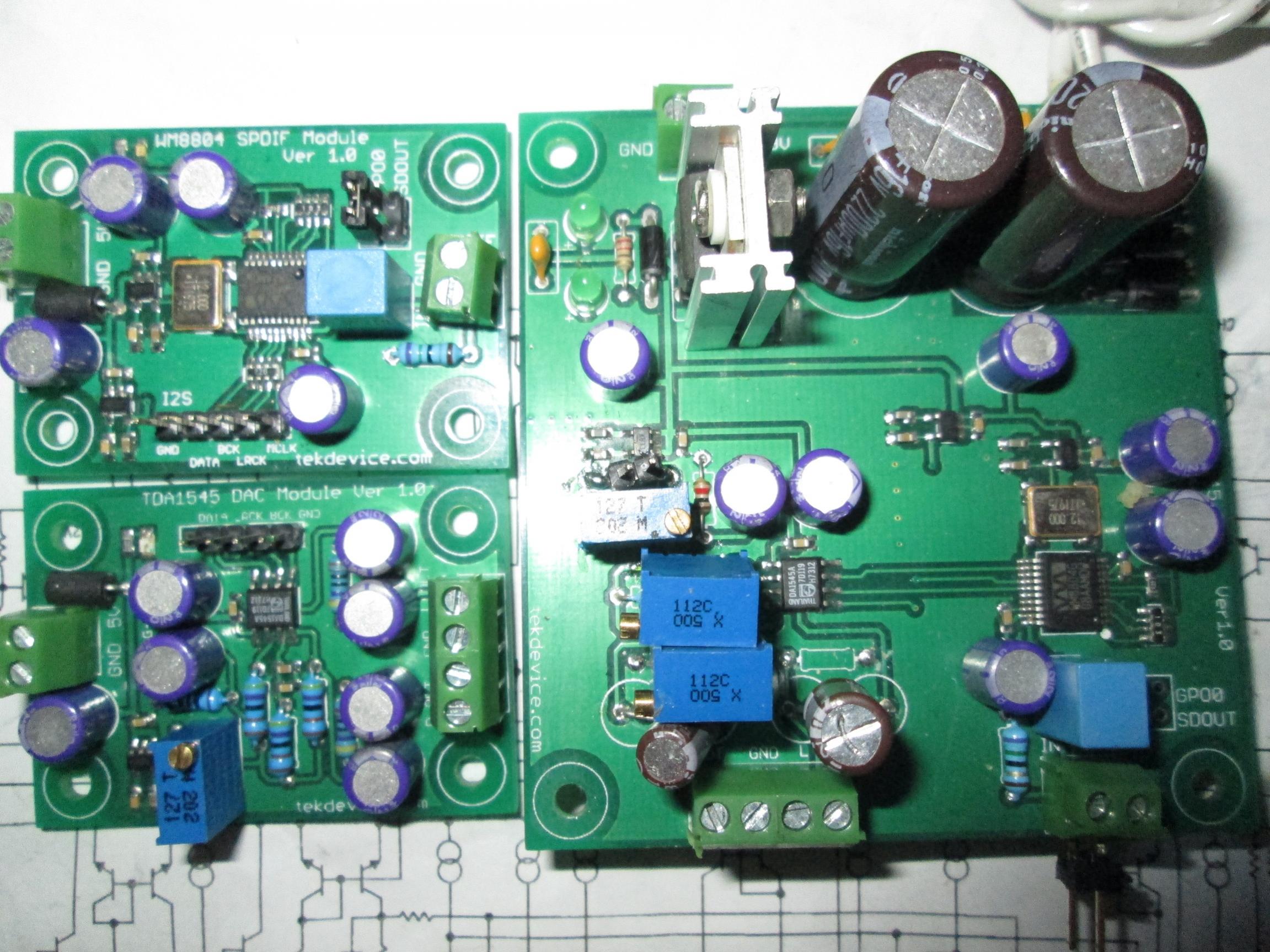

TDA1387 I2S DAC Module Passive Resistor I/V
And their WW8804 does I2S (1387) and 1545 input:
Wolfson WM8804 SPDIF Module Support 16/24Bit I2S Left/Right Justified

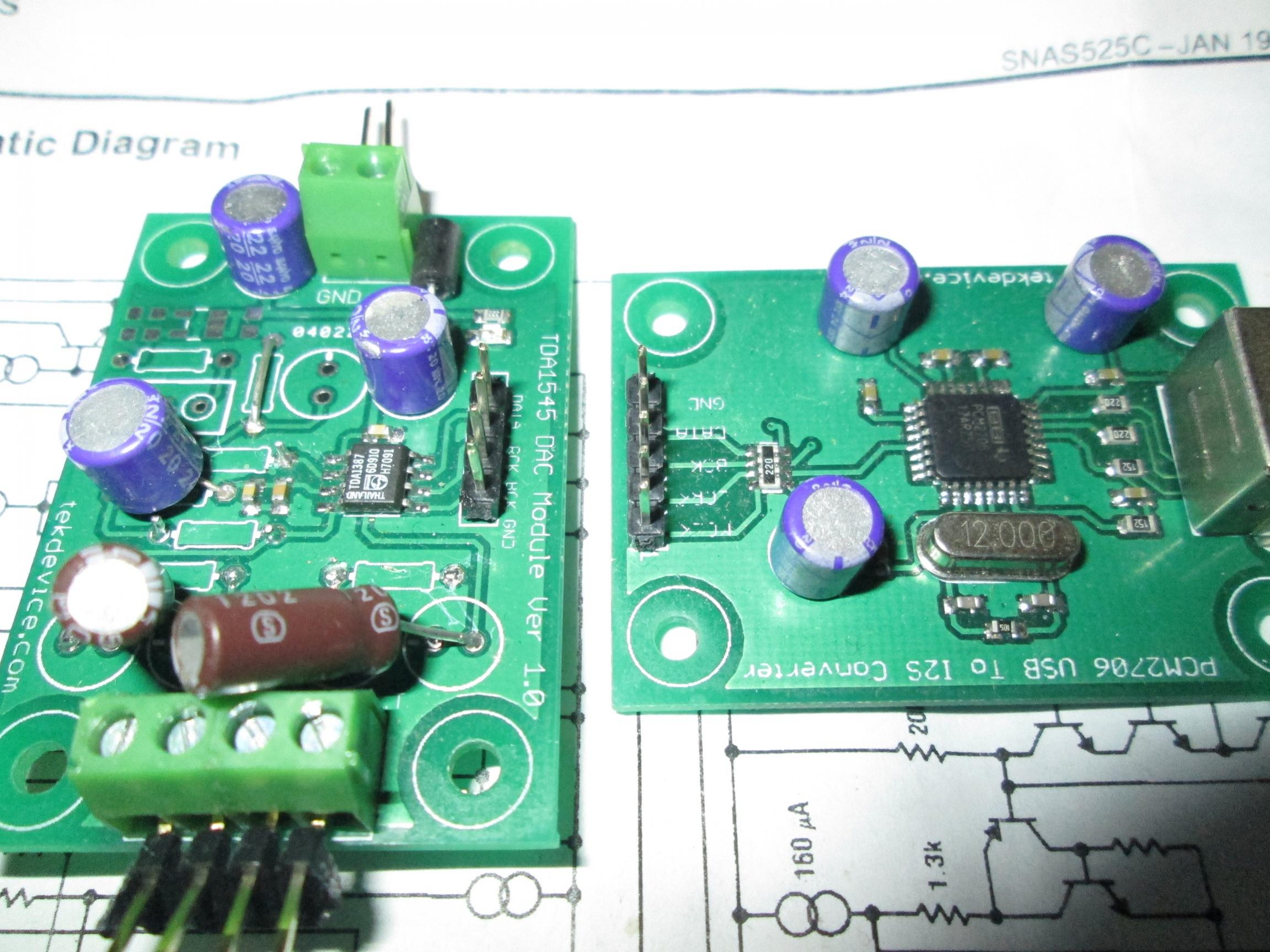

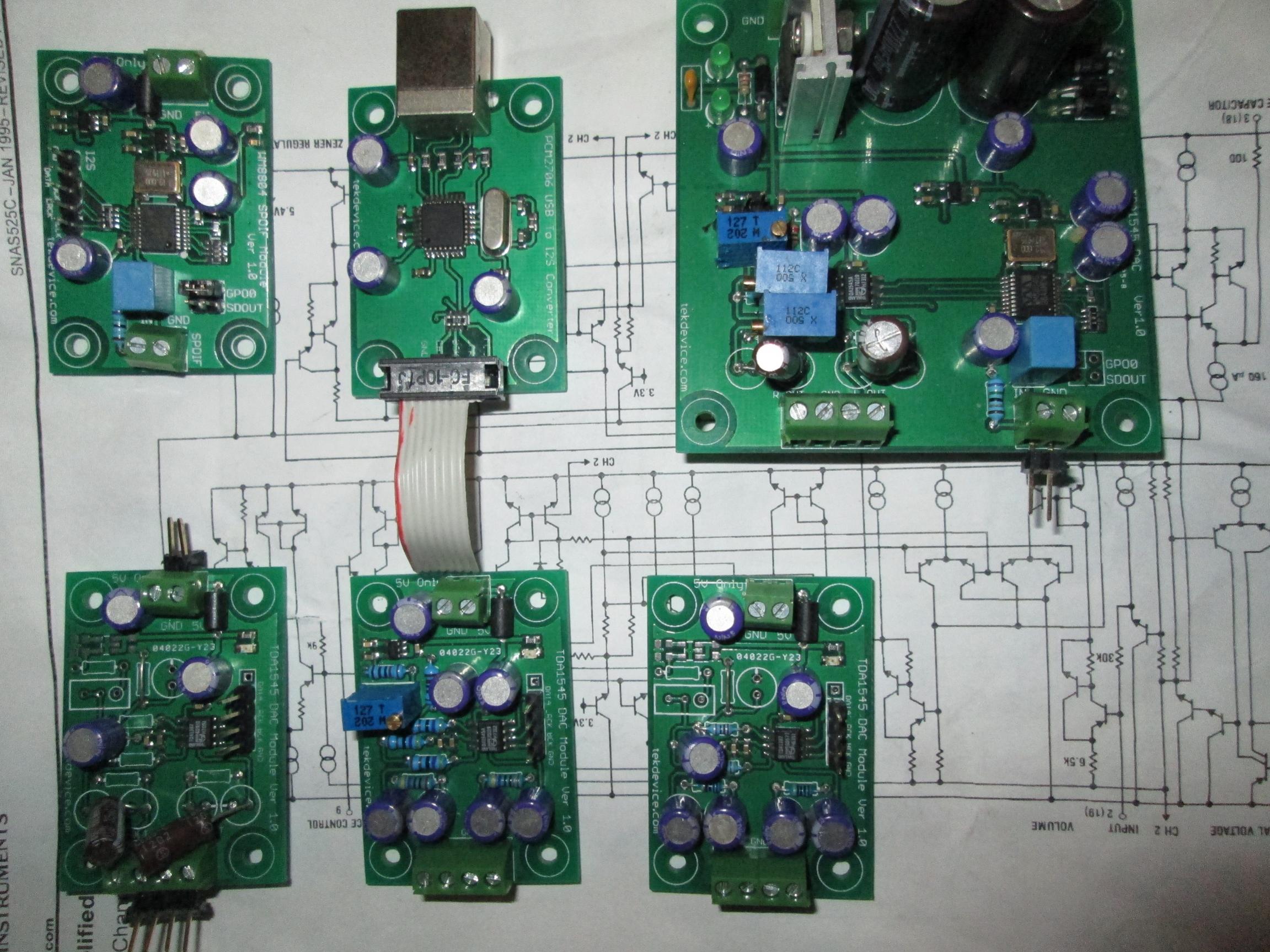

I've been using their single TDA1545a board for a while with great results. In fact, the treble on the TDA1545 is spectacular, unmatched in my opinion.
On that basis I've ordered one of the 4x TDA1387 units, will post more when I've powered it up and use it to determine just how bad the new Pink Floyd album really is.

I've asked TekDevice for some details on the 4x tda1387 unit.
So the iv resistor is 1.2k and the output is about 1.5vrms.
There's also 22uf bypassed with 0.1uf at the pin 7 ref (whatever that means).
