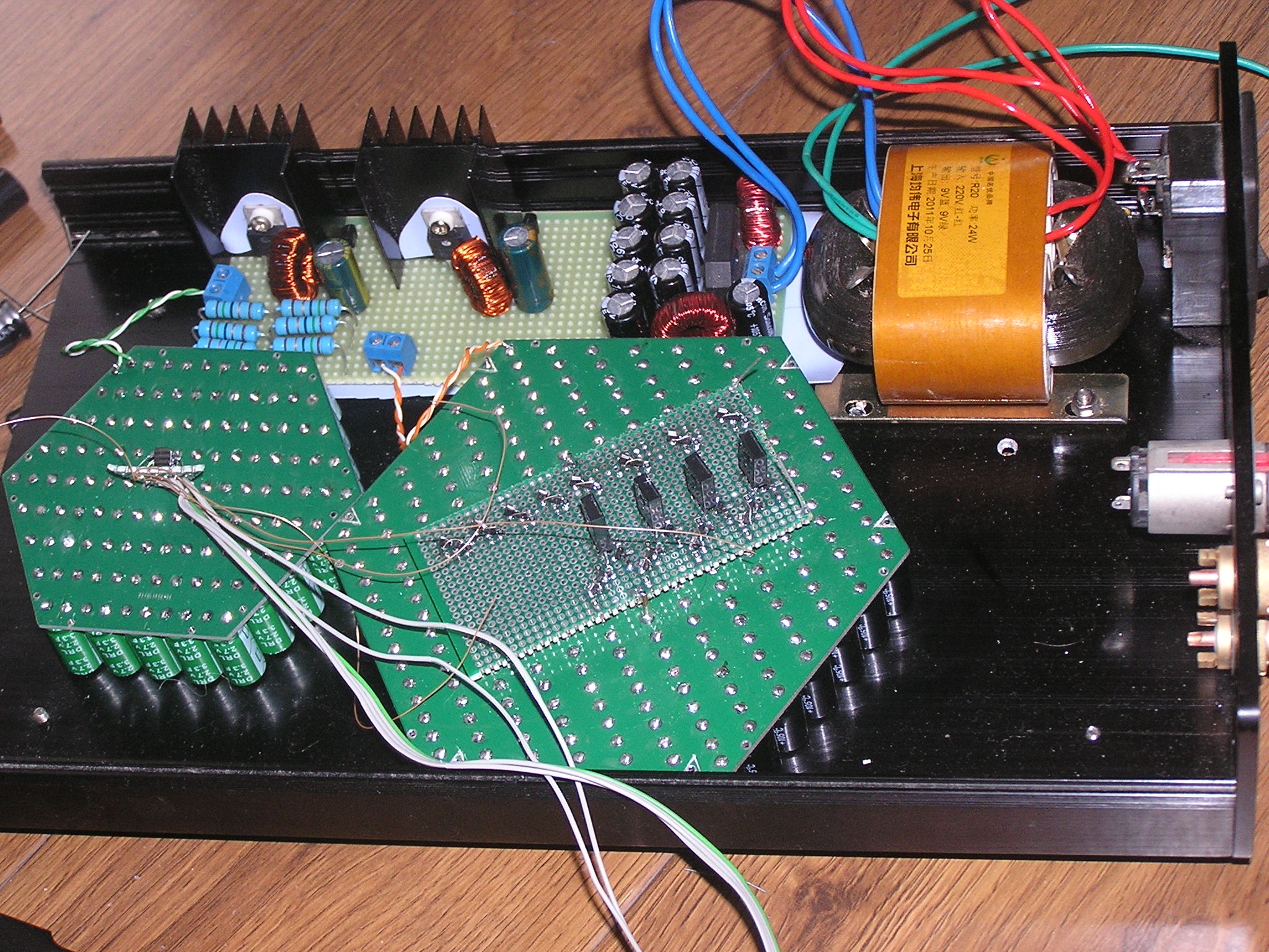

Ozone - Basalt edition
Here's my latest 'Ozone' DAC incarnation, the 'Basalt' taking shape. The box is one I bought from a Taobao seller a few years back when I was first dreaming of creating a DAC. At that time though I had no idea that I'd need so many capacitors on the supplies, so for this variant I'm dispensing with the AD815 stages as the caps it (the AD815) needs to optimize its dynamics simply won't fit.
The power supply is at the top, with LC filtering and MJE15035 transistors for regulation of the supplies to the two cap banks. The smaller hexacap is based on some 3.3F supercaps and powers 4 * TDA1387 in dual differential mode. On top of the larger of the two hexacaps is a balanced discrete buffer which is experimental. Still to add are the balanced LC audio filters and the output transformers. I might even add an S/PDIF interface at some point but for now its I2S in.

With all that "TLC" and INVESTED TIME tweakin' n' cajolin', I'm sure it sounds nice ... but ... this is old-style DIY: i.e., massive use of real-estate, linear pwr, etc. ...
The latest diyparadise TD1545A "mojo" ... a DIY "Manhattan" project ... is similar in CinemaScope ... err....or is that Panavision:
And I should frigg*n' talk!!!... some of my former projects with CD players and massive external PSU are 10x worse the offender ... are inconvenient ... and just (now) sit uselessly in storage ... all the while my "smartphone" or 'Pad + headphone amps/DAC (super cheap Chinese ready-made and no soldering required) get all the musical attention.
What's de rigueur in certain DIY circles is to squeeze something similarly high-performance down to something pocket-sized, with USB input, and LiPo powered. (IMO, that's very possible given modern, micro components).
So, that should be a goal of a thrill-seeking DIYer with TDA1387/1545A in mind: small, portable, battery-powered, and practical ... i.e., one used so often, as in daily playlists, that it becomes ubiquitous-in-pocket.
