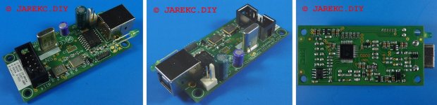

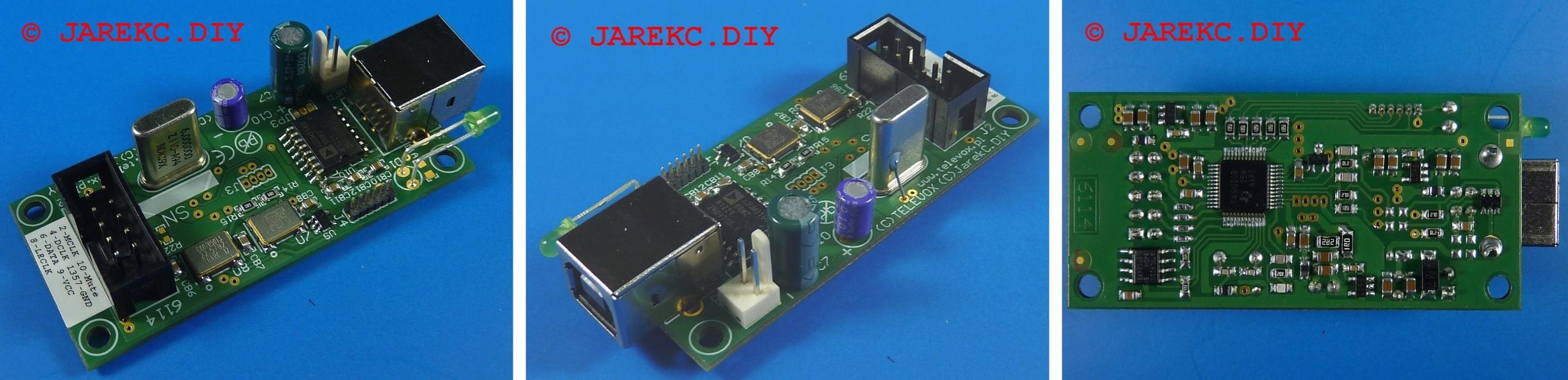

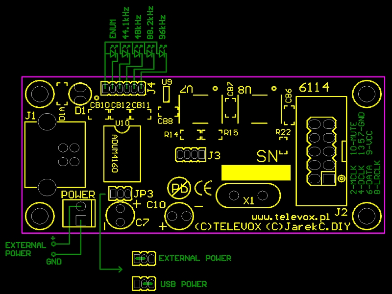

New version of USB-I2S is ready. All works fine.
On PCB is a small error in the description of I2S connectors. (corected by label)
Tomorrow I will post information about avaliable versions and costs.
Changes compared to the previous version:
-galvanic isolation on PCB (ADUM3160 + LDO)
-shorter track for Master Clock signal (from XOs to TAS1020B)
-elimination of the multiplexer in the Master Clock signal path
-sampling rate signaling with 4 LEDs (each has its own LED)
-series termination resistors on the I2S bus lines
-22.5792/24.5760MHz generators + LDO can be mounted on the PCB, or connected via connector
-two modes: 16 bit (32bitframe-16bit data) and 24 bit (32 bit frame-24bit data)
(I can make special only 16 bit version 16bit frame-16bit data for old 16bit DACs)
-derived power to the I2S connector, ability to supply DAC
-smaller dimensions, only 67mm x 30mm
-4 mounting holes
Best regards
JarekC

At this moment I have only 10 PCBs (3-4 are now reserved).
A I can build two version of USB-I2S converter:
Version A:
- TAS1020B aynchronous mode I2S output 24bit (32/24 frame ) & 16bit (32/16 frame)
- Fs 44.1kHz, 48kHz, 88.2kHz, 96kHz
- MCLK = 256 Fs
- low noise LDOs (2X LP2985)
- USB Connector Type B
- I2S Connector 2x5 Pin (raster 2.54mm) (3.3V HCMOS Levels)
- Low jitter generators 22.5792MHz/24.576MHz
- powered from USB or external supply (jumper)
- control LED + header (1x6Pin ) for Fs LEDs
- native drivers for Windows, MAC OS, Linux (UAC1.0)
- gold plated PCB
Version B:
- Version A + galvanic separation (ADUM3160)
- USB side powered from USB BUS, TAS side powered from external supply
Version A costs 220 PLN (Polish Zloty) its about 68$/52Euro
Version B costs 278 PLN (Polish Zloty) its about 87$/66Euro
Shipping cost is 19 PLN about 6$ (Registered Mail Polish Post)
PapPal Fee is 4%
Best regards
JarekC

Aditional information:
- connection scheme of external components (correct I2S pinout)
- device scheme for people who want to modify supply or another part of the converter
If anybody interested I still have 2connverters for sale , version A or B.
SPDIF version still in design.

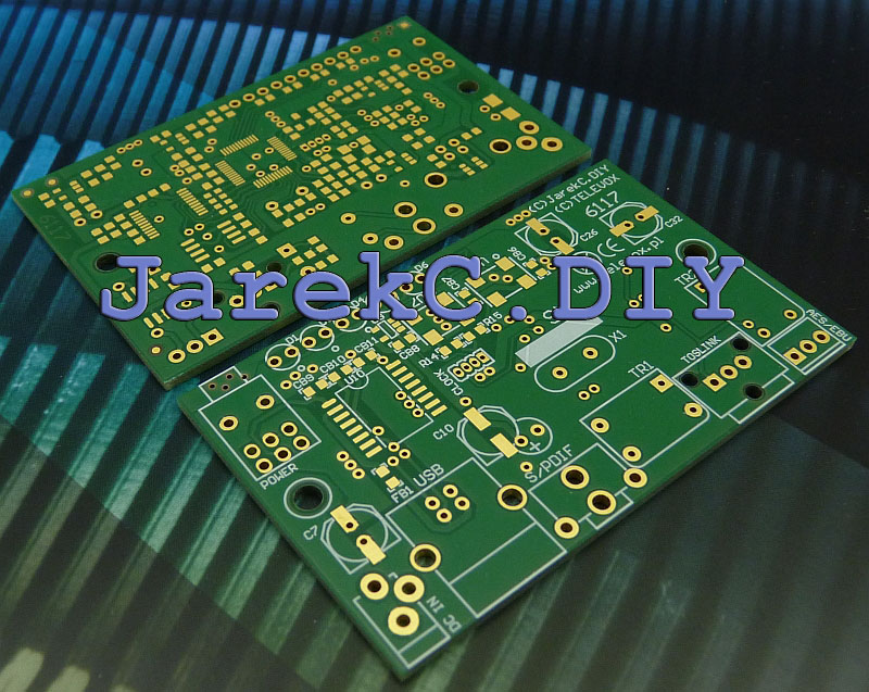

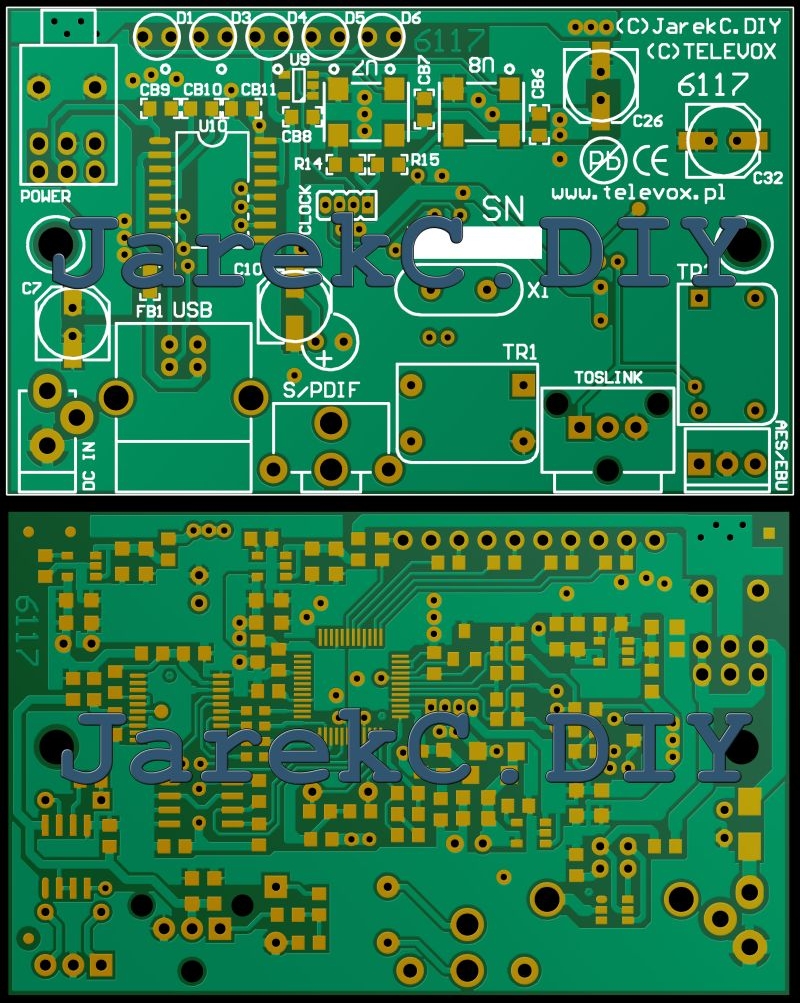

New version of USB-SPDIF PCB is finished.
-LEDs and power switch on the front side , connector on the back side
-4 mounting holes
- S/PDIF Output: COAX, TOSLINK, AES/EBU

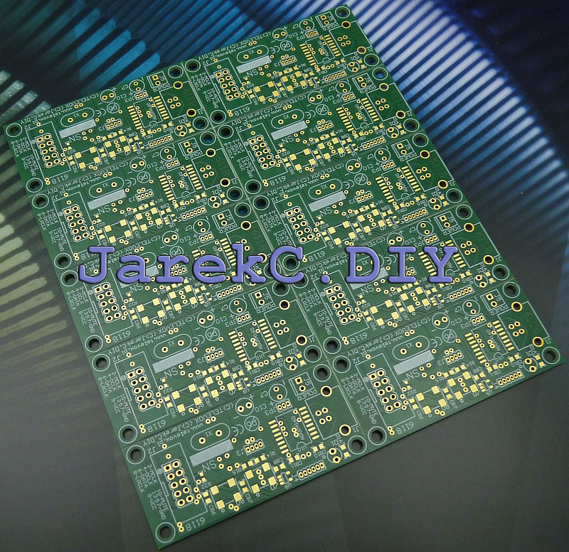

First prototypes PCBs (5pcs) in production.
A also ordered next batch (10 pcs) of PCB for USB-I2S converter.
If any one is interested in it will be available in early March.
In attachment pictures of PCB, both versions USB-I2S and USB-S/PDIF.
