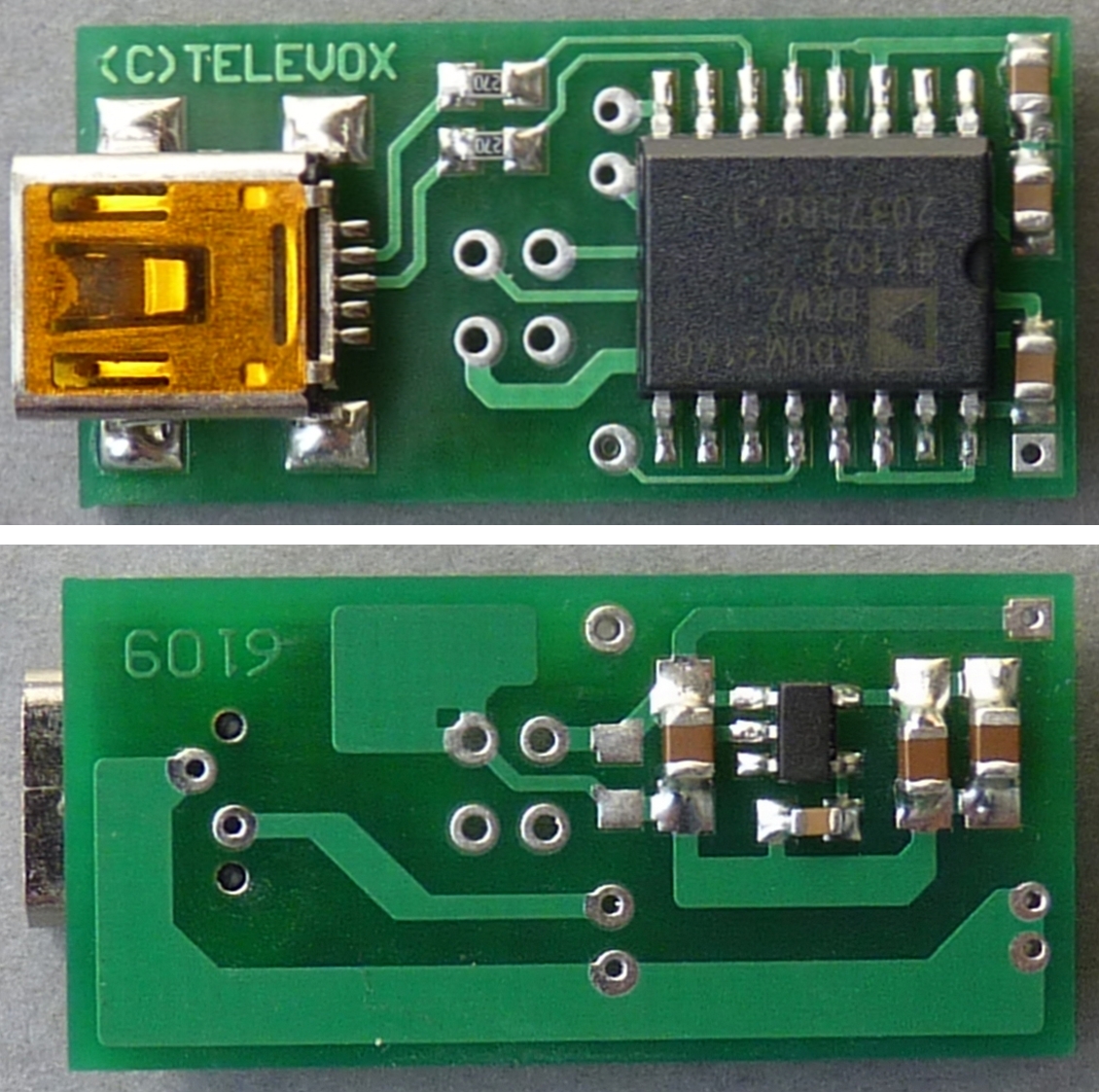

I also received PCB for galvanic isolation based on ADUM3160.
I soldered and tested one it's works realy fine.
Photos on monday.

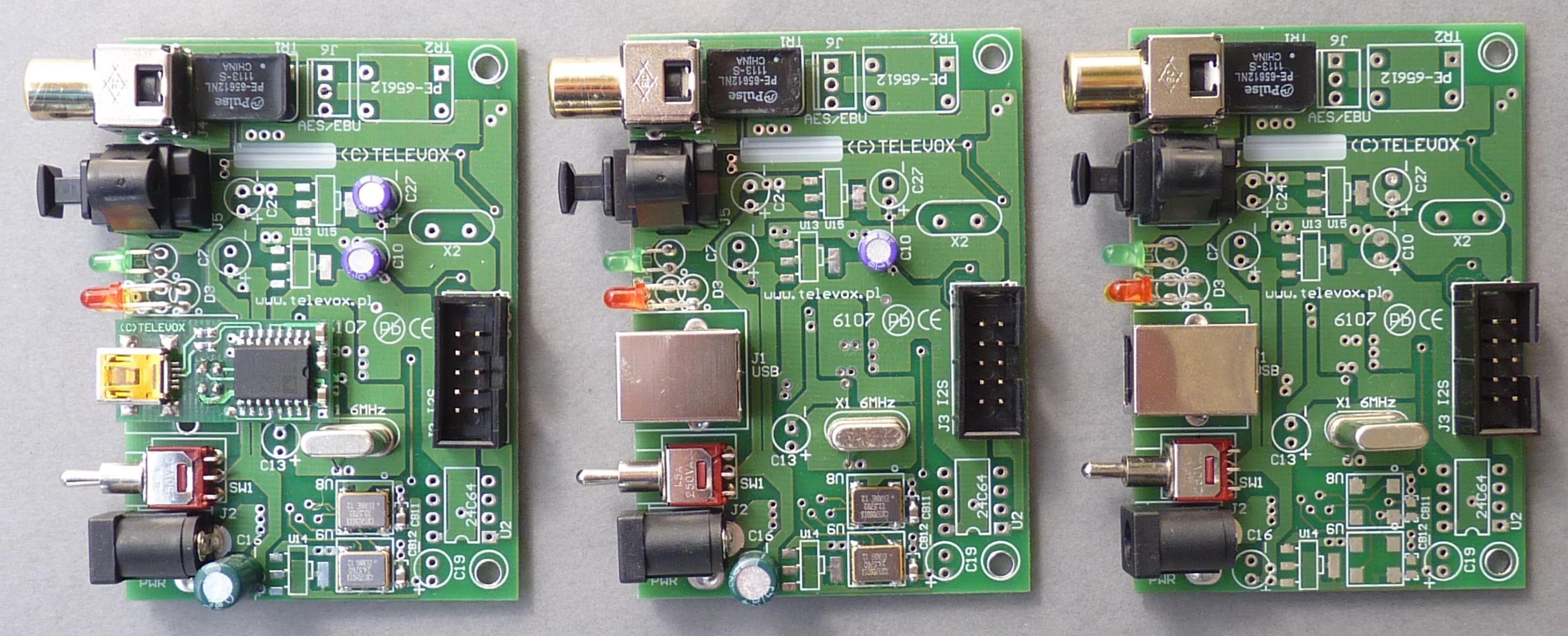

Hi All,
I received a new batch of PCB (15pcs), all previous (about 20) been used by Polish DIYs.
I finally found some spare time to assemble a few pieces of converter.
The biggest improvement over the standard version (Stage1/2) happens after adding external oscillator and external power supply.
Adding galwanic isolation gives subtle changes.
The current version is 1.01 for I2S/SPDIF standard and 1.02 for version with external oscillators.
Achematic is available inn first post.
Several people have asked me about costs:
USB to I2S module (STAGE1 specification, assembled & tested)
cost about 44$ + shipping (about 7$ in EU)
USB to SPDIF(COAX+OPTO) module (STAGE2 specification, assembled & tested)
cost about 60$ + shipping (about 7$ in EU)
Options cost:
-external oscillators + (additional parts) 25$
-galvanic isolation module 18$
But I can assemble only 4/5 units per week.
I solder converters by hand, I need about 2 hours to assemble one. I do it in my leisure time.
Sometimes I have to go on business trip.
On fist photo (from left) :
1. SPDIF(COAX+OPTO) + OSC + ISOLATION
2. SPDIF(COAX+OPTO) + OSC
3. SPDIF(COAX+OPTO) standard
On second photo: galvanic isolaton module
Best regards
JarekC
