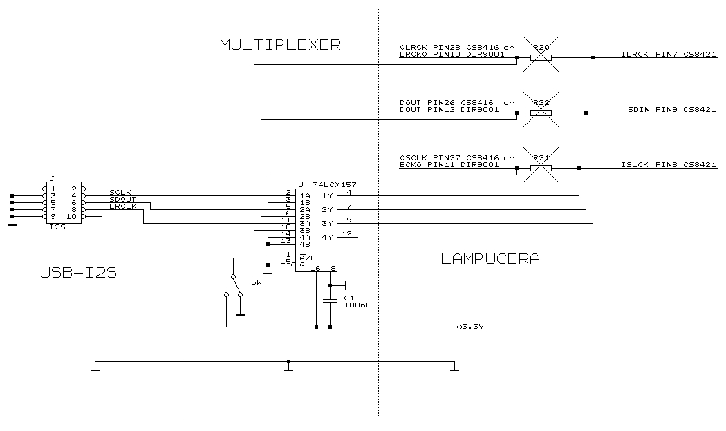

I got a question how to connect the USB-I2S converter to DAC Lampucera Maxi (DIR9001,CS8421, PCM1798).
I think I think the best solution is to use multiplexer and connect I2S signals before CS8421. Simply remove R20,R21,R22 and connect according to the diagram.
74LVX157 can be replaced by signal relay or mechanical switch.
I have plans to redesin PCB:
-separate LED for each FS
-add multiplexer for I2S signal
-smaller PCB for USB-I2S version
Best Regards
JarekC

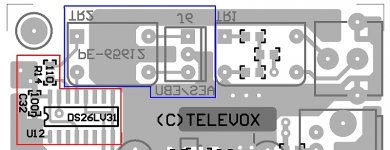

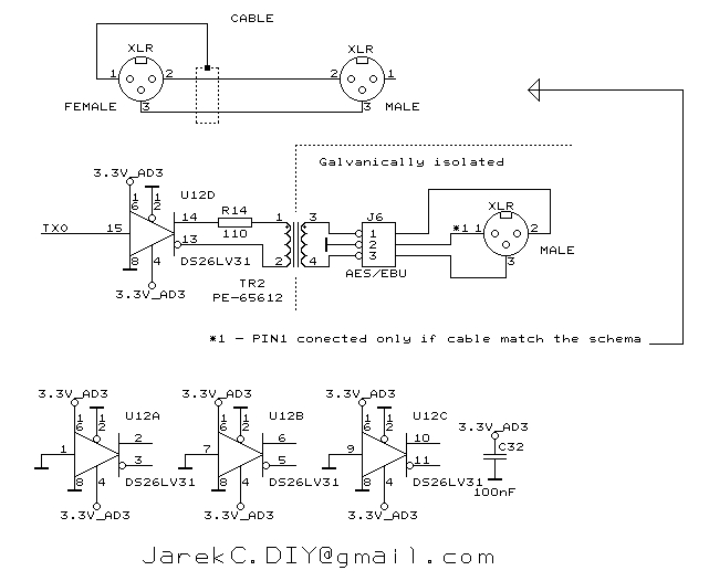

Before new PCB project, some information about AES/EBBU output.
Current PCB is ready to add AES/EBU output.
You need add:
- integrated circuit DS26LV31 SMD (U12)
- resistor 110Ohm SMD0805 (R14)
- capacitor 100nF SMD0805 (C32)
- transformer PE65612 (TR2)
- XLR connector
Components R14,C32,U12 mounted at BOTTOM side (RED), a TR2 at TOP side (BLUE).
XLR conected to J6
Details are shown in the drawings and schematic.
(Testetd by several DIY users)
DS26LV31 can be replaced by ST3485 (simple modification on PCB).
JarekC
