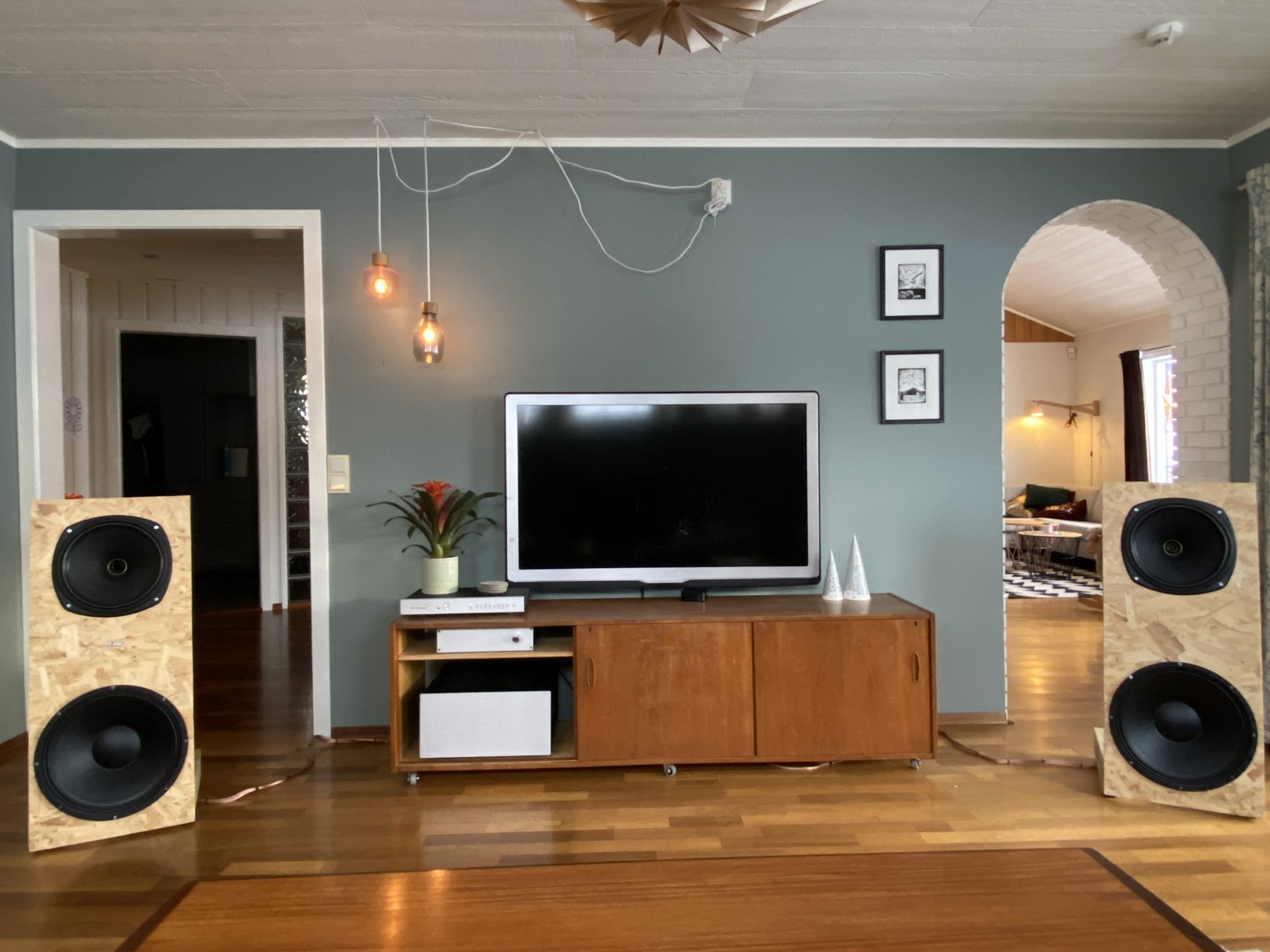

I only finished one speaker
silly Vikings

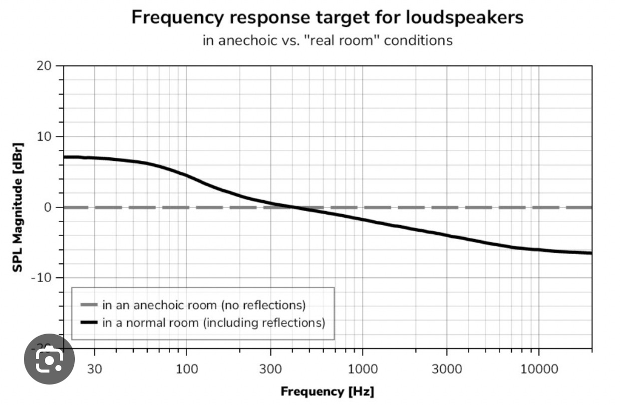

I should add MZM and several others have detected the need to take the tweet a bit down. These were PA drivers, and so tuned up in the treble. And in a living room the overall balance can be a bit off, but that will of course depend on many factors, including personal preferences.

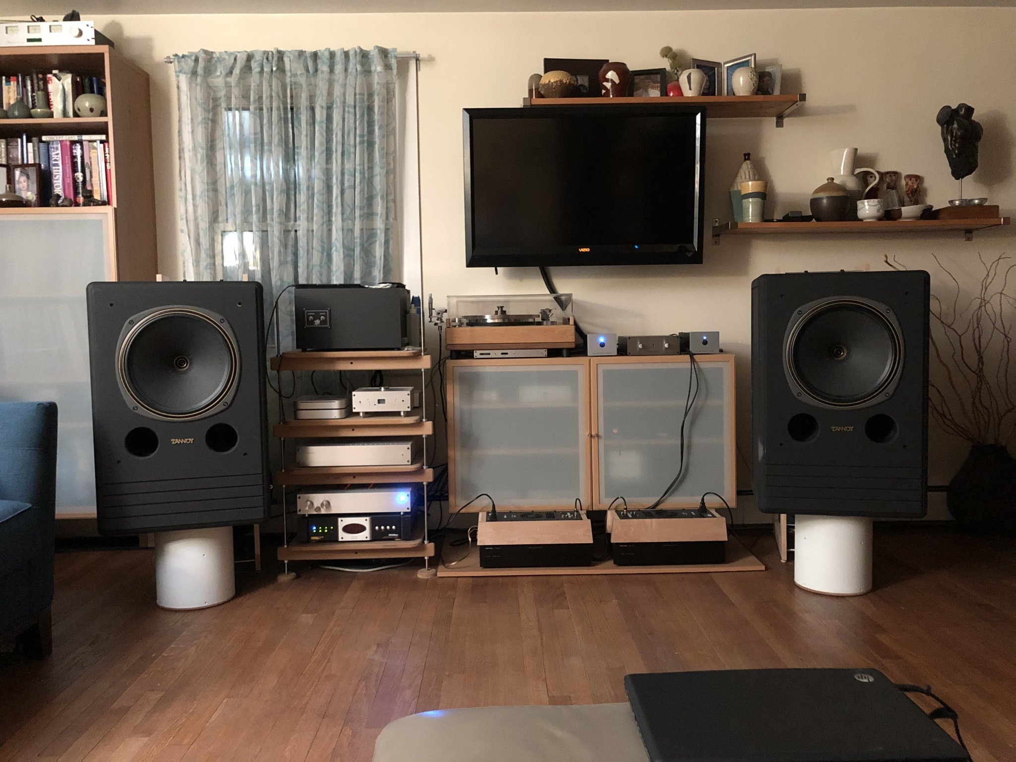

I don’t claim to know squat about what’s good/bad/better regarding Tannoy and their different vintage drivers.
I’ve lived with a pair of System 15 DMT II for about 3 years now and have done a lot of experimenting with different amps driving them…ACAs, LM3875 chip amps, 80W Rotel HT amps, F2J, VFET, Babelfish J2, Quicksilver Horn Monos and 500W Hypex amps.
I just threw everything I had at them for the experience.
There was nothing special about driving them with the 500W Hypex amps.
They were anemic with the ACAs and the F2J is not the right amp for this type of speaker…even though it may be one if my favorite amps.
My Babelfish J2 amps sounded very good with them, but they are a mismatch for my tube pre in my main system and I like using my DCB1 more with my F2J monoblocks in my second system with a variety of fullrange drivers in horns or on baffles.
In the end, the best sounding combo I had in the main system with the Tannoys was my Quicksilver horn monos driven by my Audible Illusions 2D preamp.
The Quicksilvers are a very quiet push pull and only25W…which is perfect with the very sensitive Tannoys.
The sound levels I can achieve with them is down right scary.
I can play any kind of music I’m in the mood for and they sound remarkable.
I’m looking forward to trying the DMT 3833gg drivers in a transmission line eventually as well as playing with bi amping and the eventual completion of a new pre that works better with the J2s.

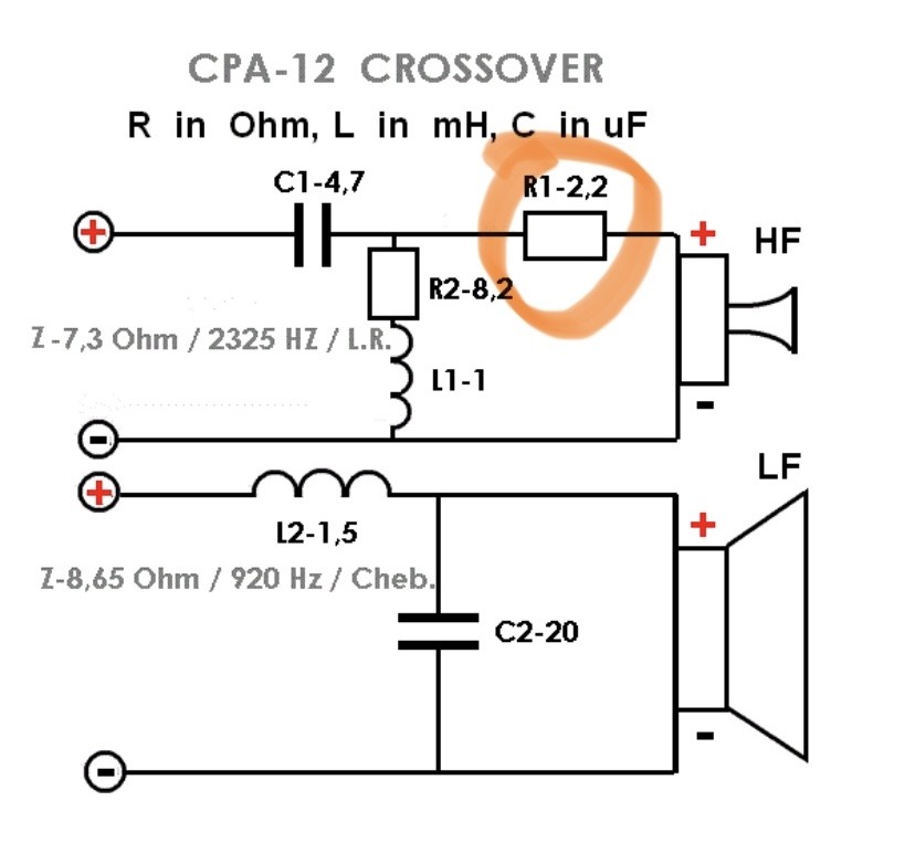

Try the F2 with a tad of attenuation (notch or whatever) in the impedance rise area @ the crossover point. I pulled them down 2,5db centered at 2100hz, gradually down to 1,2k and up to 3,5k. Then add 25 ohms across the amps terminals to achieve approx a damping factor of just above 1. Sounds pretty smooth in the highs and mids, but dynamics and bass is perhaps not the best. I just added a 15” to the mix and it is pretty nice.I don’t claim to know squat about what’s good/bad/better regarding Tannoy and their different vintage drivers.

best results so far is with a BA-3, running all three drivers from the same amp with passive XO’s.
All new parts for the original Xo will soon arrive. Tip of the day: rip out the 4u7 cap in series with the tweet and throw it away, replace with anything.
Yes. Even with a choke Got hold of 2,5mm2 chokes to replace the old ones, and fancy non inductive resistors. For the paralell cap on the woofmids I chose a pretty regular xo cap. Parts supposed to arrive yesterday, but weather hinders most things nowadays. In the meantime enjoying tje latest Iq settings on the BA-3. 1A per device and 50% increase in FE bias yet again, with a very different PSU an lower rail voltage, makes a remarkable difference.
