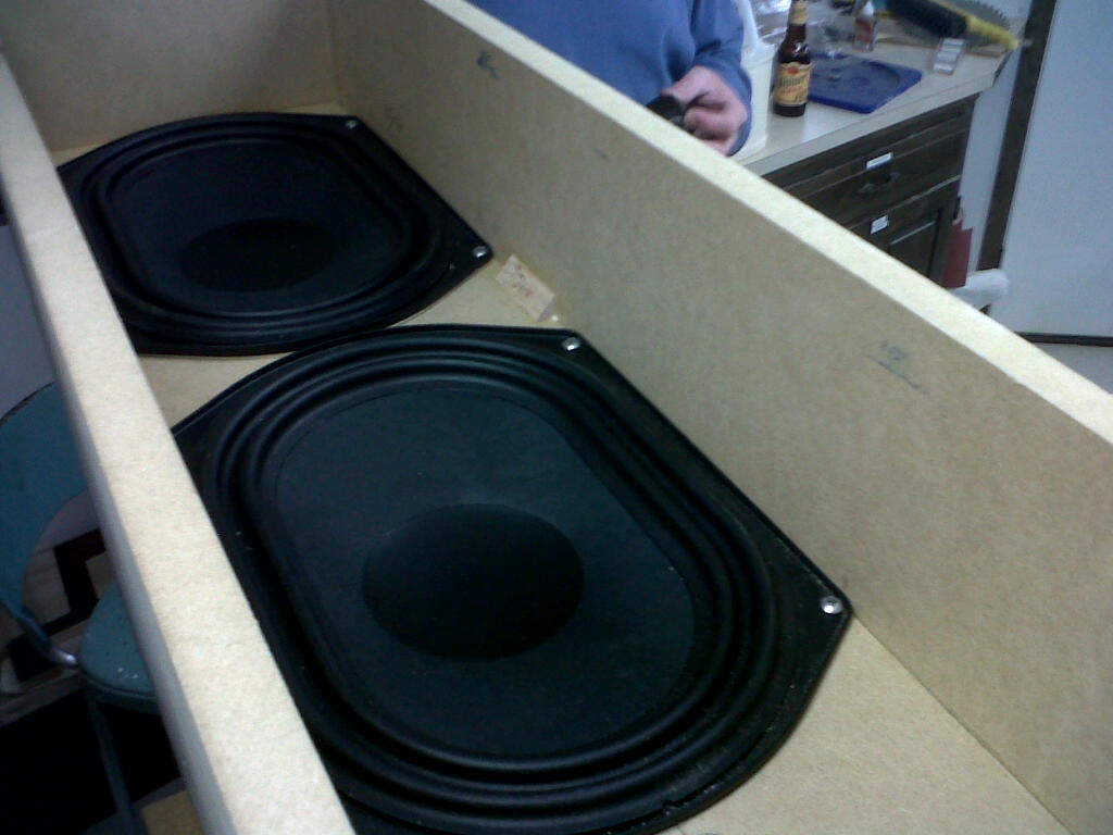

What I have traditionally done for the gasket seal on the drivers, which has worked amazingly well for me, is to take a bead of hot glue around the backside of the driver frame and let it dry for a day. Then when you mount the driver it makes a rubber "gasket like" seal that is airtight and also makes the driver easily removable. However, I did buy some of the adhesive backed foam, and I may just go that route.
I just took the spec sheet for the driver, which has a series of measurements on it, and drew a template out on paper and transfered it to the panel. I can "digitize" it later tonight.

I like the hot glue trick, will have to try that. 1 1/2" x 8 5/8" does make for one stout board, doesn't it?

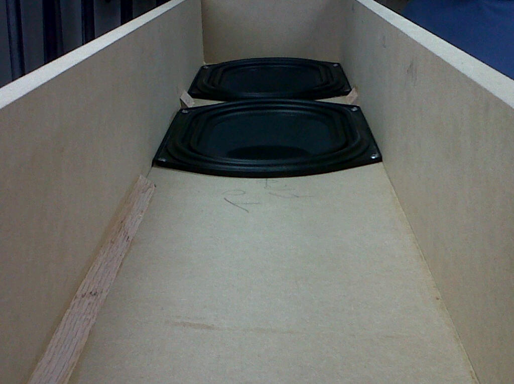

It is amazingly stout and I am so glad we went that route with it. I found out last night that the hydro press was set at 6000 PSI to sandwhich the boards together. We actually cut them big, sandwhiched them together and then cut them to length and width so they are perfect. It acts as one large thick board. Actually, after seeing how robust and tight the entire build is, I am thinking that there won't be need for much bracing. Near the drivers and I will put some reflectors in...that might be it.

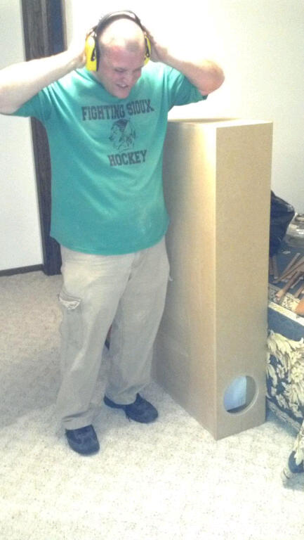

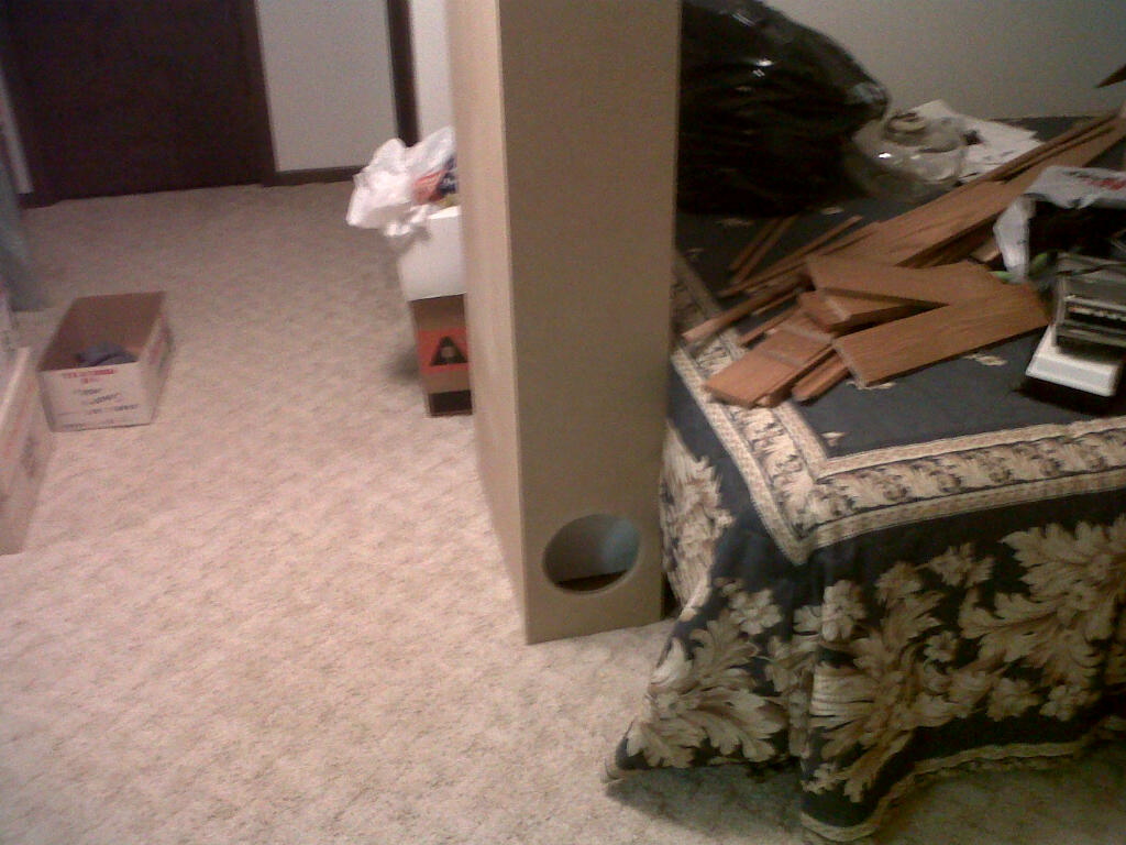

Looking good!! Used dremel circle attachment to cut exact hole for S4, we measured and we are off of perfect square by 1/64 of 1 inch. I would say it is perfection. We have the front and rear panels temporarily in place, deciding what medium to use to seal them and yet make them removable.

It's all thanks to you and Bjorno. I can say for sure, that I have never been involved in a project that has been so well planned and executed. Do you have any reccomendations for covering the circle opening?
I am just trying to understand more of the functional principle of what I just built!
So the rear wave of the speakers travels back until it hits the S1 area and then is "re-routed" back through the horn until it realigns with the front sound wave and exits at the S4 opening? Tapped horns don't have a blocked path, so to speak, so I am wondering what the difference in design theory is.

I see the T-TQWT as a member of the family of tapped horns/pipes/tubes/ transmission lines that has been made accessible through the work of Joerg Panzer (AkAbak), David McBean (Hornresp) and Martin L. King (MathCad acoustical spreadsheets). The basic TQWT seems to go back to the Voight pipes (with a more normal horn taper). The initial idea of recirculating the sound from the rear of the diaphragm to the front by means of a tube seems to go back to the Jensen Transflex. Without simulation software the whole thing is almost impossible (I can attest to that from trying to recirculate transmission lines in the mid 1970s.); at the very least you end up with a lot of fire wood.
I find the descriptions in Danley's white paper (and his patents) on tapped horn and synergy horn technologies is a good starting point.

The finish depends so much on where and what.... I've used just about everything from latex and acrylic paint to 1/4" plywood (ash looks-and finishes-nice) with edge trim to burlap. You can always round the corners, and paint it black.
Maybe a grill for the opening:
http://www.parts-express.com/pe/showdetl.cfm?Partnumber=260-424
and, some vinyl speaker covering:
Vinyl Speaker Cabinet Covering Black Bronco Yard 54" Wide 260-760
