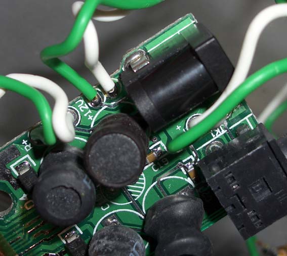

- here is a picture of one speaker soldering as well as the power in soldering.

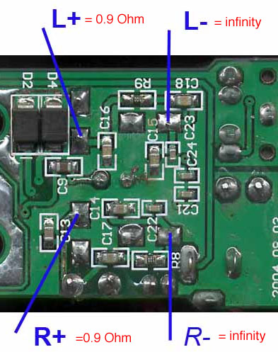

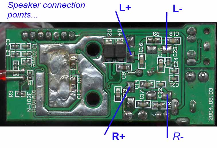

audio1st:
see the picture for results..... so no wonder I have no output signal, correct? I should probably try to connect the negative side of the speaker to the points labeled L- or R- on your picture?

stephanko said:
Question: As I was pondering this.... I realized I only soldered the speaker wires on the bottom of the PCB. Could this be the reason for not having any continuity? Should I try to solder them on the top side of the PCB as well?
Yup, if you look closely at your board you'll see that the - is only connected on the top part of the board and + is only connected on the bottom side for the R connectors. And both only on the top side the L connectors but I guess you just lucky getting the plus one to work. I assume you soldered the plusses first.
so it holds true one more time..... if you assume you make an *** out of U and ME. My (false) assumption was that the the top and bottom side of the PCB (looking at a single hole) are contacted through...
I will heat up the iron....... and keep you posted (hopefully with good news)
