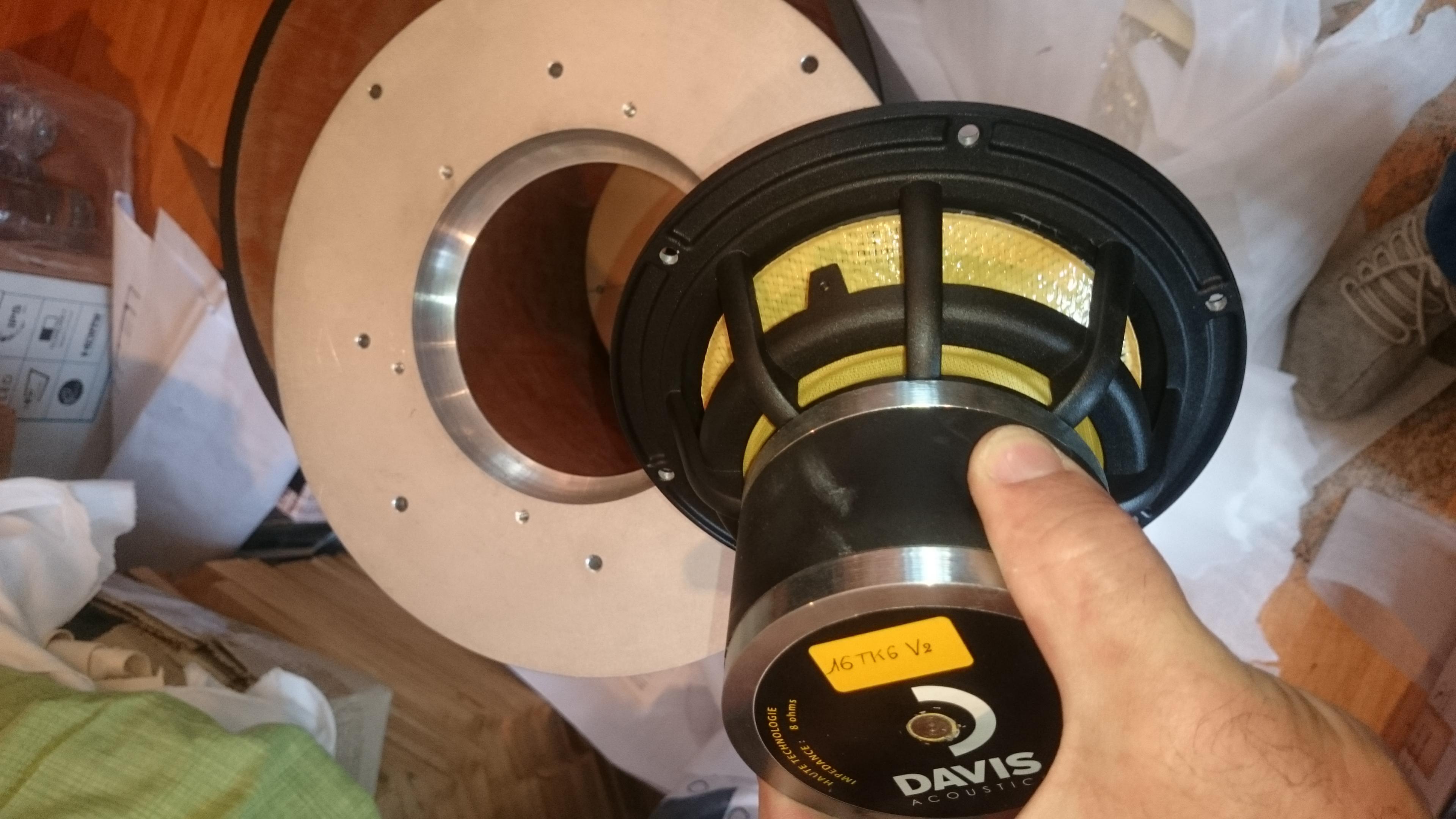

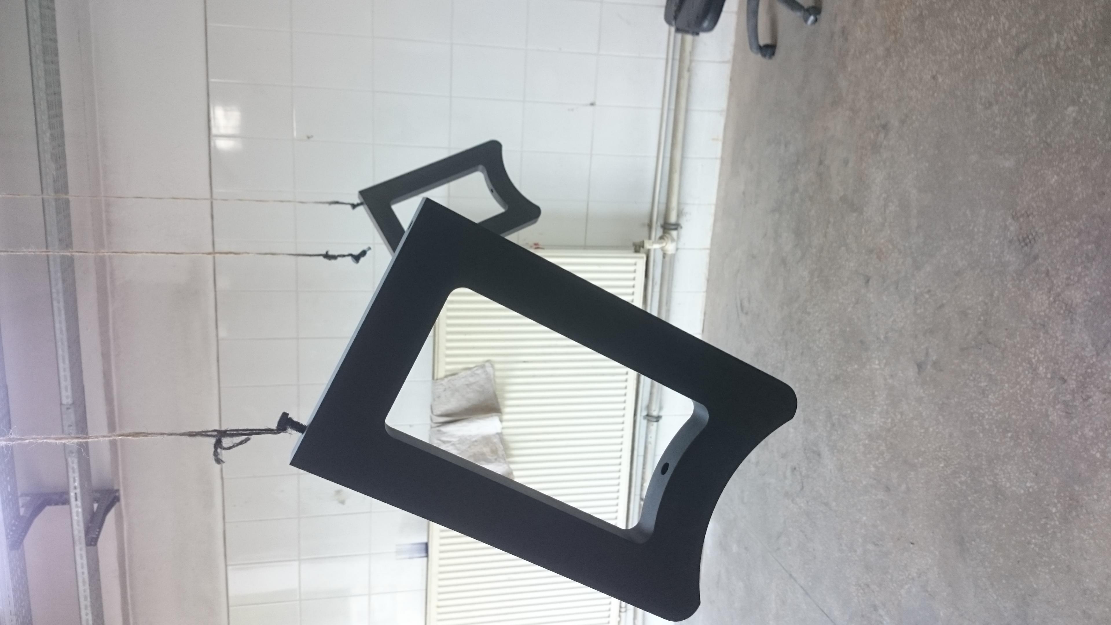

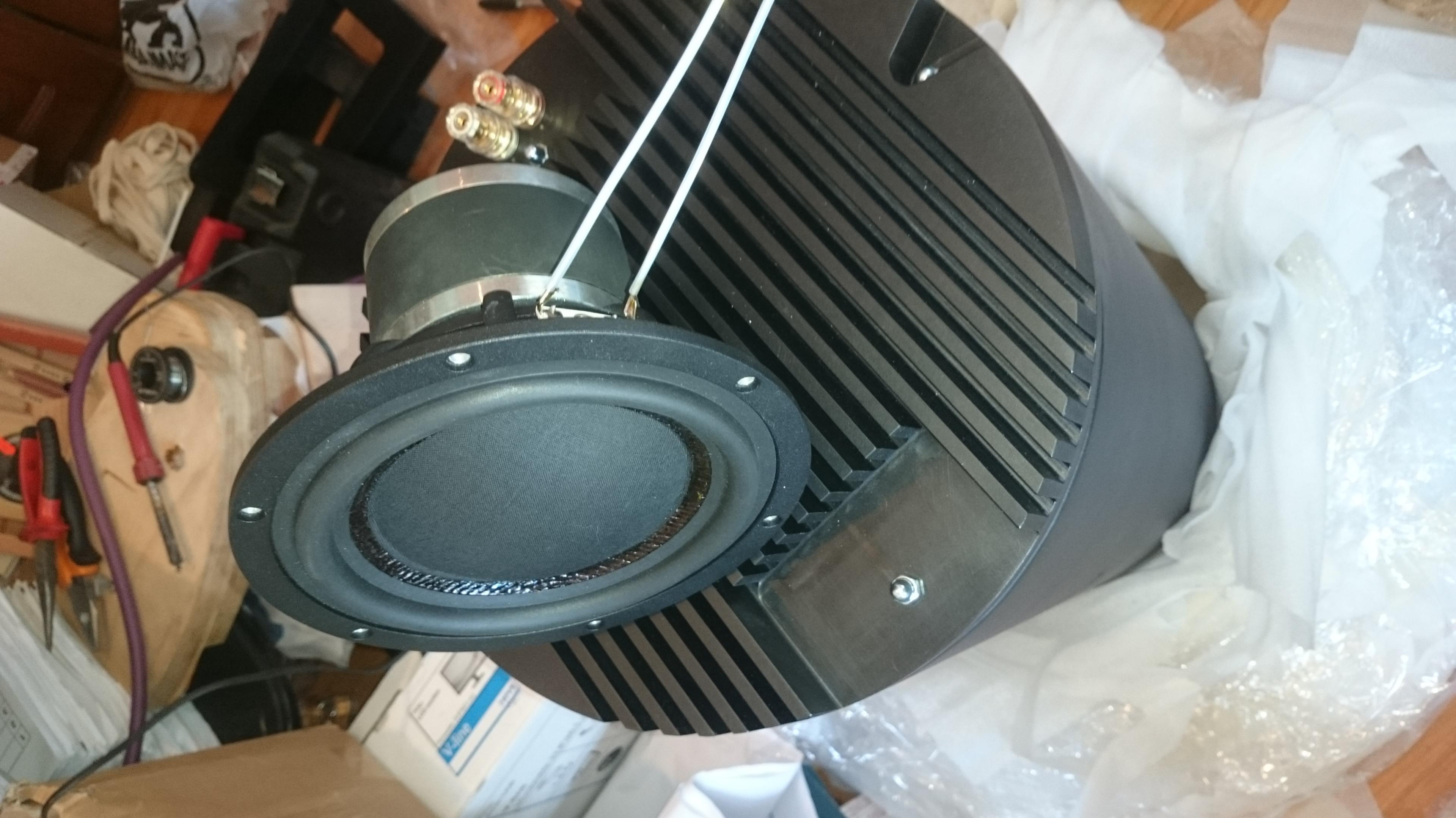

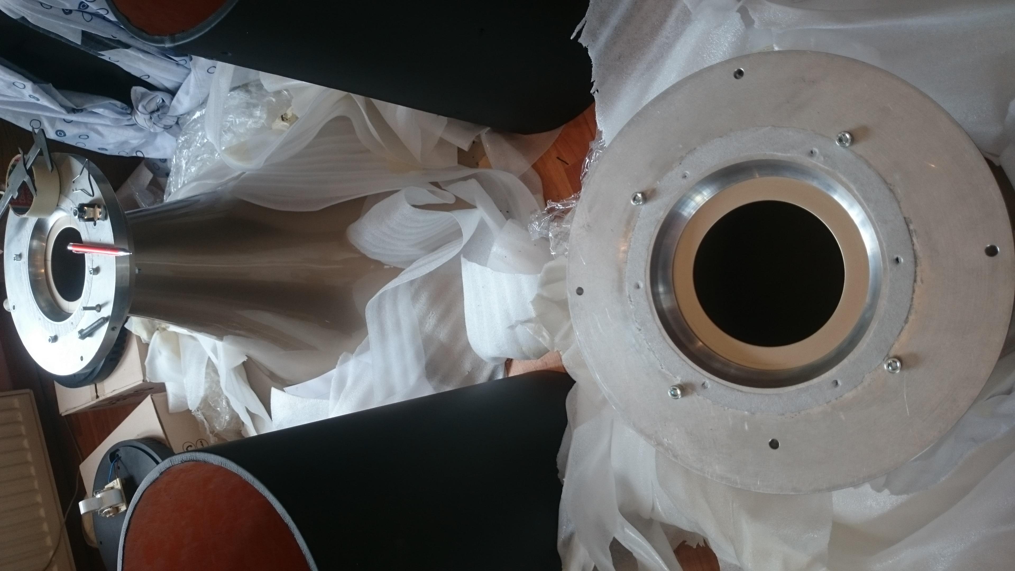

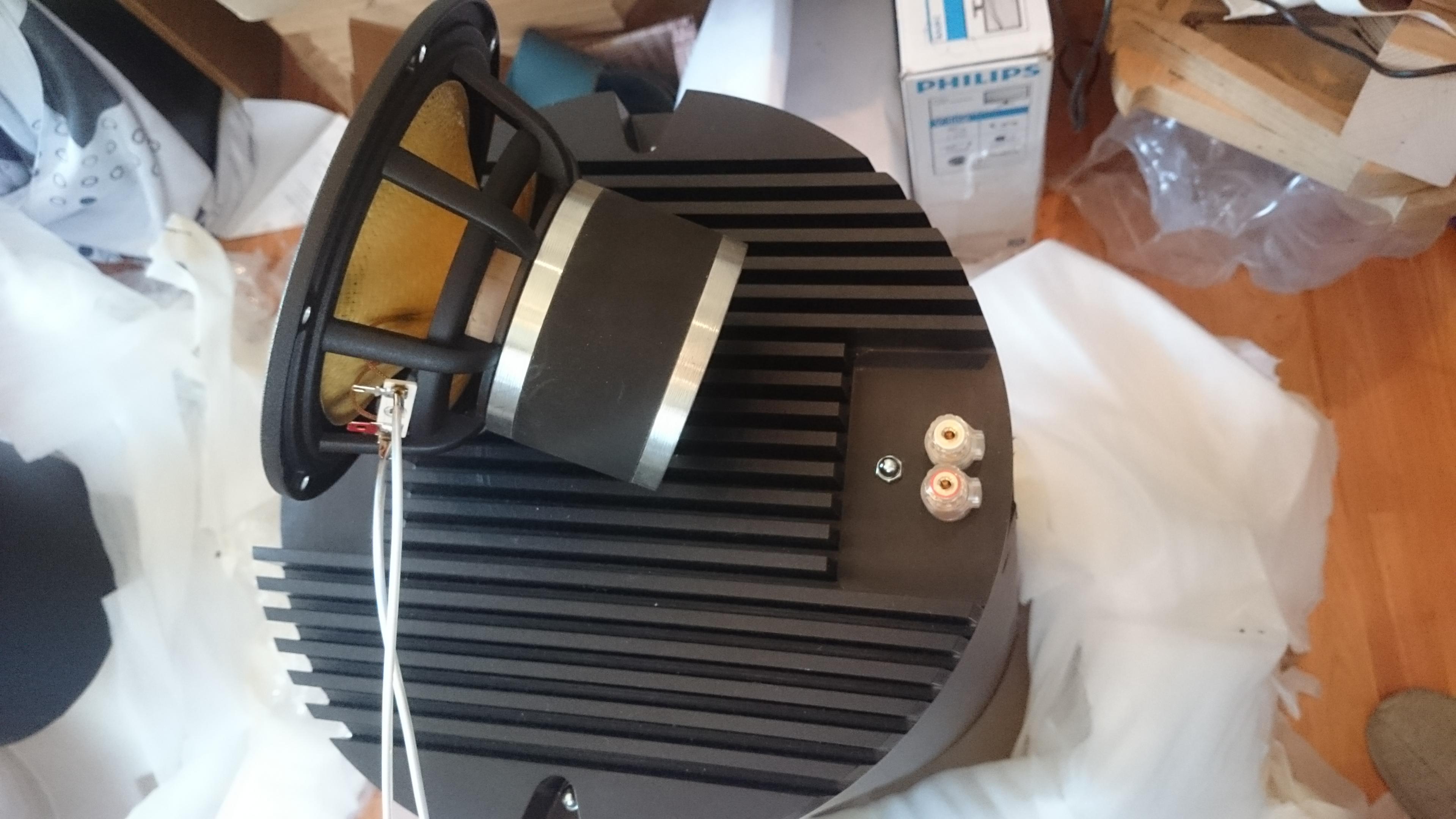

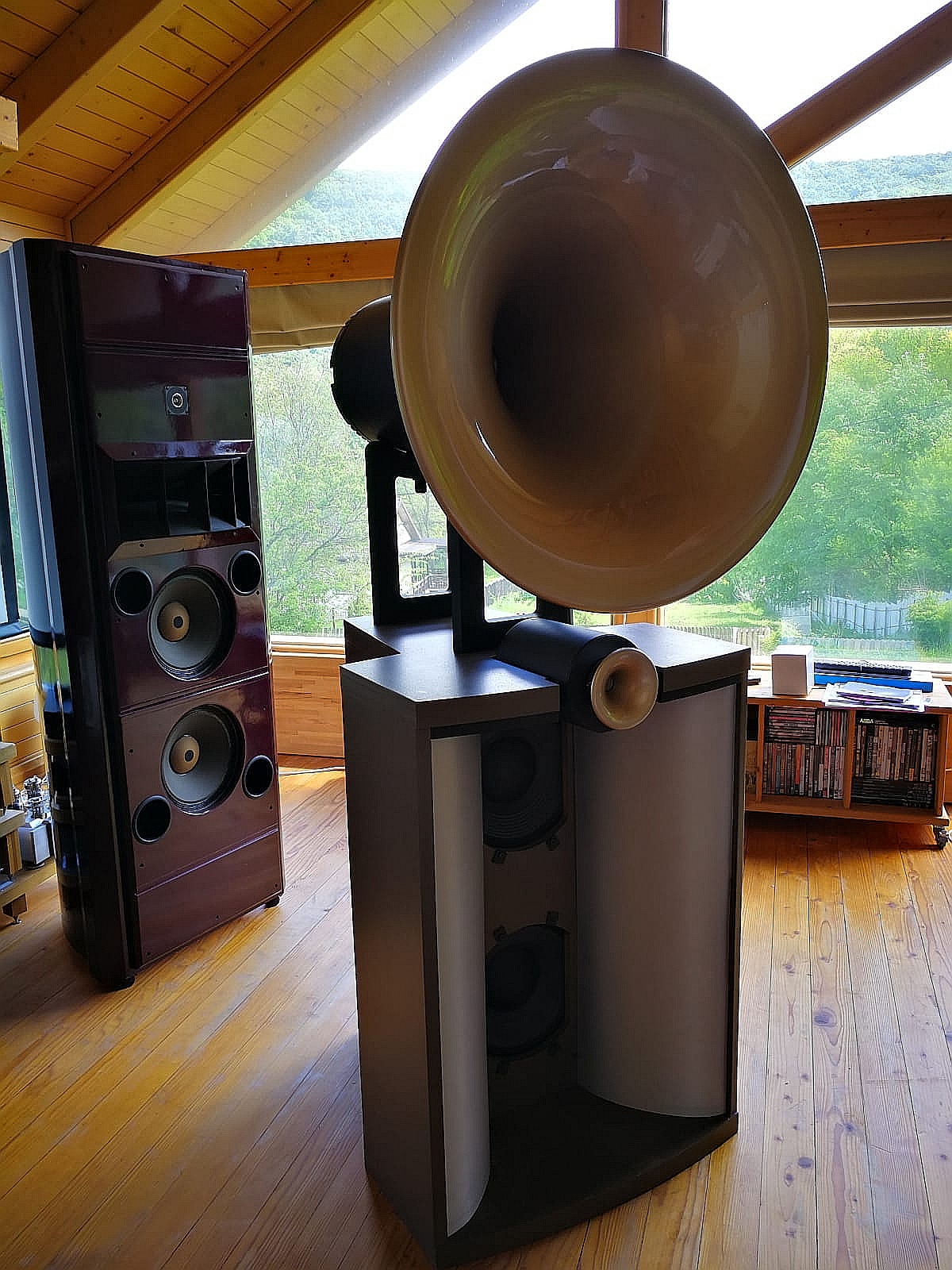

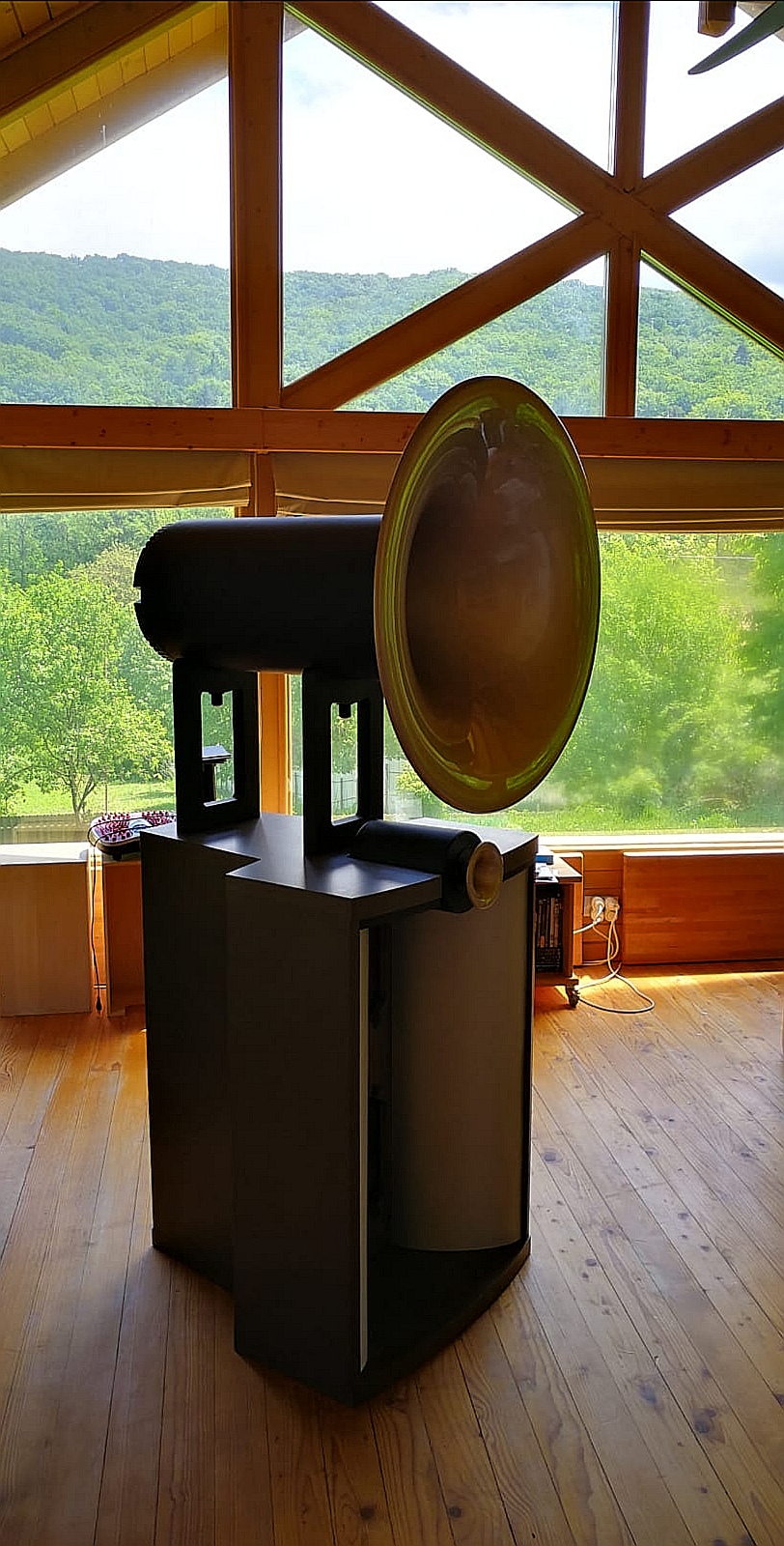

In the back are previous speakers ....also DIY....Altec 414/811/806/ Fostex FT96.

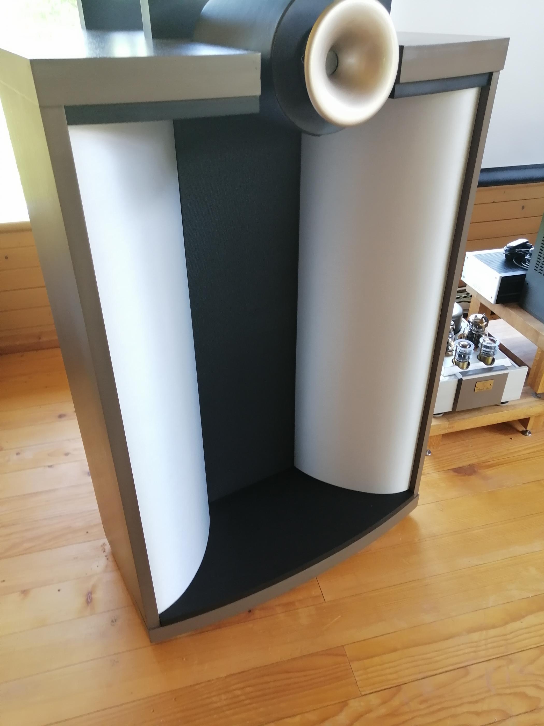

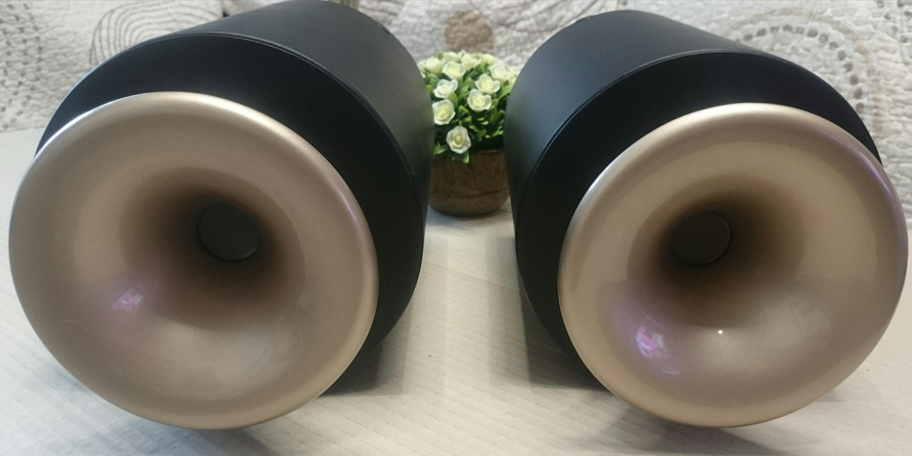

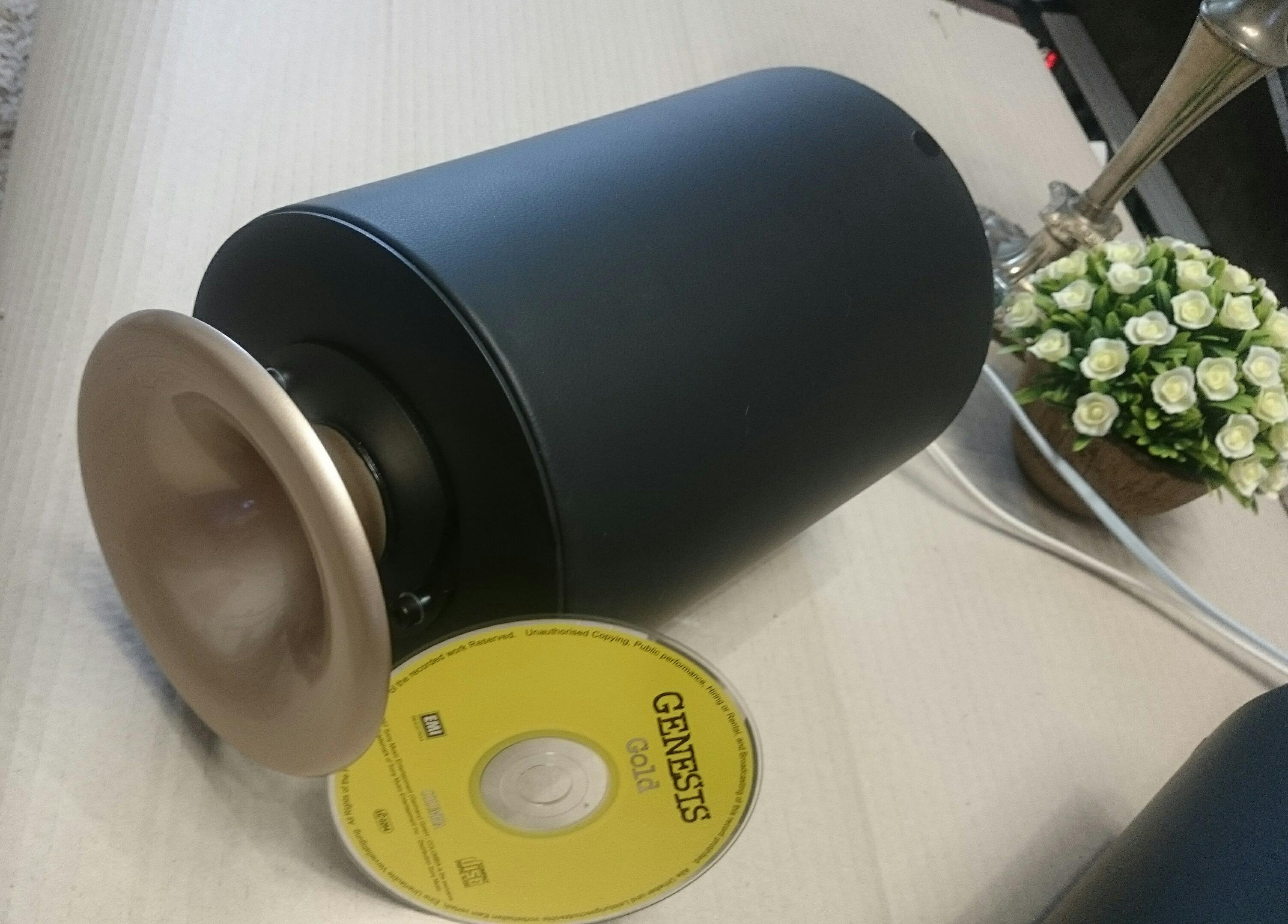

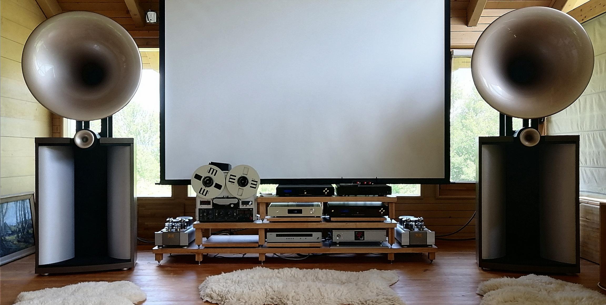

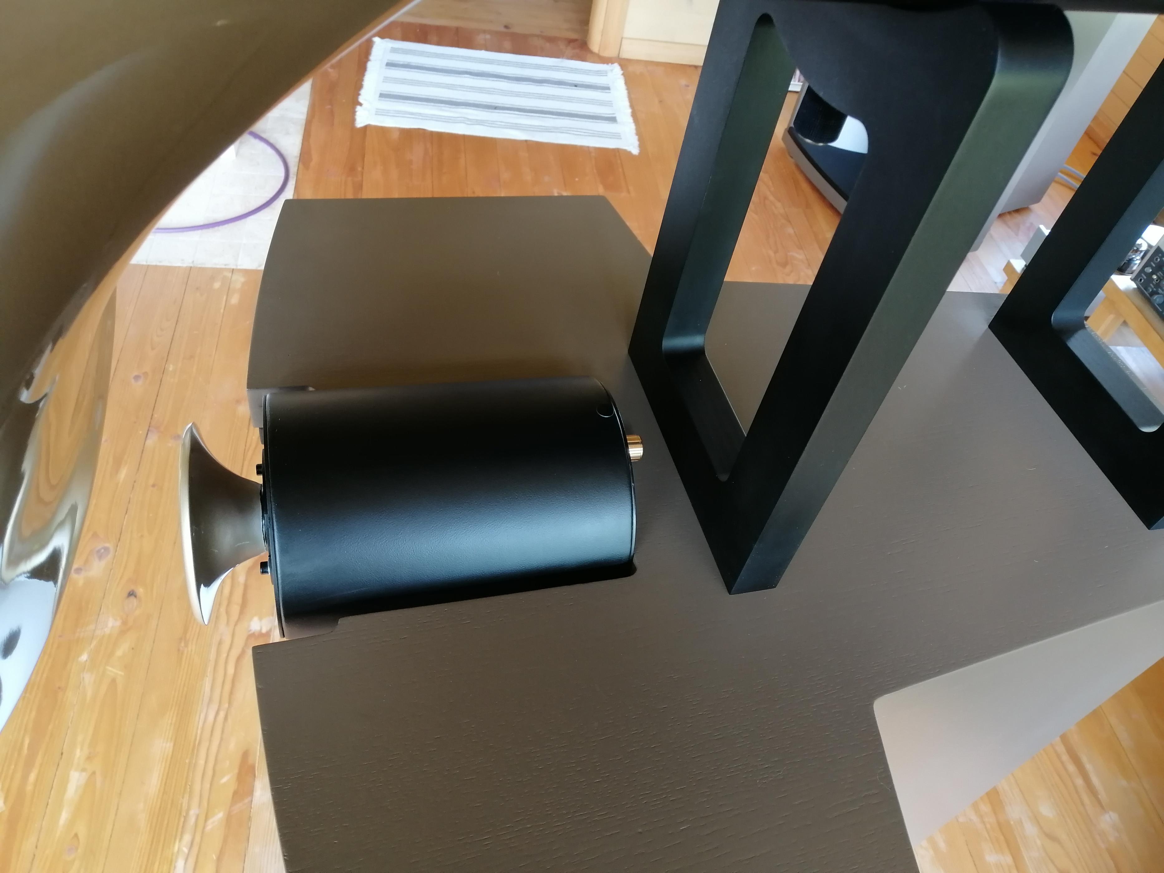

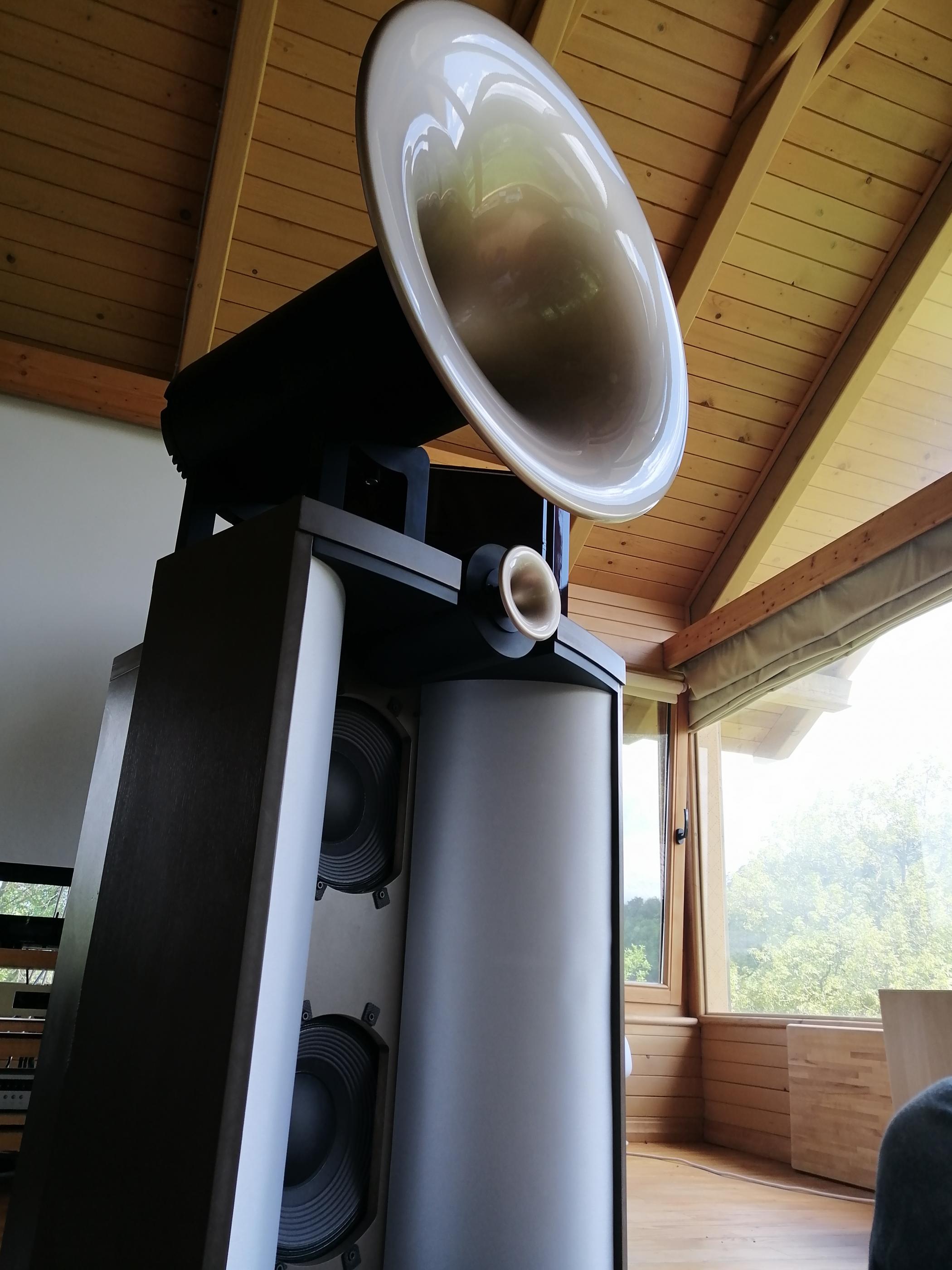

I made it both for a client.
Alot of work and time to do that right.
Like Duo Mezzo I use active on Beyma woofers and passive on Davis.

^ LOL! :D
Yeah, it's exceedingly impressive work. :cool:
When looking at it - it looked MOSTLY like the Duo.. BUT the top horn looked larger (and perhaps the entire loudspeaker looks larger); also - the base (near the feet) looked a little different.
Still, it was so close that I was having a really hard time thinking it wasn't a Duo. :eek: :)
Astounding "fit and finish" for anything DIY (..or really, anything at all).

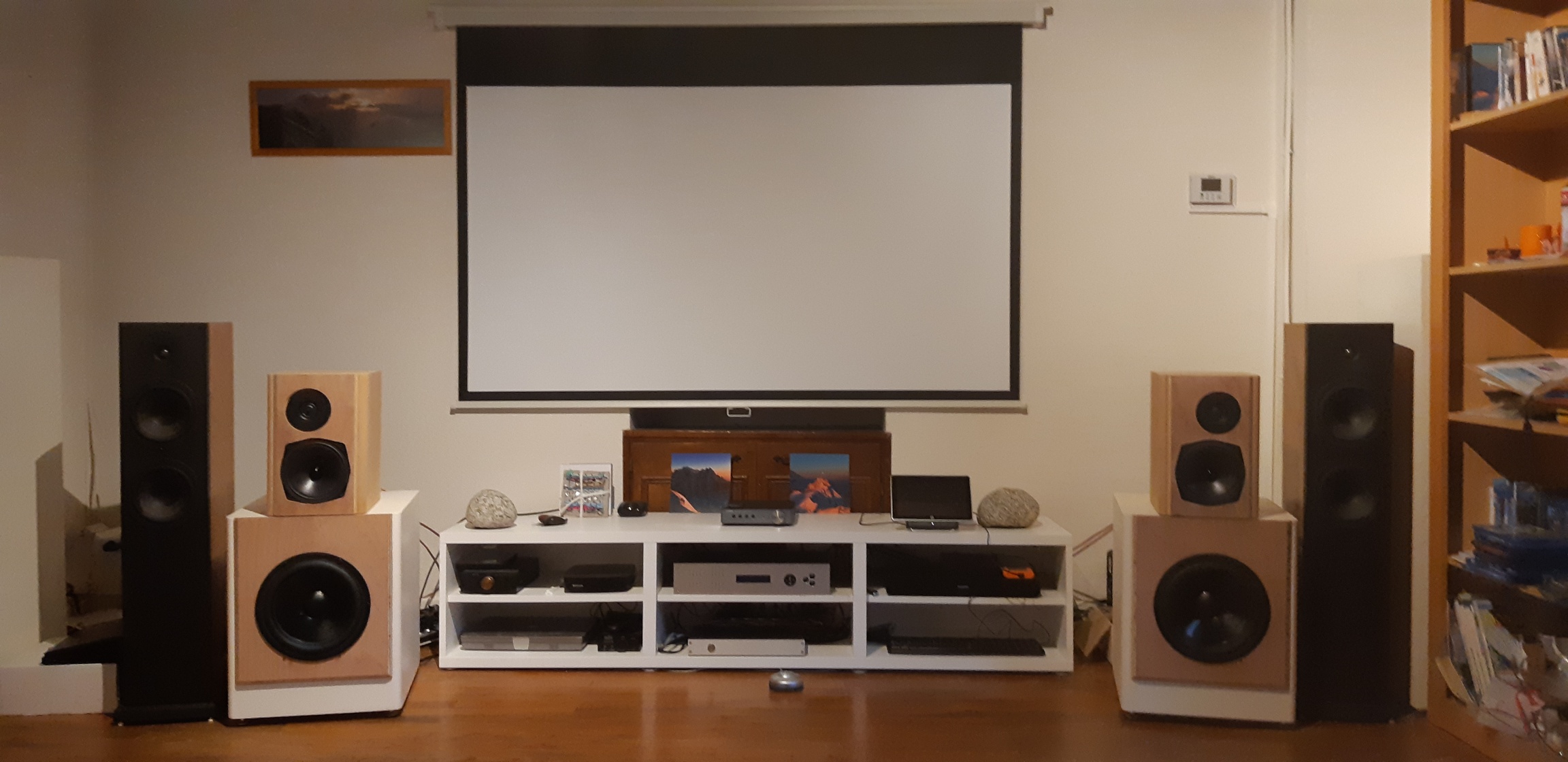

Active 3way : Seas 10" PHL 6.5" Scan Speak 1"
I had my Najda DSP used only as a preamp/source selector for years, now I've gone to a full active setup : Seas CA26RFX - PHL 1280 - Scan Speak R2604-8320.
Mid and tweeter are powered by IcePower 50ASX2, bass section by a Hypex plate amp. I've reused an existing 65l sub cabinet for the bass section, boxes are not already finished but all is sounding VERY GOOD IMHO. I was pleasantly surprised by the sound quality of the tweeter and the bass section consdering their price :). Crossover LR2 accoustic at 250 Hz and 2100 Hz + delay on tweeter.
