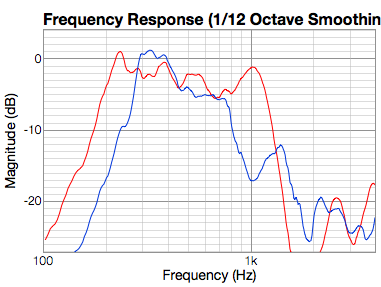

I suspect that your midrange woes have to do with the M10 driver. Here are some of my measurements on a 90x45 degree horn. The mid is ported into the horn wall at about 2.5" (need to double check that) from the 1" compression driver entrance hole. The port hole is 1/2" through 1/2" plywood. The red trace is the Misco JC5RTF. The blue trace is the Visaton M10. The big notch at appears to be caused by cone flex. Those who have seen the M10 in person can see that the cone is very flat which means that it tends to flex much easier than a cone with more angle.

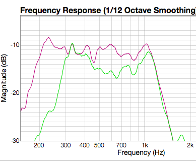

In an effort to fix the problem I did some experimenting. The red trace is an M10 driver with one coat of shellac applied to the cone. That yielded very little change. So I glued a mesh layer to the cone with more shellac and saw some change.
I have to agree. Every driver Ive simmed seems to have a somewhat better top end than the M10, not that Im an expert but there does seem to be better options out there.

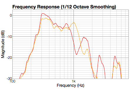

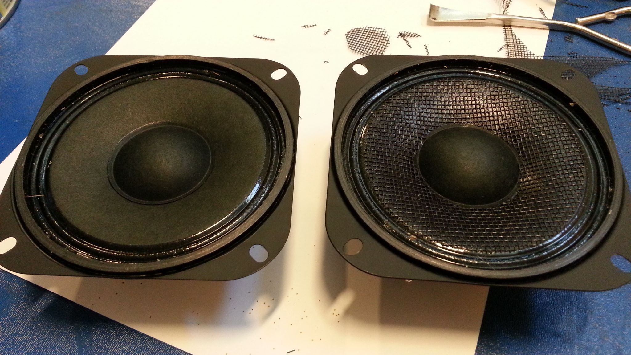

Well I'm not sure the M10 is a lost cause… if you modify it. Here's a comparison of the Misco vs the Modified M10 with the mesh screen shellacked on the cone. The sensitivity is not the same but if you adjust for it, the M10 does reach a pinch higher than the 5" Misco. It should be noted that the cone area of the M10 is about the same as the Misco even though it is a much smaller driver over all. The very narrow gasket border around the edge and minimal surround means you can get it in pretty tight to a compression driver. And I don't know that my modification is the best one that can be done. A fiberglass/epoxy treatment might yield better results. And lastly, remember that my measurements are from a test horn with one 1/2" hole and no frustum. I would expect the lowpass to bump up a bit with a larger hole and some hollowing out on the backside.
Misco is purple, Visaton is Green.
And before and after:
