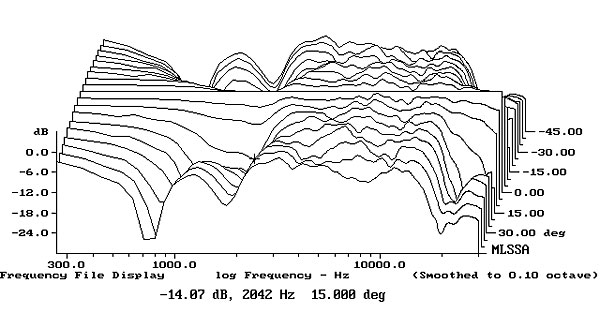

That curve is representative of any side mounted driver including the mid drivers you speak of but also the woofer response looks like that (but in a lower frequency band).
In the modeled response, the cancellation notch i mentioned that limits the upper end of the response is obvious as well as the "low pass" acoustic filter formed by the trapped air volume and port mass. Within the band pass range, the response is that one would see if the horn were driven normally at the end. That acoustic low pass filter reduces the harmonic distortion all drivers produce because that falls above the normal operating band.
By choosing the band passes appropriately, one can overlap each section so that you drive the single acoustic path continuously over a much broader bandwidth and with the proper crossover, as if there were only one driver.

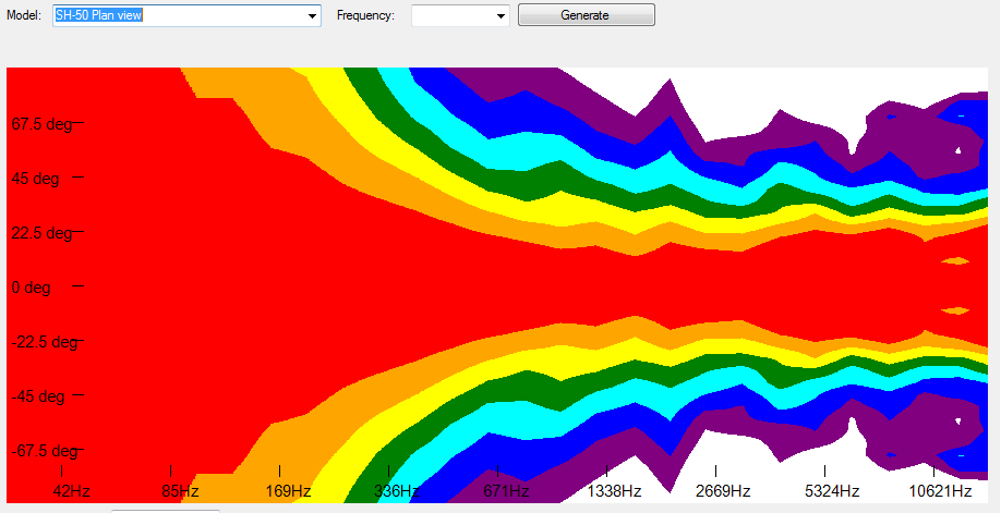

I had asked our programmer to take the 3d polar balloon from the an SH-50’s CLF data and plot that as a map like some hifi speakers use (attached). Note this is a full bandwidth (30Hz to 16kHz) data plot with 3 dB per color division. If you compare that to hifi speakers you will notice the pattern control extends down much lower in frequency than normal. Much less energy is projected 90 degrees off axis or elsewhere outside the pattern.

That is not a particularly high resolution polar map and it is normalized, which deforms everything anyways, so its kind of hard to tell, but that is not a particularly good polar map for a Hi-Fi speaker. At least not ones that I am used to hearing. Its directivity control does go very low, but as we both know that's all a matter of size. And in a small listening room it is not as critical to go low as it is in larger venues.

It isn’t super “high resolution”, it was derived from the data taken by an independent company that does all of our 3D full spherical measurements, at 5 degree increments at 7.4 meters distance, it is already a lot of data points to take. I asked our programmer to take the CLF data file and plot the H and V planes in the Map style which is popular in hifi. What one can see is that the level going at say 90 degrees off axis is -20dB or lower down to a fairly low frequency and like you said, it is size dependant but also lacking the lobes and nulls of most conventional multiway speakers is a help there (the SH-50 is a 3 way with 7 drivers).
I do not know where the point of diminishing returns is so far as minimizing off axis energy in a living room however but I do know these project less than any of the speakers that Floyd Toole examined.
Like they say, the simplest thing that does the job is usually the best and if I were sitting in the very near field or outdoors the amount of directivity is irrelevant. Up close, I have heard an EQ’d accuton driver on a large flat baffle which worked remarkably well and like the Synergy horn, had very little spatial identity; one could not easily tell how far away it was when your eyes were closed and playing a soft voice.
Understand too it is possible to make them very “flat” (smooth) with more crossover parts , as much as I would like to make a hifi version and hifi (home audio) has been my hobby since childhood we don’t yet. Even when I get the ok, these won’t be for everyone, they will never be small loudspeakers though and even a modified SM-60 which is my best bet now (measures + - 1dB deviation) , isn’t small.

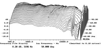

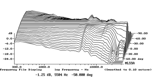

Ex.'s (Horizontal and Verticals of the Revel Ultima Studio and YGA Sonja):
