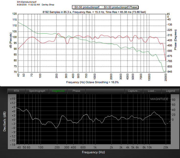

Caveat: this is entirely limited to what I've seen measured, and certainly doesn't characterize all (or perhaps even most) of Tom's extensive line of Synergy's..
1. As mentioned - the most obvious is the not great freq. linearity - and not only on-axis, but any given axis. From what I remember deviations are "coarse" when compared to more uniform designs (that are within +/-1.5 db), particularly in the upper mid and lower treble where only .5db deviations are easily audible.
I have no idea what kind of bionic ears you have, but even +/- 1dB is not audiable to the vast majority of people. Look up the definition for a dB in regards to the audibility threshold.
2. The directivity isn't "uniform".
Direct radiators have a narrowing of directivity as frequency increases. That's not uniform either. I guess direct radiators get a free pass.
3. The design relies on compression.
Compressing the polar response (or increased directivity by means of a bounding waveguide) as freq.s increase usually generates two subjective artifacts: reproduced sources or "images" usually move forward and venue effects tend to become less pronounced (relative to those images). The former isn't necessarily something that is "bad", in fact it can be "good". If most images are "pushed into your lap" it's certainly bad, but in the case of comparison with the lower freq. compression, (driver not polar), found in many traditional loudspeakers (that ONLY push lower freq. images forward - like drum kits), the result *may* be better - by maintaining a better depth distance between lower freq. images and upper freq. images. I'm guessing that Tom's designs are in this case "good" - even if somewhat forward overall, and as a matter of preference may be "better" (in that some prefer a closer "auditory scene"). However.. a reduction in venue effects relative to images as they relate to upper freq. effects almost always occurs to some degree (..literally in this case). Additionally, it's not uncommon to have a reduction in lateral image placement (or horizontal image "squashing" - as if sources moved closer together laterally). Typically however this is compensated for by moving the speakers further apart, but this has a further negative effect of lowering the impression of lateral venue effects. (i.e the images have a wider spacing between them, but the venue's side-walls become less apparent and often move closer together). Of course most of this does NOT apply with ambiophonics - where the synergy's would be moved very close together with some minor "toe-out". Additionally Tom has some wider dispersion designs that would likely have less of an effect (..though as a practical matter the wider the better - but with a 110-120 deg. horizontal waveguide often being sufficient enough).
Driver compression is another issue. Driver compression is complex and the subjective results aren't altogether predictable. However, it's often the case that the field of depth is reduced (images moving closer together in the depth plane), and the venue's front wall (or rear depending on your perspective) - also moving forward - further foreshortening the perception of depth. Just the use of a particular (size & construction) compression driver (AND its age and prior use), can make a rather large difference in the overall presentation. This really is a sort of "black art", BUT chances are very high that any of the Synergy's are not providing quite as much depth as they other-wise might with a *very* cherry-picked selection of compression driver, and by comparison less depth to a good traditional design. (..ask Pano more about this..) And that's just the compression driver - then there are the other drivers and their loading (both frontal and enclosure). Ex. closed-back (traditional) drivers *tend* to have exactly this sort of problem (reduced depth perspective), specifically as you go lower in freq.. Of course you can have this problem in even objectively excellent traditional designs - Ex. many of the Revel loudspeakers (that I've auditioned over the years) have this problem, not *badly* - but not particularly good either. Paradigm - dido. Any overstuffed cabinet on a diy design - dido. (..all pretty much relating to mechanical compliance inhibiting movement at exceedingly low excursions, which is ironic when you consider that a smaller rear chamber for the driver increases the value of Qms. :eek: )
Compression provides higher sensitivity and dynamics and a well defined coverage area. It also translates into lower individual driver power compression due to less power being need to achieve the same level SPL.
While there are many other areas I could also write about.. I'll leave it with these "3". ;)
I don't know for sure, but from the way you write about the Synergy horn design it appears you have never listened to one before. Your "issues" with the design in regards to the actual listening experience and their real world results are completely disproportioned. Every speaker makes compromises. However you appear to be extreme in your assessment of those compromises. My Grandfather had a saying for instances like this. He would say, "That's like trying to pick fly sh!t out of pepper". Your nitpicking comes off as if you have an axe to grind. This is very reminiscent of the kind of response Tom got way back when he first presented the Unity horn concept. Those that had an open mind and a thirst for advancement and innovation stayed and learned a lot. The things you try to point out as issues are well managed in the Synergy horn and insignificant when it comes to actually listening to them.
Hi Scott, all
Scott, I don’t think you understand what’s going on in the Synergy horn and clearly you have not heard them. What one hears at the LP is both the direct sound and the reflected sound, if you measure a point source direct radiator side by side with a synergy horn at the LP, one sees the direct radiator may measure + - 10-15dB or more variation where you listen while a Large synergy horn is more like + - 3 or 4dB.
If you measure the ETC of the two systems in the same locations within the room, one sees a much larger amount of late energy from reflections from the direct radiator as well.
Your assertion about in pattern deviations is not correct, in the map plot I included, the “Red” zone the response variation is within + - 1.5dB (and was measured at 7 meters) while the SPL at say 90 degrees off axis is -21 dB or more all the way down to about 800 Hz (the white part of the plot) .
Thus with such a large portion of the total energy contained by constant directivity, the reverberant field has essentially the same spectrum as the on axis sound and the level out of pattern greatly suppressed which produces an unusually large direct field which in stereo helps preserve the stereo image in the recording.
You assertion in 3 is also incorrect, by having all the sources radiate as if they were a single driver at the apex, there is much less spatial identity form the loudspeaker itself, the result is that the location in physical depth is much less pronounced, that is to say, it is harder to hear the loudspeakers depth and instead it sounds like what the recording sounds like (dry or reverberant etc).

The “just noticeable” change in level one can detect in auditory testing for many is about 1dB or a little less under ideal conditions, for most people it’s more like 2dB.
In any case, this is nearly irrelevant since a detectable change in loudness is not a measure of what variation in frequency response amplitude is detectable with a broad band signal, It also ignores the fact that where one listens in room, the raw response can easily be altered by + - 10 or 15 or more dB .
A 20 or even 30dB alteration in response at the LP doesn’t stop people from listening to those systems, it is the only reference most have.
Those variations are what people live with, not how a loudspeaker measures at 1 meter. If you have any doubt, please measure your loudspeakers response from the listening position and evaluate how much it has changed.
Here is where directivity is a huge advantage, what arrives at the LP is much more like the original than a wide dispersion loudspeaker.
We also hear “time” related effects, the amount of late energy that arrives after the direct sound is much larger in the wide dispersion loudspeaker in room AND unless one has DSP correction of time, all traditional crossovers spread out a single impulse in time, delaying the lower part by 90 degrees times the order once past a first order.
The Synergy design on the other hand preserves time, an SH-50 can reproduce a square wave over more than a decade wide bandwidth without any DSP correction, spanning both crossover points.
The latter aspect is why there are people that prefer a single full range driver over a multiway system even including the other limitations of the single driver.
The Synergy horn is a way to create a powerful source that acts like a single driver in time and space while providing the directivity recognized as needed in large scale sound..In a living room, that directivity produces a much flatter response at the LP than the wide dispersion speaker and has much less “late” energy from reflected sound.

If I could fit Synergy horns into my living room's floor plan I would, I'd prefer hearing less "room" and more speaker than the 6" and dome tweeter + 2x12" sub that I use presently.
That said, indoors, at the listening position (near center of the room, 3 meters from the speakers), my little speakers are about as flat as an SH-50 outdoors.
Although a speaker's raw response may be altered by + - 10 or 15 or more dB by a room, the fact is that does not happen in all rooms with all direct radiator speakers.
