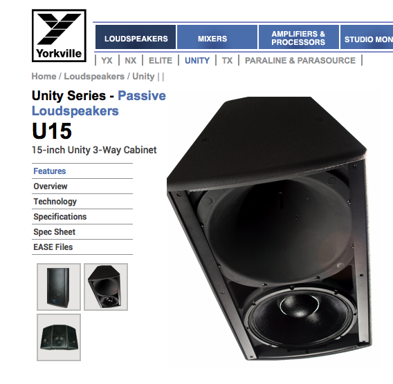

The Yorkville Unity line of speakers are a round version of offset midrange and central HF driver on one horn.I always wondered if a round version of the synergy horn would work. Or even a synergy with different horn profile. Things like the folded back mouth radius on a LeCleac'h horn etc.
By most all reports they work well, though not quite as well as the Synergy.
looks to me like the Unity with the crossover improvements in the Synergy is quite plainly the ideal platform for hifi. point source to the Shroeder after which it doesn't mean a damn thing anyway in a smaller room. so really, there it is. Again I will state, the sound of this speaker is the sound of these multiple midrange firing into those holes which are not at the apex of the horn. Again, show us that curve and you have shown us the sound of the speaker
