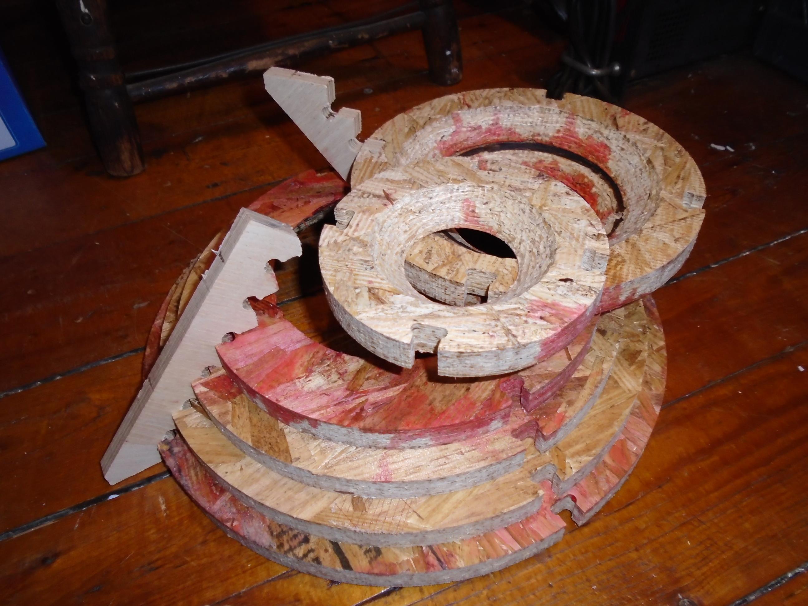

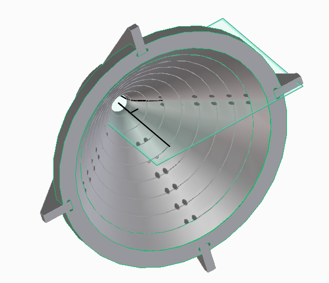

although I did a 1st pass trial cut OS waveguide shape with Shopbot CNC gantry router and waferboard subflooring since it was the cheapest material I could buy at Home Depot
still looking for a CAD/CAM SW chain that would let me clean up some issues before springing for Baltic birch
plenty of rez for "phase plug" for 4" cone mid drivers - but I'm not trying Synergy until I have a Summa style 2 way 1st
