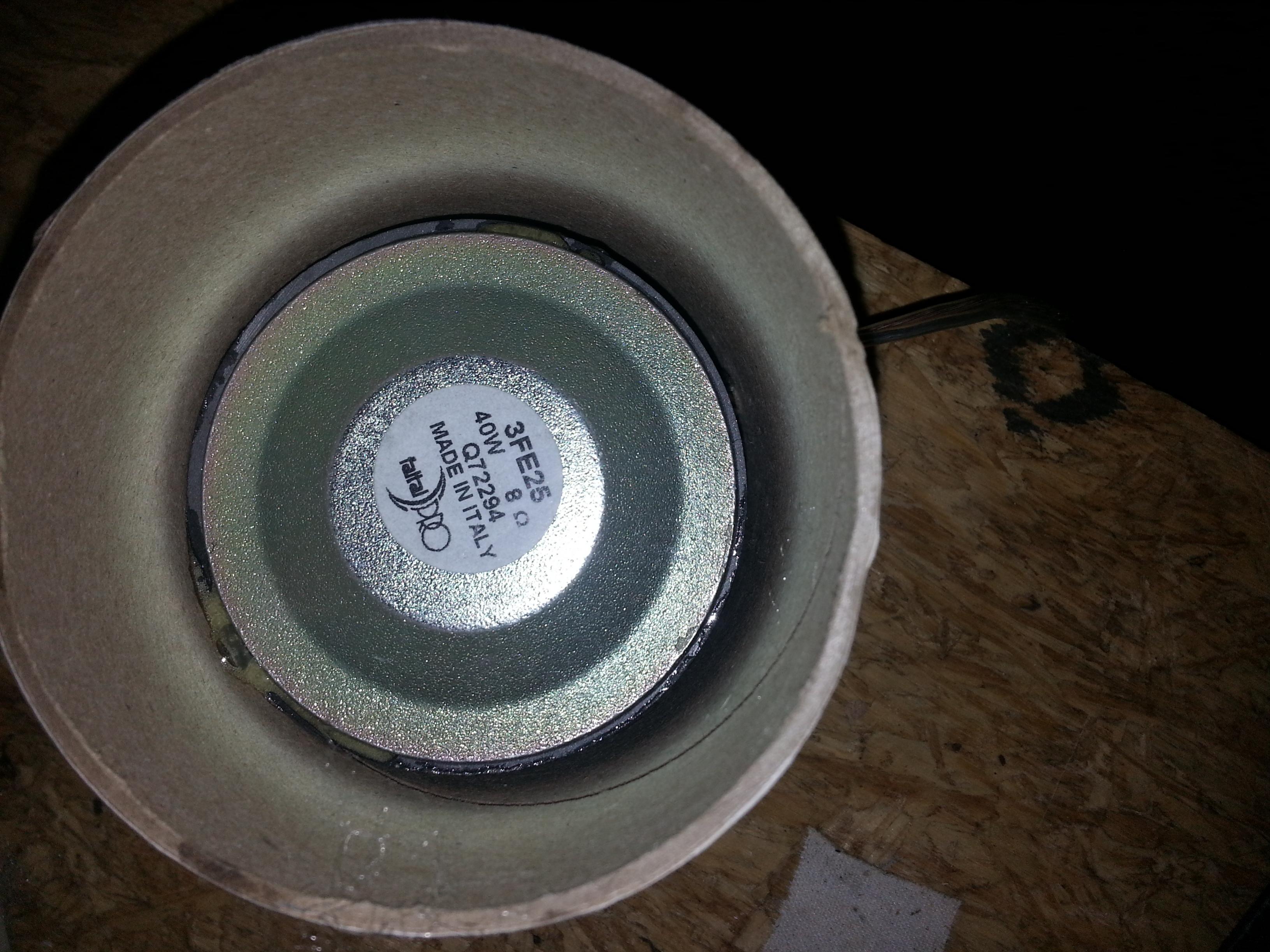

Photo shows how I measured.
Later I screwed that chamber down onto the horn but I couldn't get a good measurement as the garage was fully loaded and the weather precluded me emptying it out. It looked promising though with the mic all the way down the horn throat, like a clos mic.
That horn now has ~28 sq cm, .5" wide slots with round ends for mid ports. That is more than I need. I will fill it in partially with plumbers putty during next measurement process.

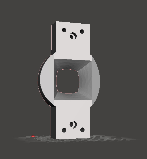

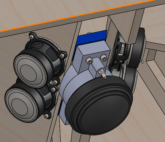

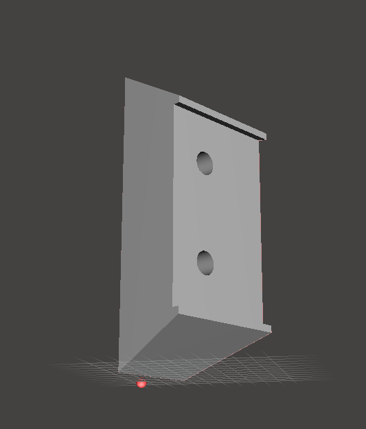

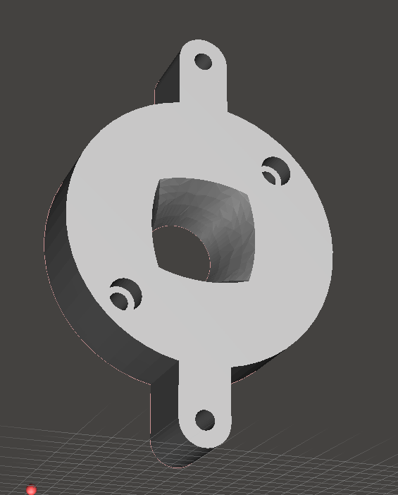

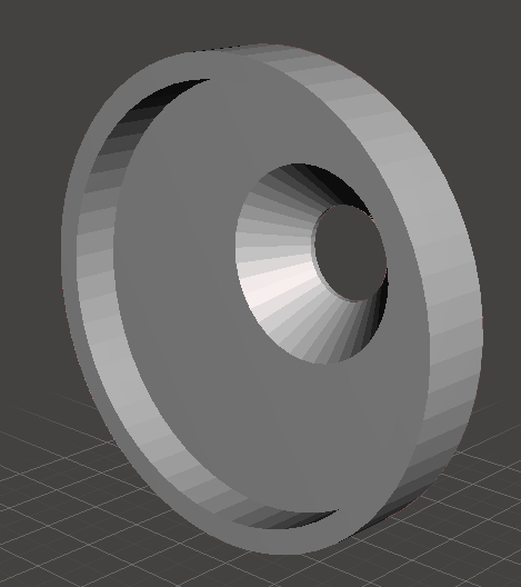

STL files if anybody wants to have a look / try to print, suggest improvements.
1) Mounting plate for CD, incl beginning of QTWG:
2) Rest of QTWG:
3) Mounting wedge:
Note: Part 3 needs 16mm MDF on a 60x60 horn, and I would expect some sanding etc to make it fit. It won´t fit with thicker materials, but with thinner it will work I suppose - it will just have one surface less to glue it on to. However, it´s a part that doesn´t have to be printed - just make sure you can mount the part 1 + part 2 assembly on the wood.
I have tried to avoid angled cuts as much as possible, so the adapter expects 30 degree angles on the sides. However, the top and bottom flares need to be cut at an angle.
And the midrange adapter. As simple as it is now, I suppose there is not much benefit to it - it doesn´t have much leeway on exit position, but at least it´s quick to swap it later if a more phase-plug-ish variant is needed. I think this part is the least simple to print too - so it might need to be redone unless I want to print this from shapeways or something.

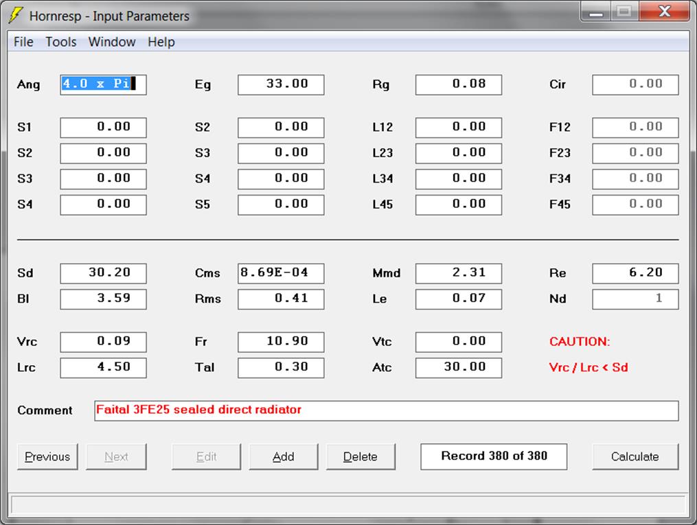

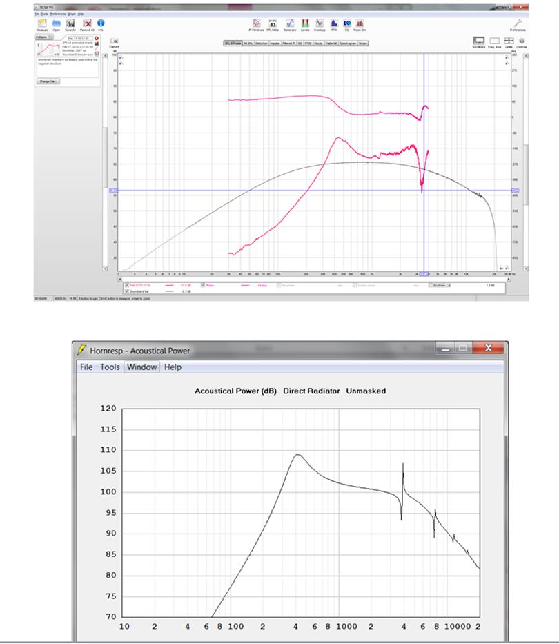

Nearfield measurement of 3FE25
My nearfield measurement of the 3FE25 in a minimum-volume mailing tube cap agrees closely with HR simulation of it as a direct radiator and shows it being good for crossover around 400 Hz.
First attachment compares simulated FR to measured, nearfield
2nd attachment is the simulation model

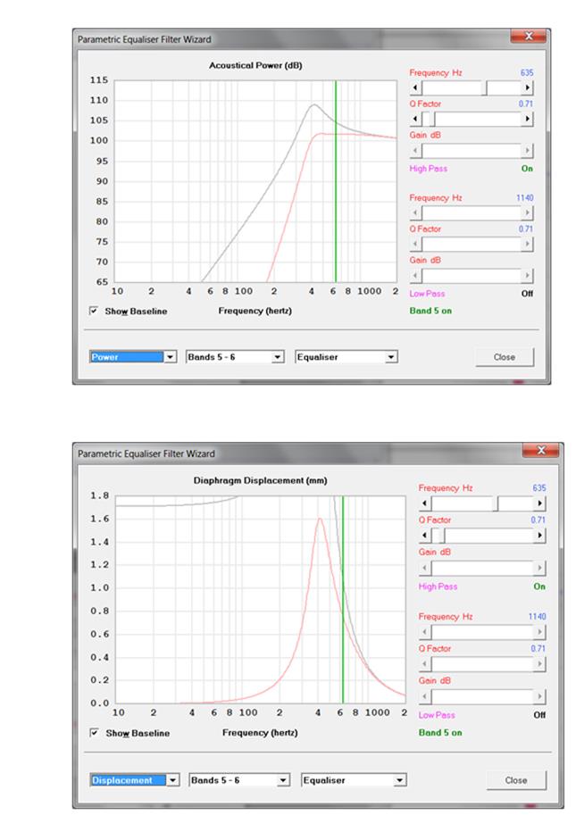

3rd attachment is the response with a 2nd order highpass at 635 hz which, due to the peak, makes it flat down to 400 Hz.
Jack

choked off mailing tube
If you want to use the 3FE25 lower than 400 Hz you need more chamber volume and, with an extended chamber, some issues arise. The mailing tube chamber is choked off by the magnet structure. Making the tube longer results in two chambers connected by a port consisting of the gap between the magnet and the tube wall. The measurements aren't pretty, I'll show some next post. They suggest to me to either work with the 400 hz crossover or print some kind of cap that extends out to the side away from the CD to get more volume.

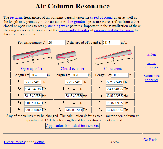

I started thinking perhaps this is relevant:
A tube is a pretty good resonator. But - it´s not really a tube anymore when most of the space is filled with something I suppose.

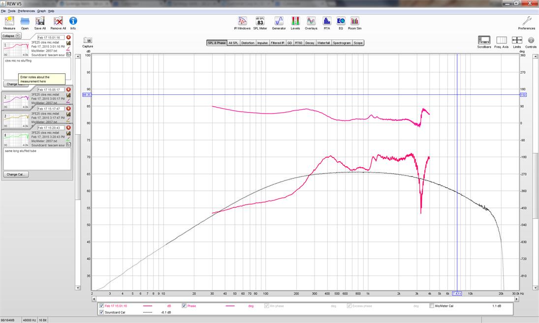

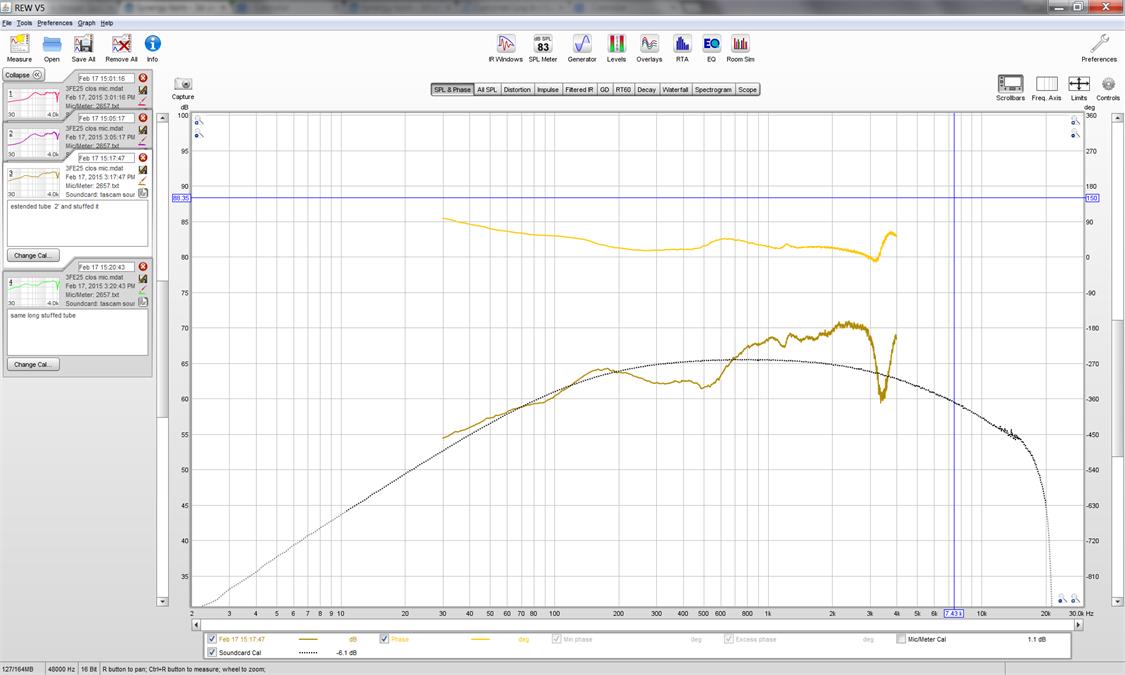

extended chamber measurements
The first attachment is a clos mic measurement with the 3.5" overall height tube sealed and unstuffed. The plug at the end is 1/2" thick so this leaves about 1.25" behind the magnet.
The second attachment is with the tube sealed into a 2' long pipe, fullyu stuffed with poly and unsealed at the bottom (but sitting on a surface so not really open either).
I haven't had much time to think about it so I'll not speculate about why this looks the way it does. This is what I got.

CM:
I was ahead of you on the stuffing, just didn't type fast enough. Let me add though that stuffing that small extension just behind the driver made very little difference. The long stuffed tube made a big difference. The problem is, I think, that if the space is too small then you can't get enough damping in it to kill the reflection/resonance.
I can measure a specific stuffed length tube if you want

Hi CM:
Different approach to the crossover to the woofer for the 3FE25
...instead of a highpass filter I just used a PEQ to flatten the peak at Fbox. Below the flattened peak is a perfect -12db per octave roll off with 6 db down at 300 hz. More like what you were looking for?
The same approach indicates I can cross over to 4FE35's as low as 250Hz with the minimum volume chambers. In both cases excursion stays under control because of the tight air spring. I think I may be ready to declare victory.
