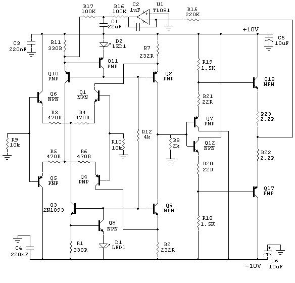

My constribution
Hello
I will also here post my Class A preamplifier schematic, with Non feedback, folded back cascode coupling.
I would ask If someone have ideas to optimize the component values, so I can lower distortion or make some sound improvement?
The PSU will be a look a like LCaudio Shunt reg with (PSU will later be +-20V) outputimpedance at 0.01R from DC to 400Khz.
About decoupling, what I decouple the outputstage with 10uF and inputstage with 220nF?
And what if I use a super jung regulator?
Best regards
Kim

thanks Kimschips.
I have been out of the industry for a few years but am preparing a comeback with a 150W Nch monoblock on spec.
I don't have a copy on hand and would need a schematic drawing pkg to generate it but it was a symmetrical FET input (2SK170/J74 Vgs matched) with complementary TR folded cascode LED biased and EF output in a x10 feedback loop with servo. Simple, nice bits and remote with motorised alps vol. The market loved it.
The amp that won with it started life as a no global feedback company design with comp bip front end, cascode Vas and MJ15003/4 - sounded awful. I tricked it up with comp FET front end applied global feedback and finessed the compensation for much better 20K THD. Absolutely transformed. 2x200W from memory.
regarding your design - I have a great pref for sym FET input with the balance R no CCS. I don't see the need for the 2 stage output. The loadings light enough. My opinion.
