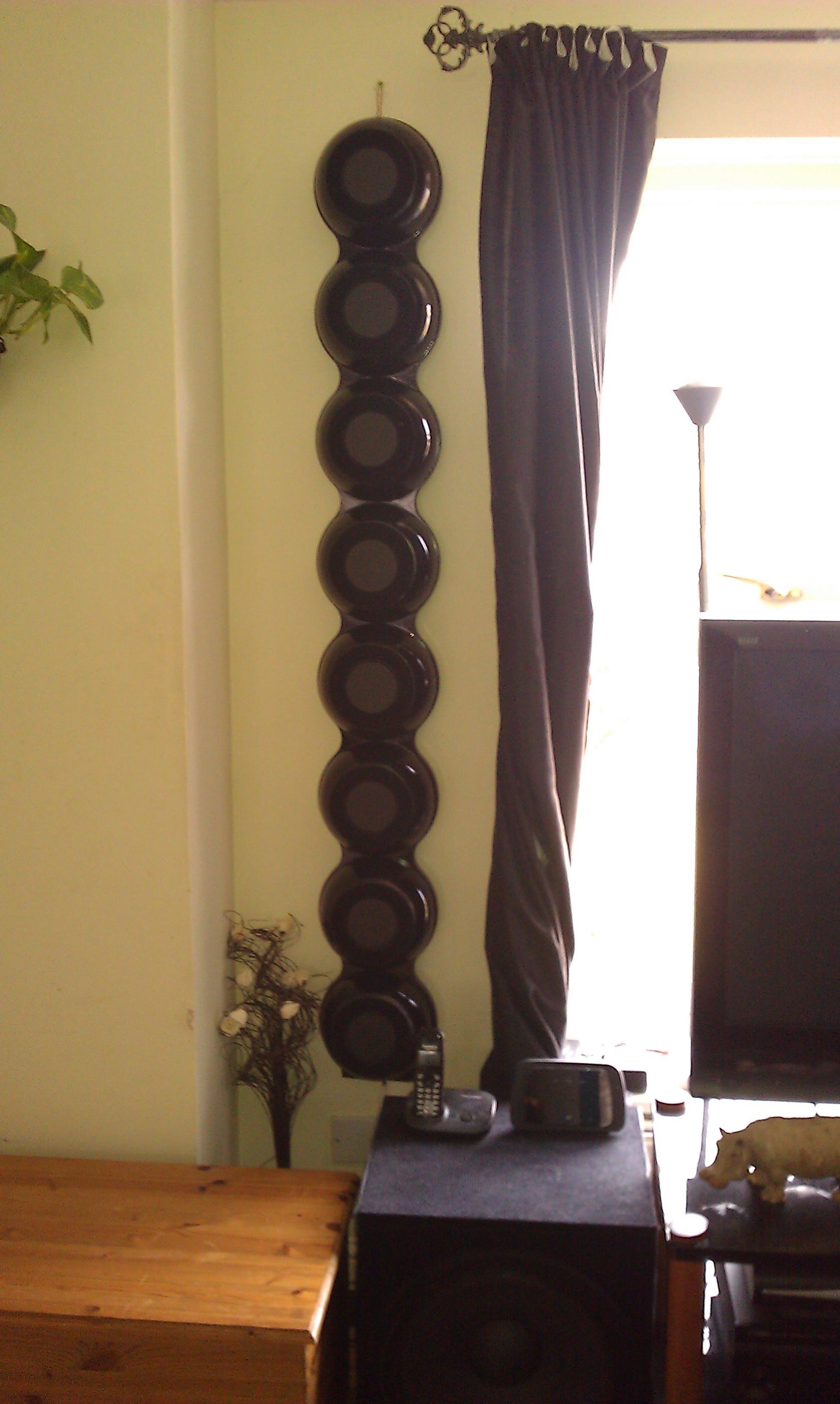

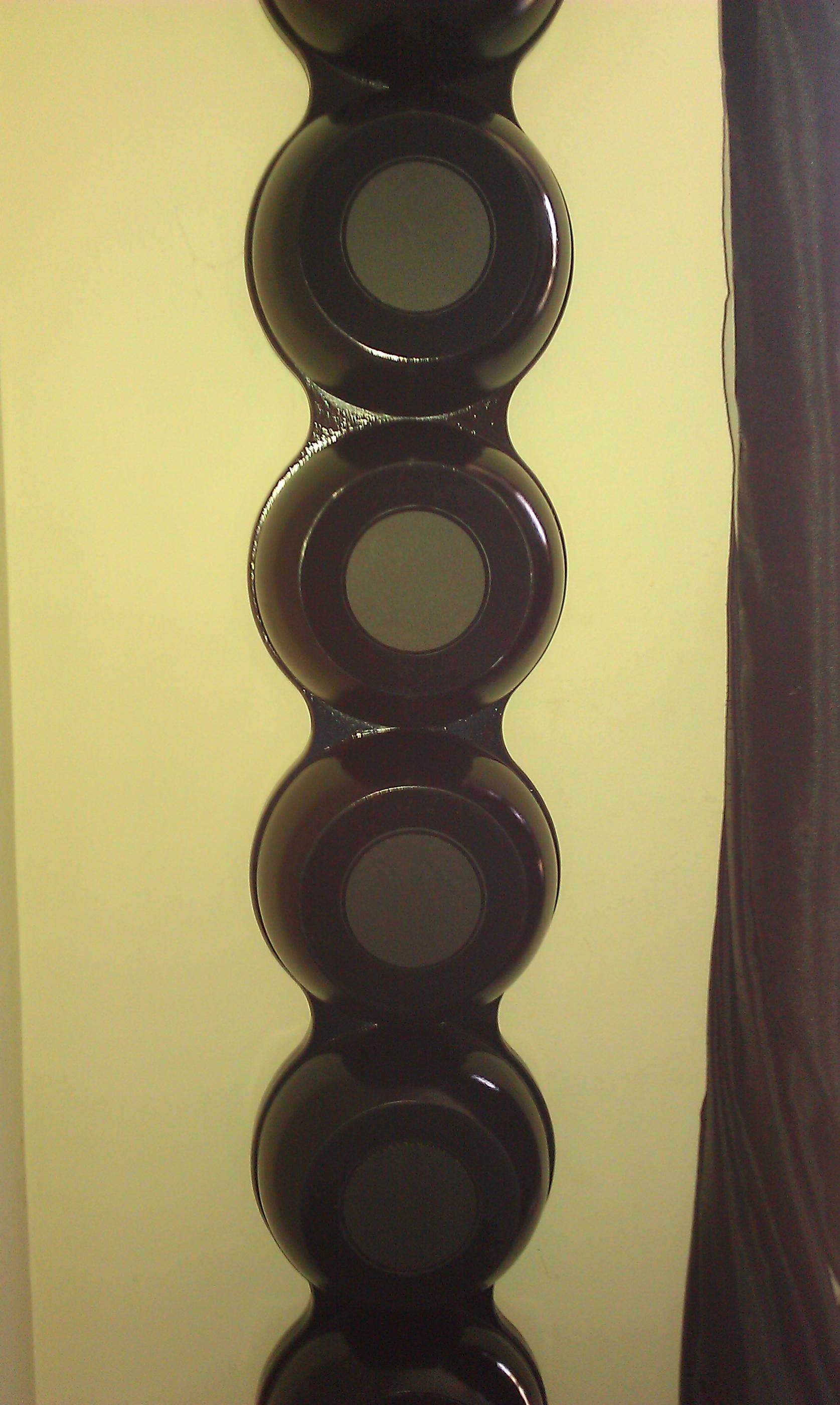

Attached is an 8 driver line array using 4 Ohm BMR's with 90dB @1 watt. Parallel 4 drivers for a 1 Ohm load and you get a 12dB ( theoretical) gain in sensitivity, I measure only 10dB to 11dB increase. Then series wire the two groups of four drivers for a 2 Ohm load. You now have reduced cone movement by a factor of 8 compared to a single driver. It gets even better moving to 16 drivers in a 4 Ohm configuration, same 101dB sensitivity but you reduce cone movement by another 50% and have an easier load for the amp (even SET's can cope with this!)

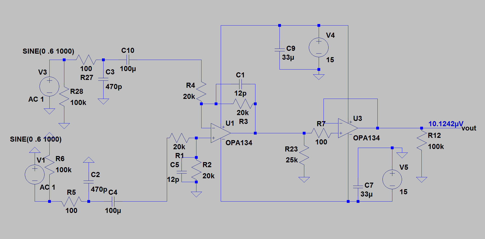

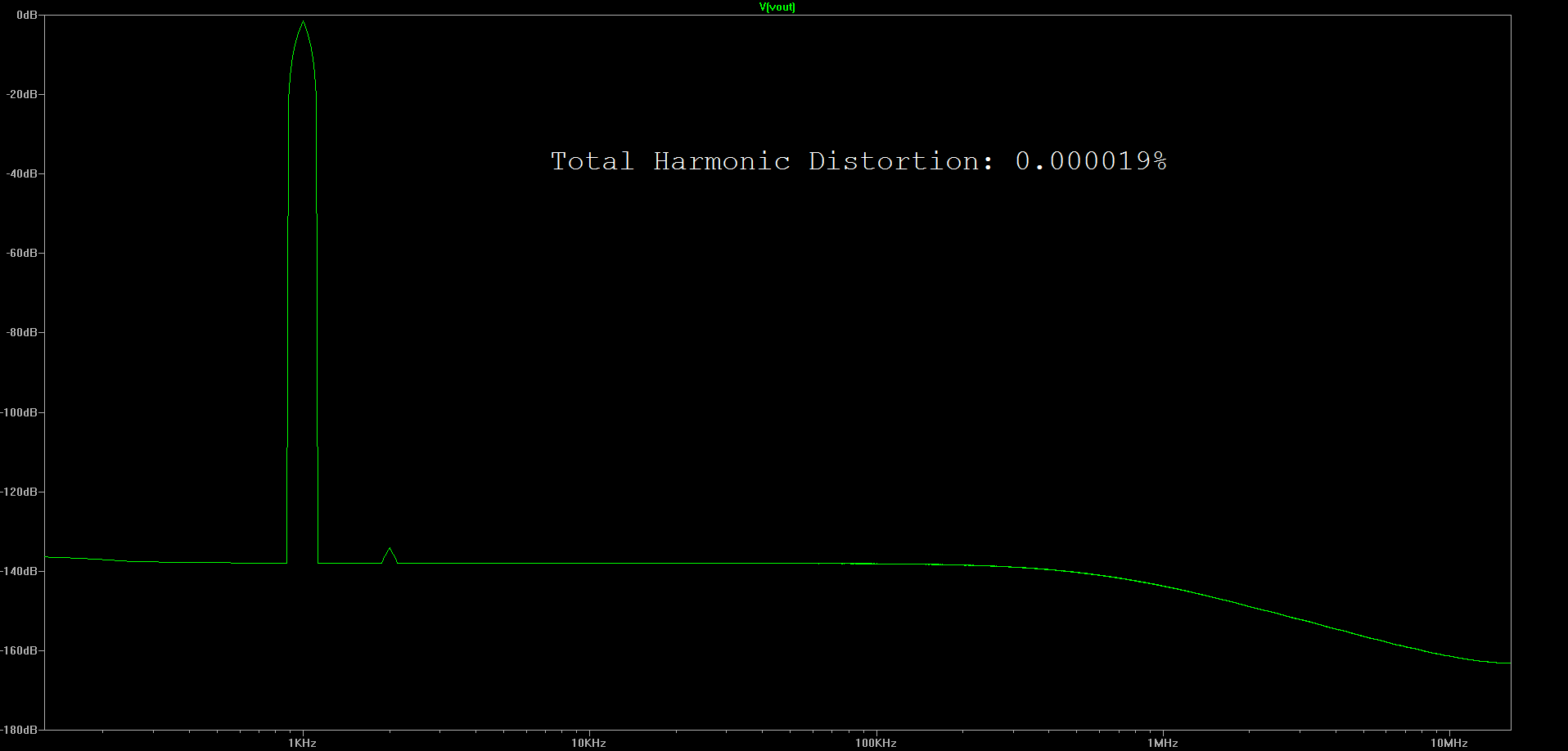

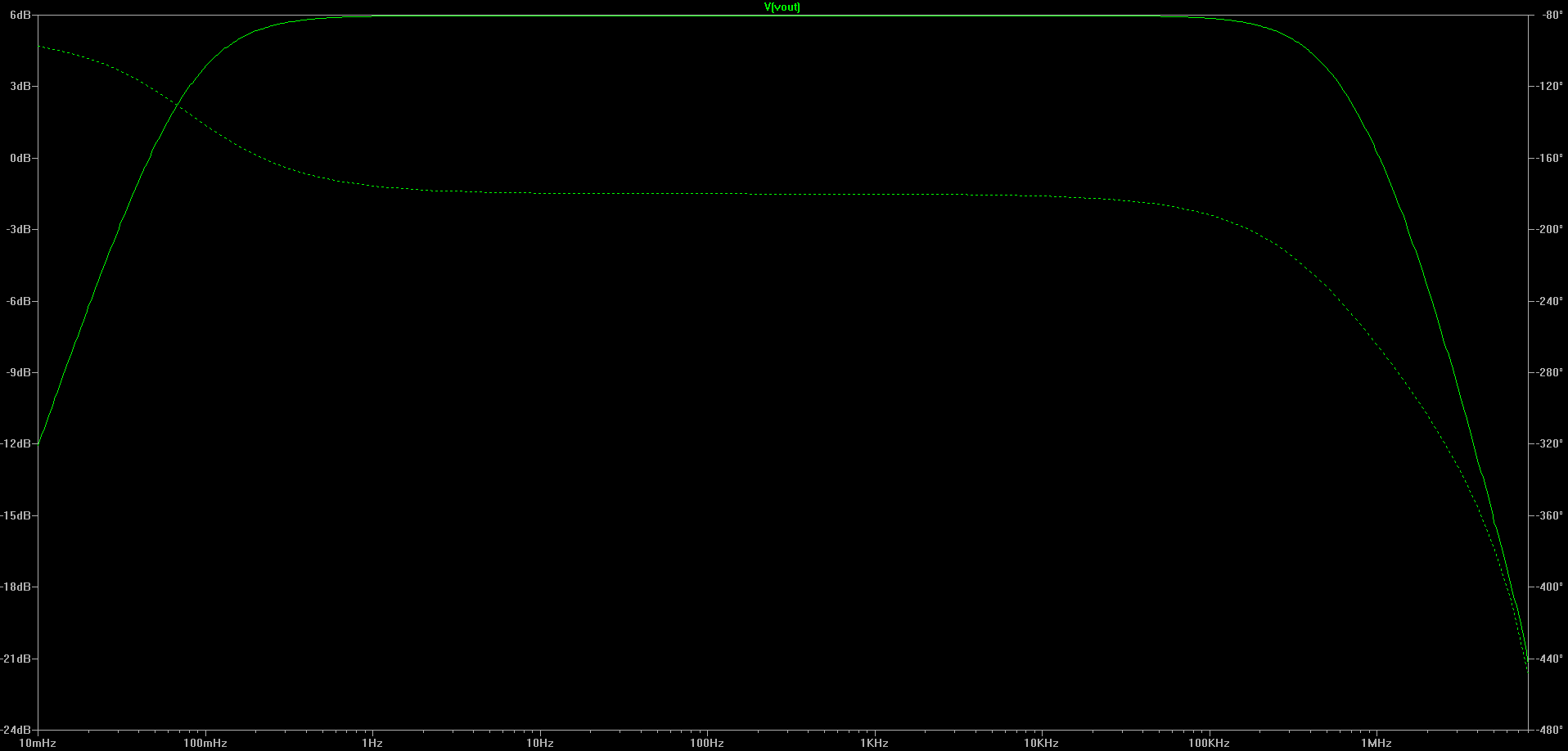

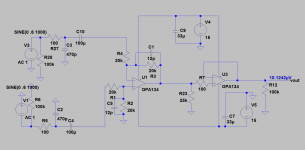

Hi Derek,
Were you thinking about something close to this ;) .
Run a higher line signal to get a better signal to noise ratio then use R23 as a potentiometer to create a balance between your active speakers and attenuate the line signal to the right level :D
