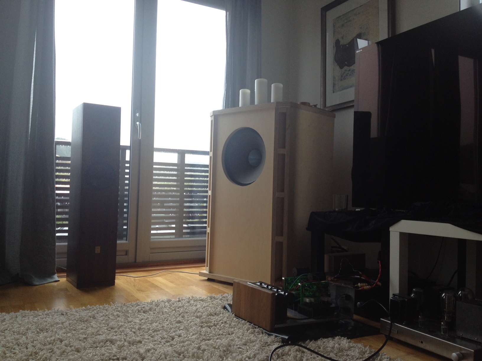

Hi all..
The preamp is silent.. Had Oris horns earlier (108dB senitive) and dead silence when not playing..
What was kind of funny was that I could play on those horns directly from the preamp..
And I am using separate wall receptacles for the Symef.. Reason: the 10A fuse blew when turning on the amp.. Had to use a wall receptacle that had 16A.
The rest of the components are actually fed from an online UPS..
I have also lowered the output from the dac...
However - i Changed from RC to CRC in the psu just now.
Bridge rectifier - 2200uf - 7.5ohm (100w resistor) - 36000uf
Output - 40.5vdc.
Had 35 Vdc with just RC..

I now use a pair speakers with approx 89-90dB sensitivity for testing purposes. The hum is audible from about 30cm away from the speakers. Not so bad. This might be because of cable mess
I tried to lower R28 from 22k to 7k to reduce the gain. It helped some but not much. I am back to 22k right now.

Yeah, its always better to check the bias after the voltage changes. My heatsinks are also quite hot, I am thinking of getting bigger ones, with 100mA quiescent current through each output transistor the heatsinks need to dissipate 16W at the idle so I believe your heatsinks are bit under rated for this amp.
Bambadoo, it looks like you modeled your speakers on the Tannoy GRF, which is very efficient design and could be the reason for the amp/pre-amp combination to have too much gain. Obviously you do not want to mess with the pre-amp because it cost you a pack of money so messing with your new power amp is the only alternative.
What you have done is to change the NFB series resistor (22k) to a lower value, don't change the series resistor because you are messing with the amp off-set which could also affect the bias. Rather increase the value of the shunt resistor (to say 3.3k).
Increasing the shunt resistor also offers the opportunity to decrease the capacitor value from 2200uF to much less as it is not necessary to have high near DC gain because it also leads to instability.

If I were you I would undo one side of R2 from the PCB and wire a 10K potentiometer between R2 flying lead and the PCB. Turn the pot to max. Then adjust your pre-amp to say 3/4 gain and slowly adjust the 10K pot until you are comfortable that you are reaching the SPL levels that you require.
Remove the pot, measure the resistance, add 750 ohms and choose the closest value resistor that you have handy into both channels, as simple as that. Choose a capacitor for C1 that is close to 1/(40 x Pi x R2)
