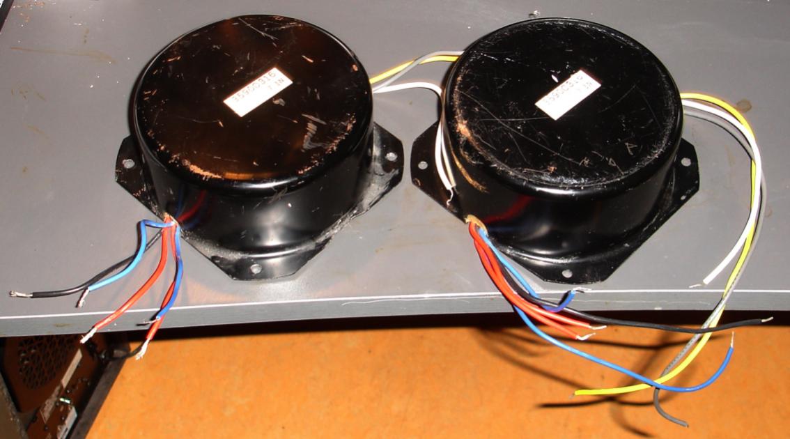

Would it be problematic if I'd use a 44VAC transformer (so around 60VDC) in the power supply?
Thank you. +/- 60 VDC is too high, safely +/- 40 VDC , max +/- 50 VDC
Parts for the PCBs are on order. Unfortunately the diodes (D5,6) and one of the outputs (Q4) are on back order until late Feb. Need to get the PSU stuff together now. Not real clear on just what I am going to do here tho...
Nice going Billy, you can try two PSU s
1. The one on the site
2. http://www.diyaudio.com/forums/power-supplies/216409-power-supply-resevoir-size-169.html#post3309702 (Thats if you like to experiment )
All right, thanks, I don't want to blow up my nice new amplifier.Thank you. +/- 60 VDC is too high, safely +/- 40 VDC , max +/- 50 VDC
