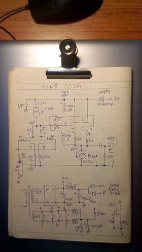

Care to share your schematic of the one you made with depletion mosfets? I would like to build it and then A/B it with my 6SN7/6SN7 Aikido and see what sounds better to my ears.

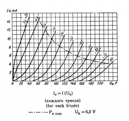

Pretty neat. I bet it would measure pretty well, especially with a nice linear tube like the 6SN7 or similar. Gain would be pretty much equal to the mu of the tube used.
I have a few 6N16B I should try it with, they are a very linear little tube, and it would only take one bottle per channel, for a very compact little preamp indeed
200 volt supply voltage, 100 volts across the tube, ~6mA or so, -2 volts grid looks easy and linear.
Gain would be ~22x or so, might be a good fit for something like a Pass F4 or similar power buffer.

there was a group buy for IXYS 1A depletion mosfets here years ago...
schematics? just replace the tube triodes in the first stage plate load and cathode follower with the depletion mosfets set to 15mA each... and there you have it...

way i see it, greatest plate swing is with a 4mA CCS plate load and 100 v plate and -2.5v grid bias....cathode resistor then is about 620 ohms...
If you could post a schematic it would be helpful. Thanks.
this is all i got....the rest are in my head...
