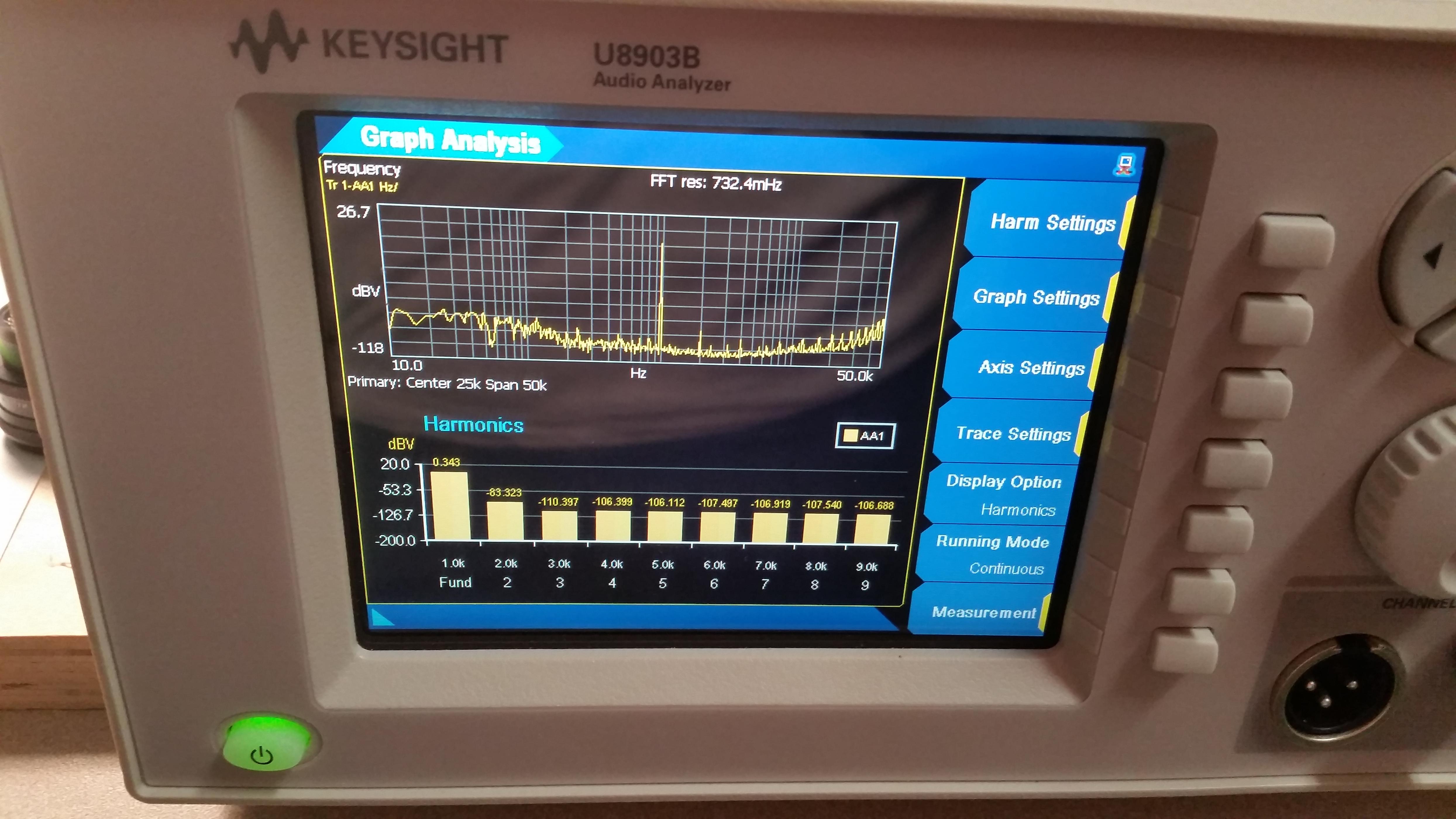

I ran the FFT again with 5uf capacitor, same results
Popilin and All,
We have been out and about this afternoon.

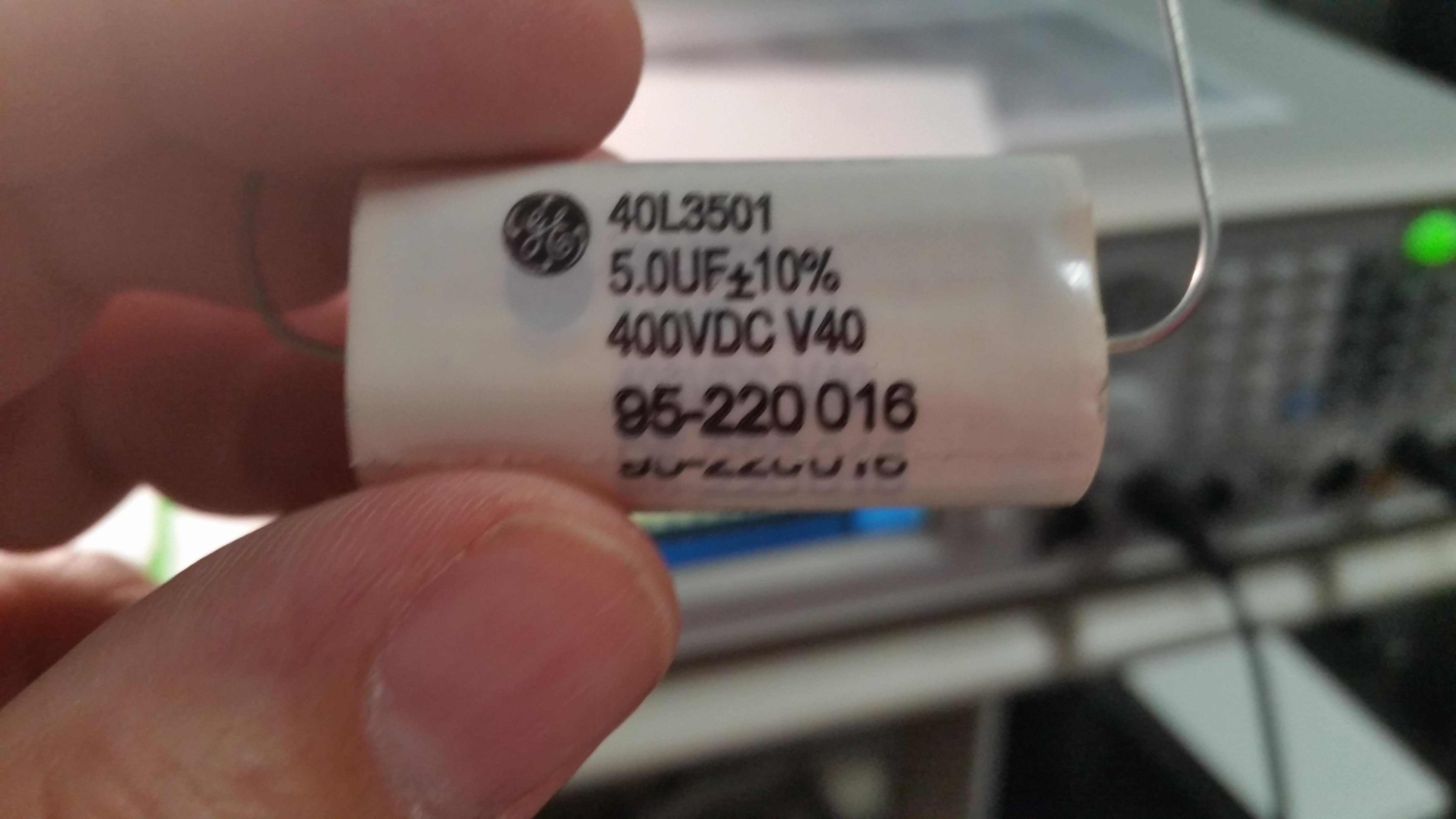

I just replaced the 0.68uf capacitor with a 5uf capacitor also GE.
I ran the FFT again, same results. The adjustable resistor was untouched.

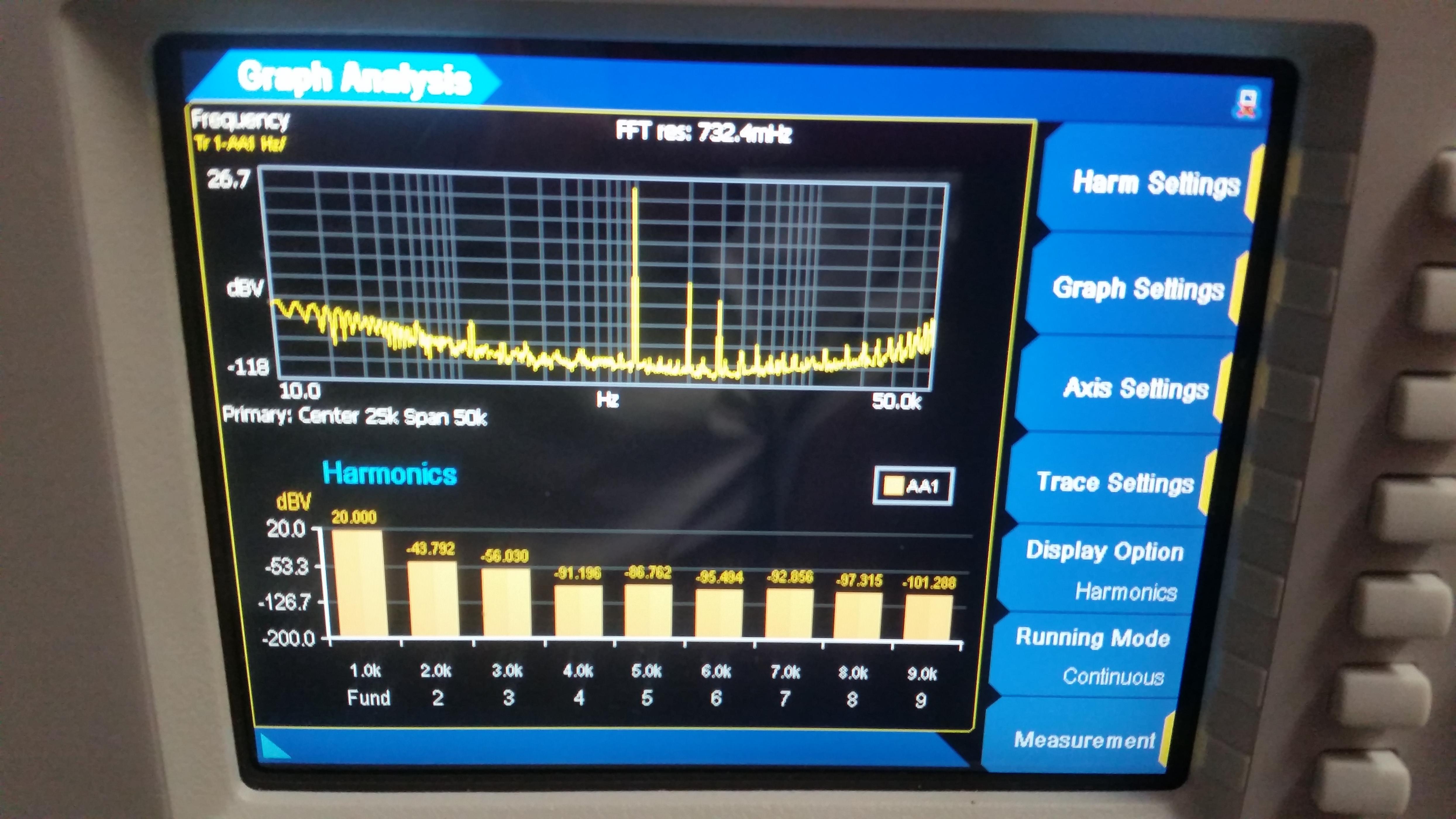

Here are distortion figures for 12au7a and 6dj8, they are very close under same load and ac current, 6dj8 could sound brighter judging from higher level of higher order harmonics, 7th, 9th for instance.
the 7th, 9th are bad news...
That is just a simulation, and if you look carefully the SRPP is not optimized, the circuit was just optimized for the ECC82 Koren model, with other models as 12AU7A and 6DJ8 results are totally different.
Anyway, 7th and 9th below -140dB for 10VRMS output does not seem too much, isn't it?
