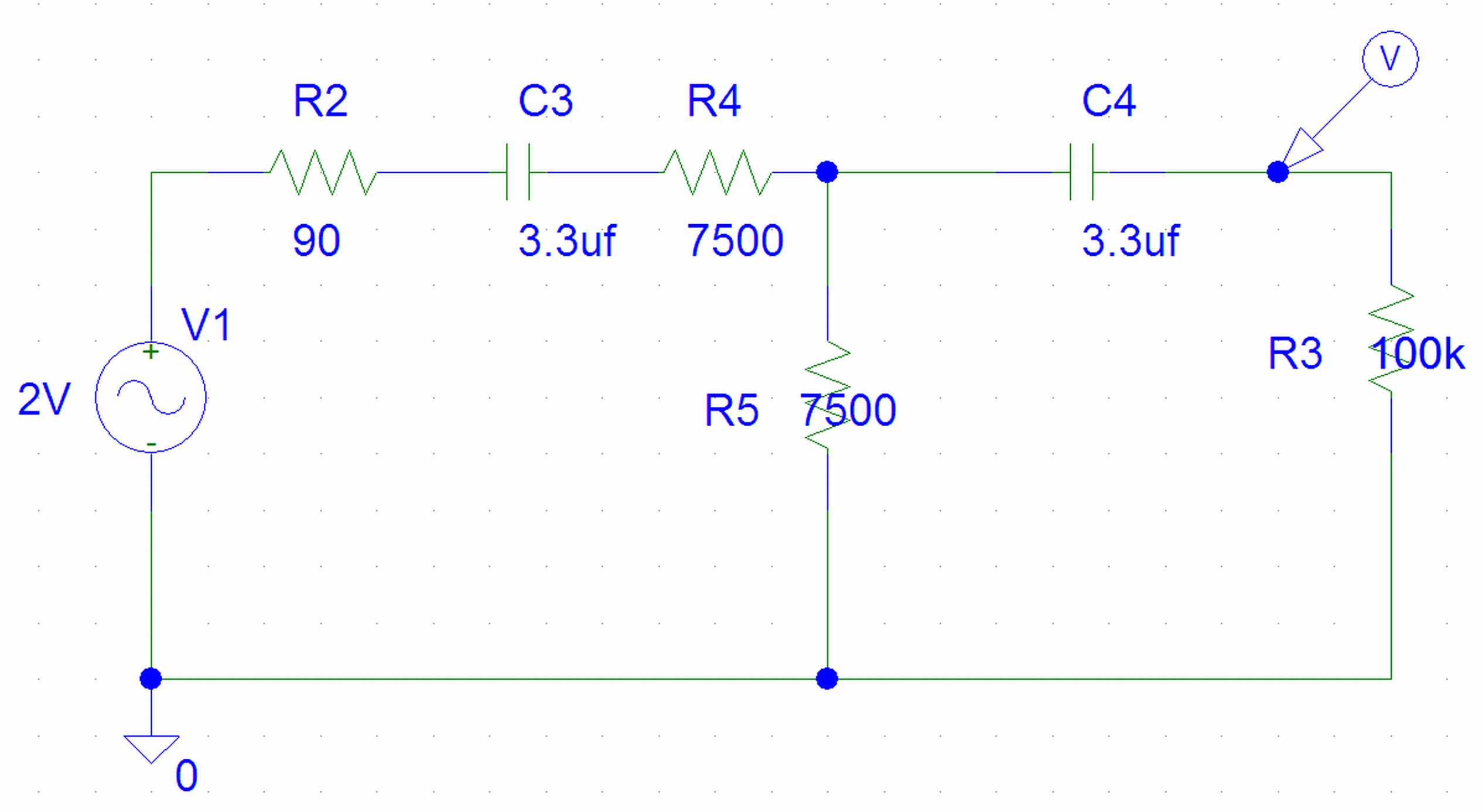

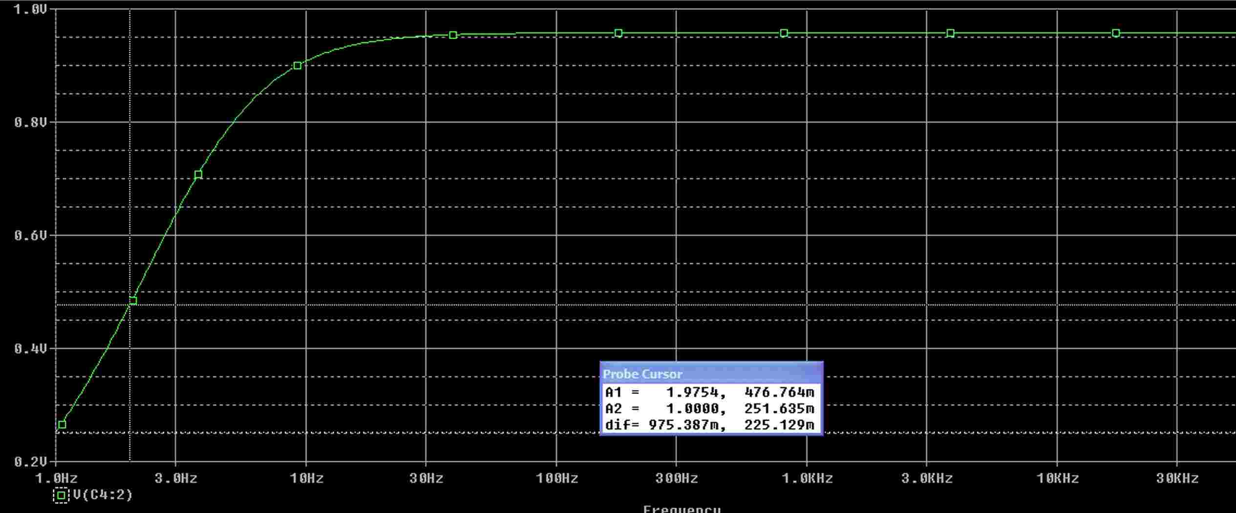

On many outputs with caps in series I have found a down side that a passive pre (attenuator/pot) forms a highpass filter quite quickly, effectively removing the lower end of the response. Have you experienced this?
I mean with say 3.3uF output caps and 15K in parallel you are well in the audio band...
F6 2Hz
Looks like the F6 of the roll off of the interactions of the two passive stages with the amp would be about 2Hz. Still pretty acceptable. I have tried many opamps and many different schemes including active bias class A FEToutput buffers following an opamp input and gain stage. Passive direct out through caps with no filter for the dac and passive attenuators at the amp's input sound the most transparent and detailed.On many outputs with caps in series I have found a down side that a passive pre (attenuator/pot) forms a highpass filter quite quickly, effectively removing the lower end of the response. Have you experienced this?
Well in spice sims often look different than in practise. The real truth is measuring what happens with a test tone. I don't know exactly what caused these non linearities, but with a buffer stage followed by the attenuator the problems didn't occur. With the attenuator directly on the source and especially at the lower end of the scale the response dropped quite a bit at the lower end.... Probably something parasitic I overlooked, hence the discrepancy with the spice sim....
