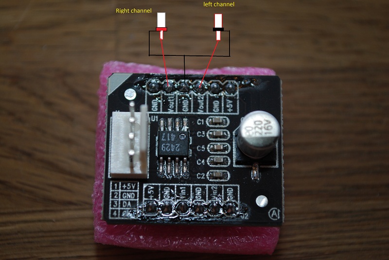

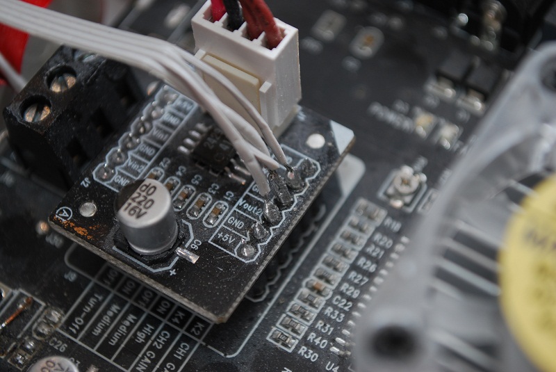

I'm using the new upgraded version with a rotary encoder volume board. Now I would like to y-split the signal for each channel after the volume control. The purpose of this is to fed an active sub.
I have attached the wires as pictures shows.
If I connect only right channel to sub everything is fine but if I connect both channels, or left channel alone, a wining sound appears and voice coil on the test speaker literally burn up.
Obviously I have done something wrong but the question is what?
Attaching pics of wiring.
Regards Håkan

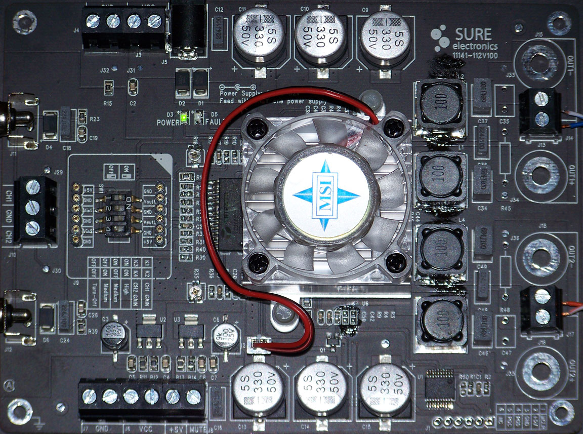

Microcontroller on the Sure 2X100W?
I just bought a new Sure 2X100W TK2050 amp from Parts Express. It has some interesting differences from the original Sure TK2050s I bought on ebay (the one without a fan).
The new board is the same width, but is longer. The extra length provides room for the rotary encoder volume control add-on Sure sells on its website.
There's a second 5v voltage regulator, most likely for the fan, which is thermal activated, so it is off and silent unless you're pushing things hard.
The extra length also gives more room around the output coils (making them easier to swap out). In this space on one side is a microcontroller (!), a PIC16F690. There's a space for a 6-pin jack and four resistors. Does anyone have any idea what these are for?
Finally, while the components are in approximately the same places (except the stuff on the back has been moved to the front), the layout of the traces is different and some the components are numbered differently. So some of the mods in this thread may not work as described (and may damage the board).
BTW, the new board sounds just great, even before any mods.

Hi there,
I've just recieved mine, will do the main mods on this board, comparing layout on the earlier and latest manuals. I'll report if I fry something... as soon as my board sing! Power supply at 31.5V DC, DC offset fine, source OK, works nicely on my TA2025 but no sound from that big Sure :'( I hope it's a "oh that was just that" like a solder blob or such...
Mine did the same thing. In fact, I sent the first one back. When the second one was the same, I thought, maybe I'm missing something here.
For reasons I can't fathom, the new amp is shipped with the four little tiny switches turned off. In this configuration, no sound comes out. Flip them on and everything will be fine.
These four little switches set the gain for the amp, two for each channel. In the earlier versions of the amp, sound came out in every configuration. In the new board, if both switches are off for a channel, the channel is silent.
Also, the manual is for the first version of the amp, so the layout and schematics do not necessarily match your board. You'll have no trouble swapping caps and coils, but be careful if you are cutting traces.
