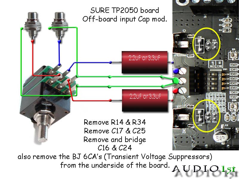

The text in the drawing is not quite right. If you bridge the stock cap and use your new cap in a different location than the stock one, such as on the way from a case mounted rca to the board, you must remove the input resistor or else you will be shorting the 2.5v dc bias that sets the output offset trim. You may install a different input terminating resistor before the cap or just leave it out. My dac sounded better with a 20k terminating resistor.
Thank you Teamacc & Scott for responding.

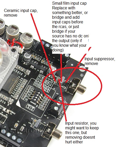

I've attached the mod of the orginal board that I'm trying to achive. I will be using an Alps 50k Blue Velvet pot and 2.2uF Auricaps. I'm using these componets because I have them on hand. Since I have 5 of these new Sure boards I probably will be using different componets for the others. Any recommendations are welcomed.
So what I'm hearing is that I will:
1. Remove ceramic input cap.
2. Bridge small film input cap.
3. Remove input suppressor.
4. Remove input resistor.
Does this sound correct?

Excellent. Thanks.
Now with this setup and new Wurths, would it be best to put a Zobel in? If so, what value?
I can perform the mods, but I don't have a good understanding of the relationships between the components. So thank you for setting me straight.

I use a small Zobel. 15R and .47uf.
