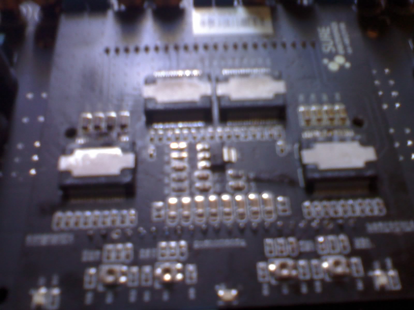

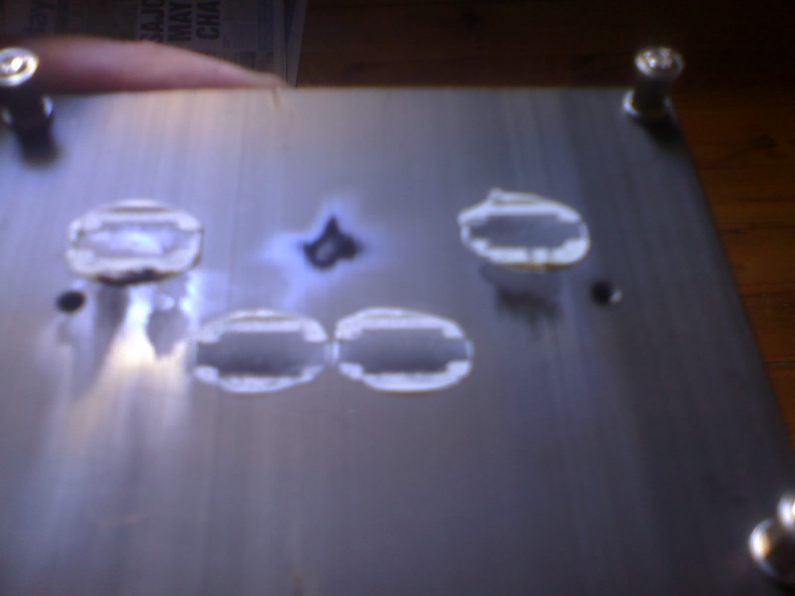

Hi, please see the attached two pics.
Taking note of the heatsink photo you can clearly see that three components have suffered heat failure. These are the TP2050 chips for channels 1 and 4 and the regulater chip. The question is what went first and why? Note also that more than sufficient heat transfer paste has been applied.
The second photo is out of focus but look at the left most chip. It is the TP2050 chip for channel 1. Notice that around 1/3 of the chips heat conductive surface was not touching the heatsink.
Now, my (still working at it) hypothesis is this.
At manufacture the daughter board is fixed to the main board and the header pins connecting the two are soldered. It is now solidly fixed in place.
Next a good amount of heat transfer paste is applied to all four chips and the heatsink is bolted on. In some boards the heatsink is bolted with sufficient force to cause the boards to flex. This is caused by the header pins being soldered in a minute fraction such that they are just a little tiny bit too high. The main board on mine was flexed enough to bow the main board my several mm. This force is enough to cause channel 1 TP2050 to come away from the heatsink by a tiny amount. This is enough to cause the chip to loose 1/3 of it's heat transfer area.
To make the problem worse, the TC2000 chips are located under channels 1 and 4 TP2050 chips adding to the heat problem. The heat builds and at some stage a catostrophic failure occurs taking the other chips with it. Both TP2050 chips for channels 1 and 4 are under increased heat load due to the location of the TP2000 chips which, being sandwiched between the two boards, has no chance whatsoever to dissipate any heat at all. The heat just builds until failure.
A solution would be three fold.
Redesign the daughter board such that the two TC2000 chips have some air circulation so they can dissipate heat.
Fix the heatsink to the daughter board before soldering the header pins to the main board.
Provide two more central fixing point for the heatsink to avoid the flex problems.
Any comments are welcome, please.

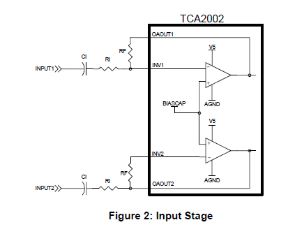

post 69: is input 2 connected to the correct end of Rf?
No... looks like the image was mirrored but not the opamp.....
You are probably right Andrew, but it is taken straight from the Tripath App sheet..
Input 2, Ri should connect to INV2..
